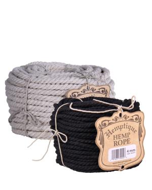

Yes! I've been monitoring this development myself. There's a lot of new products coming on the market, apparently driven by the "environmentally hyper-conscious," for want of a better term. Most of this thread is hemp, although there is some promising looking linen coming on the market as well. It doesn't really matter if it's hemp or linen, since the two fibers are virtually indistinguishable. Hemp is slightly longer fibered than linen, as I recall, which is why it was favored for rope. Linen was a little softer, which is why it was favored for cloth weaving. I've read it takes a scientist and a microscope to tell the two apart.
One company offering waxed and unwaxed hemp and linen line (and even rope) is Hemptique. I don't know whether it's of a size and quality we require for ship modeling. If it's suitable, I hope somebody lets us know! A lot of it looks rather "nubby," and I have no idea of their size or color ranges, really. It would be nice to have a source of linen or hemp for restoration work on older models, if nothing else, but as for new construction, it almost seems like we can't put the toothpaste back in the tube when it comes to natural or synthetic materials. The modern polyester threads do seem to have handily triumphed over the natural fiber threads at this point. I certainly have a hard time telling the difference between the two and I'll trust the scientists as to the longevity of each, which is pretty good either way.
See: https://hemptique.com/
