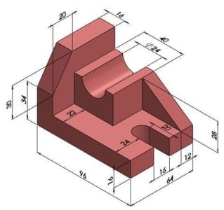

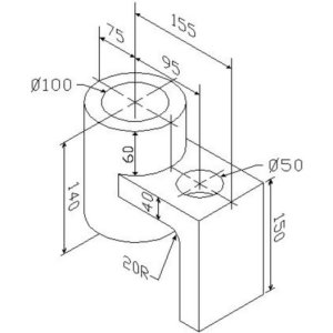

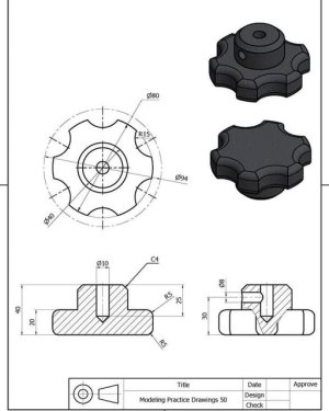

I forgot to mention this tip to anyone starting out using any type of CAD program.
You can use a saltshaker or a dice or anything else with a simple shape that is easy to measure/model lying around the house to get started.
(Digital calipers are a must when starting out; they're super-cheap and you'll reach for them more often that you can imagine when modeling to obtain accurate measurements and verify your printed part's tolerances.)
Using just a few simple tools, like Revolve/Lathe/Spin (same command, different software) and Boolean Subtract, to create your model. Time how long it takes on the first try.
When you succeed, wait a half-hour and model it again, noting the build time. Do this again and again, recording how much time you save. The second time should be close to 75%, and keep at it until you can build it in half the original time of the first day.
The next day, repeat the feat until you can create the shape in 25% of the original time. This is the first step to creating a repeatable workflow using muscle memory and experience. Your new-found confidence in your skills will make a big motivational difference!
Whether it takes two, four, or ten hours on the first try, it doesn't matter. All you need is a starting reference to gauge your progress.
When you reach the 25% point, move to something else slightly more advanced, using another tool like, Extrude.
Simple shapes and drawings like these are very useful for building your confidence and speeding up your workflow too!
Shapes like the Knob depicted below, are best modeled using the origin of your workspace.
CC
