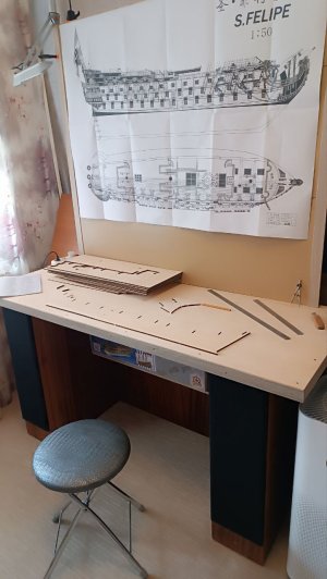

I ordered a kit from China through a Russian marketplace. It cost 185 dollars with delivery at the current exchange rate. They were delivered to our Upper Volga region quite quickly, in a little less than a month. Immediately, I purchased pink pear and sapele boards for the exterior cladding, as well as a white pear for the deck, which cost me another $70.

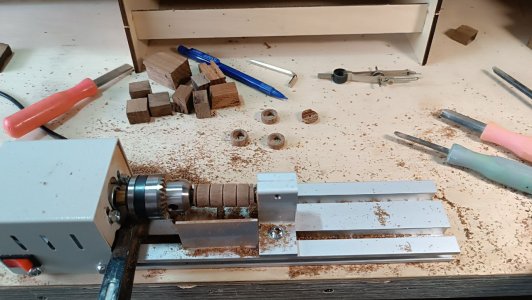

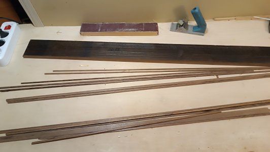

For the barkhouts, I sawed dark walnut planks from my reserves.
I have experience building models from scratch, not from kits. Such instructions turned out to be of little use to me, especially since they were very schematic and in Chinese. The drawing served as a kind of "bible for assembly.And, of course, I had to prepare a new workbench first; I had never built sailboat models of this scale before. The frame was assembled with almost no hitches, but we had to raise the beam line at the stern a little; the Chinese made a small mistake in some details, which greatly affects the design of the stern galleries.

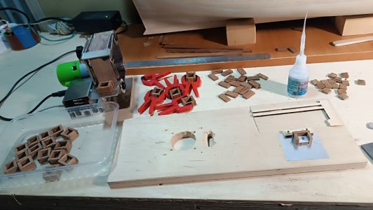

I also made linden bosses for the bow and filled the deck with linden slats for installing half-pillows, and painted everything black.
There were no problems with the roughing. However, I still haven't decided on the type of wood. It's a pity that it's not a lime tree, but unlike us, there doesn't seem to be much of it in China. The material that came in the kit is a bit fragile, but it's easy to work with — the main thing is not to sand it to holes.But before proceeding with the black plating, it is necessary to install the finishing trim and doors on both bulkheads. Otherwise, you won't be able to get to them later.

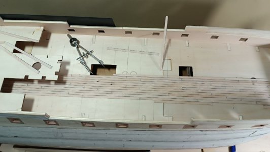

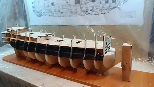

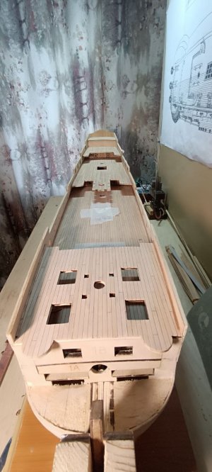

Then I started laying the deck deck, but before that I marked out a place in the hull for gun ports and slats. I took all the dimensions from the drawing; the template from the set was not used, as it slightly does not match the original.
I also pre-installed the gun port racks on the upper deck.

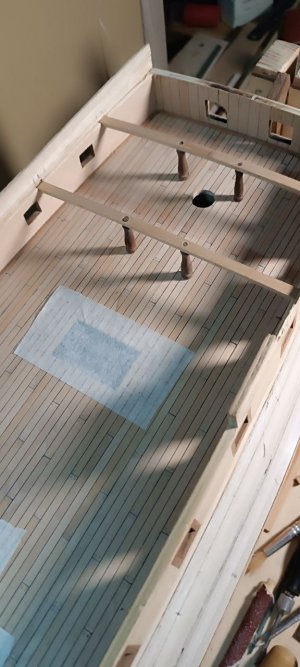

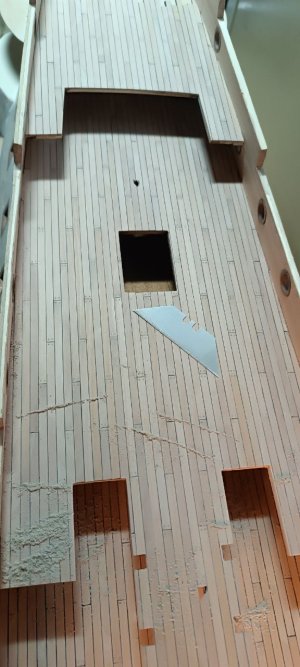

For the flooring, I used light pear planks with a thickness of 1 mm and a length of 4 mm. The length of the board was 100 mm, although 120 mm would be more accurate. I laid them in three boards with a pitch of 25 mm. I pre-modeled the sheets and unpacked the joints, and then laid them. Birch toothpicks were used as dowels, and thin black drawing paper was used for joints.
фото_2025-10-08_07-44-00 (2).jpgфото_2025-10-08_07-44-00.jpgфото_2025-10-08_07-43-59.jpg

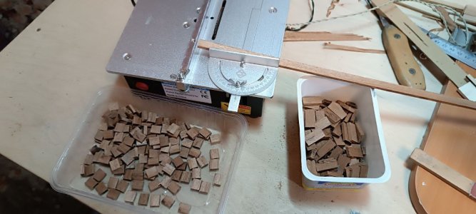

No problem understanding you at all. That's a great looking ship and you seem very skilled and well-equipped.

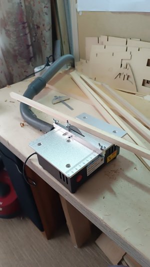

I also love that mini-machinery. May I ask what table saw that is?
Richard
The saw, as well as the lathe, and the grinder are made in China. They are inexpensive, each machine at our rate is about 15-20 dollars. They are quite simple, but they do their job well, but they certainly won't be hindered by some improvements. Specifically for this saw. The collector motor is 95 watts. Transmission from shaft to disc by means of a toothed belt. The set includes several saw blades for wood, plastic and metal, with a diameter of 63 mm. The worktable is adjustable in height. The maximum cutting depth is 14 mm. The kit includes an adjustable power supply unit with a maximum voltage of 24 volts.
The Chinese also include a set of socket wrenches to replace the saw blades. The saw can be disassembled quickly and conveniently . There is a marking in millimeters on the desktop, there is also a feeding guide with a protractor, a groove is milled in the desktop for it. It is convenient to end the slats at any angle. The only drawback is the guide rail, which is mounted with flaps, it probably needs to be improved. But in principle, I'm quite happy with this saw.

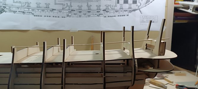

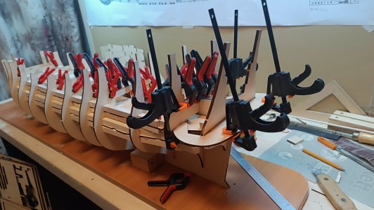

I will continue the review on the construction of the "Spaniard". The keel frame itself in the set is made of 5mm plywood, but according to the drawing, the keel, stem, and bottom should be 8mm. I sheathed them with 1.5 mm mahogany plywood, getting the desired result. A 1 mm wide groove was provided for the trim strips.

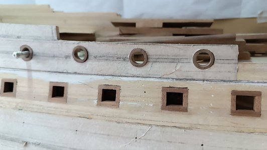

Before starting the finishing work, it is necessary, of course, to install gun ports for all decks.
For cutting holes, I recommend these Japanese saws. They are very thin, elastic and flexible at the same time, perfectly sharpened and do not blunt quickly. In a box of three pieces, in oil, on a foam backing. It cost me six dollars.

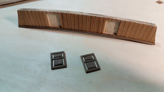

Some work is also needed on the transom of the model and on the aft galleries.photo_2025-10-20_20-29-31 (2).jpg
I didn't really like the windows made of thin plywood included in the package, but I used them as conductors for gluing windows made of thin mahogany slats. I glued everything with super glue. A pink pear was used for the bulkhead itsel, coated with tuna oilf, . The decoration between the windows is just my fantasy, but I need to have a steady hand and good eyesight.
photo_2025-10-20_18-55-17 (2).jpgphoto_2025-10-20_20-41-46.jpgphoto_2025-10-20_20-39-21.jpg

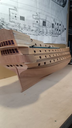

Everything is ready for finishing. Above the waterline it will be a pink pear, below it a mahogany tree (sapel). I haven't decided yet what to trim the foredeck and quarterdeck with, but there are plans for a painted blue hornbeam. I usually don't like to paint the model with acrylic paints, preferring the natural color of wood, with a finish coating with tung oil. But this is already in the next series of construction. That's all for now.

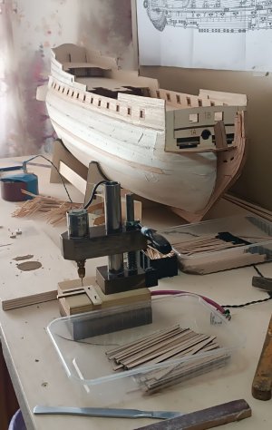

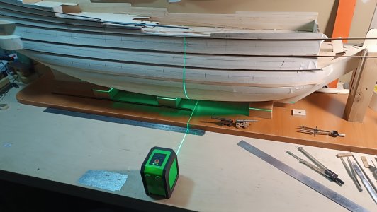

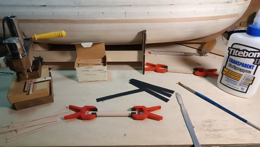

The greatest difficulties and the largest amount of work are, of course, when the hull is below the waterline. There I tried to sheathe using the planking method-calculating the width of the slats in the middle, stern and bow of the ship by the length of the hull. I narrowed them to the required size and inserted them in separate places, I don't know how it is in English, but we call them "losses".
I also had to bend the nose bars or make them from several parts in very problematic places.The profile was taken directly from the hull along the line of the finished skin.
With the work in the stern, of course, the work is simpler.

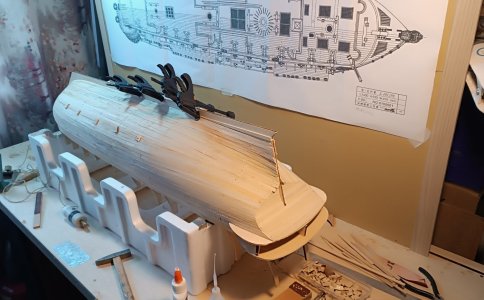

Finally, all the slats are glued, the hull below the waterline is sanded and also brought almost to perfection by cycles. Subsequently, it will be coated with tung oil in three layers.

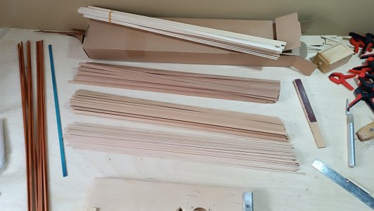

And yes, I highly recommend the glue in the last photo, I use only it for covering the deck and hull slats, one of the best adhesives for ship modelers in my humble opinion-it is reliable and seizes quickly enough, the excess can be immediately removed with a damp cloth, does not leave traces of fringe when pouring wood.

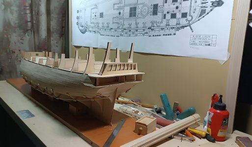

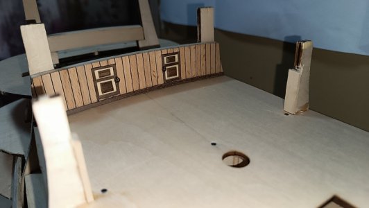

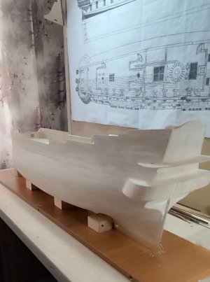

Today I will go back a little bit and describe in more detail the initial work on the building, as the "comrades in misfortune" have questions. The Chinese manufacturer made unforgivable mistakes in the design of the stern, which breaks its entire geometry. I spent a week myself with a ruler, compasses and a calculator, taking measurements from the drawing to get a more or less slender picture in the stern area. It didn't turn out quite perfectly, but nevertheless. There really won't be many photos, I didn't take all the details when I was correcting mistakes, because I was in a very angry mood and cursed more dirty, according to Russian custom, letting off steam))), it wasn't up to the smartphone camera. And that's how I'll start.
Initially, after gluing everythingtogether,Irealizedthat it turned out to becompletenonsenseon the stern, Ihad to tear off everything in thephotobelowandlookforwhat the Chinese were wrong about.
And immediately the first mistake:
I had to fix this place later too. When building this model, you need to count on seven steps forward, and not mindlessly work according to the instructions. As the Russians say: Measure seven times, cut once.
But the main problem was the incorrect height of the beams, as a result of which the deck of the quarterdeck was too low, and the detail of the balcony gallery connected to it under a Polish break.
They didn't take care of one detail for the upper aft gallery at all, they had to cut out 3mm of the remaining plywood themselves. There is one on the lower gallery, but if you just glue the windows to the transom above, you will get an ugly step in profile.
We also need to refine the details of the captain's cabin a little.
I hope I have explained the problems and their solution more or less clearly. I will add more dimensions of the gunwale, because the manufacturer did not bother to make them. The only thing to keep in mind is that my dimensions are based on the fact that my deck is not lined with thin veneer, but with slats 1 mm thick.
