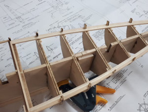

Here are some pictures of my progress to date. Nothing particularly interesting so far, just your standard keel, bulkhead and planking.
The waterways were clearly the place to start - they dictate the placement of the hull planks.
This is a fairly easy and quick hull to plank.
