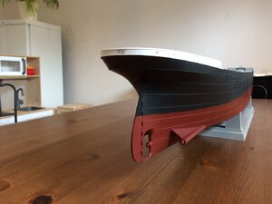

Have finished painting the hull apart from small details i.e the yellow line between the hull and superstructure of my 1/200 Titanic.
Now working on painting all of the superstructure.
Played around with lighting the inside of the hull to see the effect.
Next big job is to pre cut acrylic rods and insert into the portholes and transparent sheet to fit into all the superstructure windows.
Should be a challenge.IMG_4682.jpegIMG_4690.jpegIMG_4681.jpegIMG_4746.jpegIMG_4747.jpeg

Very nice paint job and very neat holes. Good luck with the acrylic port holes. I have finished putting the acrylic port holes in my hull. It did mess up the paintwork a bit though as the glue sometimes gets in the wrong places and on the tool used to countersink the glass ports holes the same distance in.
On the lighting issue. I placed lights weaved into sheets of clear acrylic running down the centre and the full length of the hull. I then placed sheets of clear acrylic with a thin coat of white paint to act as a diffuser. This stops the pin point lights coming from various port holes as you look at the hull from different angles. I now have very even lighting from almost all of the port holes. I hope this helps in some way. (uploaded a few pics).
I have also done away with the horrible stand and made a couple of brass pillars. These pillars also carry the wires for the lighting to the controller.
For anyone on the group that may have an interest in lighting. The LED lighting that came with the kit is in the trash can. I use Micro LED 3v, which do not require the complicated resistors. They are also very cheap. You can also grind off the blob of acrylic to give you a very tiny light. I have wired these individually to the the main cabins and even the outside bulkhead lights on deck. They are slightly larger than the scale but much more pleasing than the large blobs that came with the lit. They are also dimmable!
