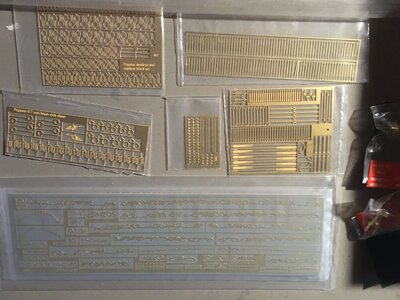

Day 1 - The kit seems to be complete other then 2 castings listed in the parts as #271 & 272. They do not appear on sheet 3 and I can’t see them on sheet 4 either? They are 2 flying ducks, which are part of the etched brass upgrade sheet and listed as not required. So my parts list for the kit has them included but I can’t yet figure out where they go. I did receive my wood carving replacement for the transom decor and side windows into Captain’s cabin. Looks really nice. They also have the flying ducks.
