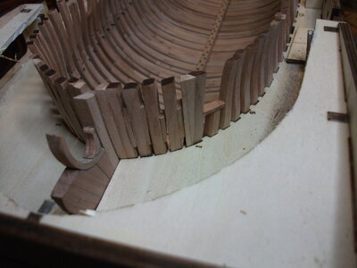

Hope all have had a wonderful holiday season so far. Have been doing a lot of sanding and fiddling on this kit over the holidays and have completed the construction and installation of all the ribs for the hull. Have provided a couple of photos to show progress. My use of screws to temporarily connect the upper and lower sections of the hull seems to be working ok so far. Time will tell. I had a few issues, particularly with the sternmost ribs, where I didn't pay enough attention to the alignment of the rib parts with the plans for each rib. I thought I had but when I encountered a fit problem during installation, more often than not my rib did not precisely match the plan. Lesson learned-pay very close attention to each rib plan.
The overall look:
Bow and stern:
As shown in post #29, when you start part II, the first thing you do is cut away the upper deck of the framing jig at the bow and stern, in preparation for installing the "temporary" strengthening strip. This is what you get:
