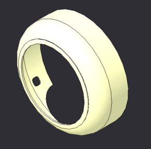

I have been working on the plane the last few days, but on the computer!
I had to use the full scale plans and measure, and then take out the lazer cut parts and metal cast parts to measure them with calipers.
Then I used all of that information to CAD up enough of the frame to design some parts.
I am making a motor cowling, cockpit cover, and the machine gun cowling.
It was a lot of work as the frame tapers side to side, top to bottom, and the location and size of the bulkheads are all different! And it needs to be exact for everything to fit properly
Here is the frame and guns, that is my foundation to work with...
First was the cowling...

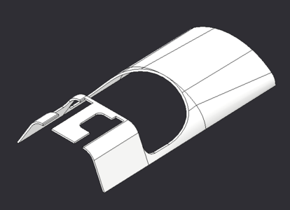

Then I modeled the cockpit cover, which extends past the seat to cover the gas tanks.
I still need to make two holes in the proper locations for the gas tank filler necks. Those will be fun to locate, I may have to wait until I create the fuselage and place the tanks to get the exact measurements.
There was 4 sections that I had to locate and sketch to use for a swept profile. This was the hardest part to create!
