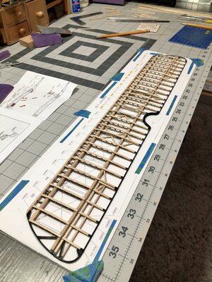

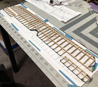

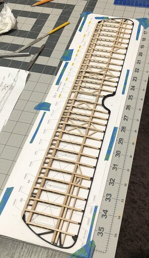

I finished the left side wing tip and trailing edges…
Then I painted everything and added the bolt heads to the straps…

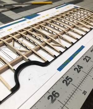

Then it was time to cut the ailerons loose from the frame. Kind of scary, as one slip and you are going to ruin a lot of previous hard work! So with a cutting wheel, I carefully made cuts to free them.
Afterwards I had to sand everything flush.
Then it was time to touch up the paint and paint the cut edges.
Now is the time to decide if I am using clear or a light stain on the wood. It will take a while to coat all of the surfaces.
After that I will attached the ailerons with hinges, and add the control horns to them.
Then will be compression braces and turnbuckles and tension cables. Only then will the wing be completed! ;)
