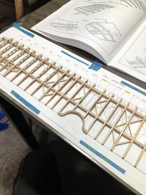

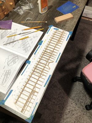

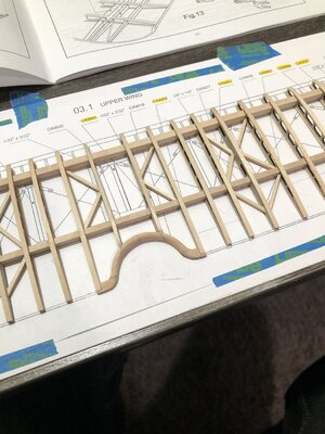

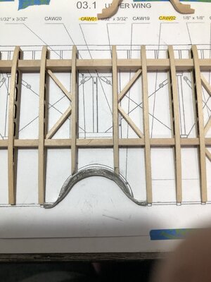

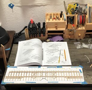

After dealing with the cast piece for the cutaway on the upper wing, I decided it had to go. First of all, the size doesn’t match the provided ribs. So I had to extend the ribs…
This looks horrible and I can’t live with it…even when painted black and straps added across the ribs at the trailing edge, it doesn’t have a smooth transition to the trailing edge. It looks twisted to me.
So I scratch built one out of wood. It will still be painted black. But now fits properly and has a nice transition to the trailing edge.
0AF77C5C-3DB9-43C4-A674-4195DDCB7FAD.jpegE8C353E0-CB40-4B27-B1F4-72CAF20731F7.jpegF76174C5-9D1C-4009-AC70-E010649AA875.jpeg
That’s how I spent this evening! Oh well, on to the leading edge and wing tips…but first I have to add more ribs between the main spar and leading edge, and also drill holes for the control line pulleys that mount to the main spar. Can’t drill them with leading edge on. ;)

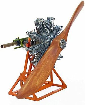

Thanks for replay Dean!
About the propeller, did you buy another one or you modified the same of the kit? Seems to be a new one ...
Originally I made the one in the kit, then I decided to make a different one. So then I just used the same profile as the kit provided propeller and used my own wood. I got the profile by using the leftover lazer cut sheet for the propeller as a template. ;)
This looks horrible and I can’t live with it…even when painted black and straps added across the ribs, it doesn’t have a smooth transition to the trailing edge. It looks twisted to me.
View attachment 291433View attachment 291434View attachment 291435
A good decision to scratch your own, Dean. Always listen to that little voice in you head! Looking forward to the extra’s you will make.
