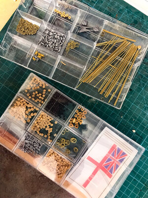

The model is laser cut and appears to my novice level at least to be good quality. Predominantly wood, it is accompanied by brass and metal fittings. The fittings are nicely packaged in plastic storage containers with lids rather than in bags or premoulded plastic/card containers, and the wood strips etc. are grouped by elastic bands. The model also comes with sails although I am not sure at this stage whether I will add those to the model or not. A paint set can also be bought for the kit although additional stains & lacquers need to be purchased.
Apologies that I don't have the full unboxing images as I had already started the build before joining SOS.
