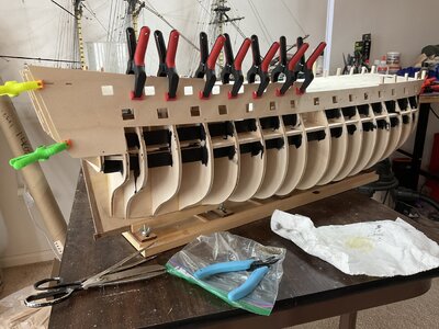

Okay, time for the first update,, Unfortunately I am realizing that my wood glue is now old and I need to go out and get some new white glue,, what I am using is old and from when I was working Vanguard hull,, it seems to have worked but the spouts are destroyed,,,I am going to get some new glue later today to keep. Moving and be more precise, You can see my vanguard is back in the shipyard for some “cleaning and touché up” in the back round!!!!! I am scared to death of getting these gunport templates right, I had them slightly off on the Vanguard and I never was able to really recover. I know I am a perfectionist, but even half a millimeter off and I am unhappy,,,
Good afternoon. All looking great. Something I would consider before going too much further is to do the fairing of the frames. There is significant shaping around the the bow and stern with the Victory and may be easier to get the sanding in without too much fitting above/near these frames/bulkheads. Cheers Grant

time for updates,,, I am about half way through first planking, already have made errors,,, (Still a surgeon, confess your errors to the group at M&M)
I messed up the bearding line,, I put the stern post on early by accident following the plan sheets instead of written directions reading into the lines, and ended up sanding the sternpost down with the bearding line,, I don’t think it will be a big deal, I will plank over it and I doubt it will make difference in the end. As I look at the gunport patterns I realize one side is about 3/4 of a MM off and I am upset about that, I was so sure it was perfect as I put it on,, too late now, I will adjust as we go. I also failed to taper the stern extensions a bit before I put the gunport on, so hopefully it isn’t too wide. I can sand things down as I need, And lastly I have already lost a something. I did my inventory and now can’t find a small bag of dome head nails. (Part 696) that I know I had because I was impressed with the quality when I did my first pass through the box. Stupid,,,,

Good morning Doc. Looking good. As you venture along your journey with this massive and majestic ship, you will misplace many little parts - I know I did. They always resurface at a point tho mostly a point when you don’t need them anymore ROTF . As a fellow Victory builder I will follow your progress with enthusiasm. Cheers Grant
Doc, you are making great progress, looking good. I had some issues with the port to starboard alignment of the gun port strips, a little off when looking at the ship head on. Will have to adjust as always. Have about 10 planking strips on either side of the hull, going on ok. I am finding the stern planking to be at least as challenging as the bow. Patience is a virtue they say. Am looking forward to the day when first planking is done and sanded.
