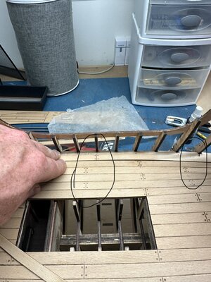

So I ran into a problem with my main deck planks not lining up,you can see the attached photos. So I decided to move all the deck planks back and just add a short length of plank to the front of the plank. I was able to do this with all the planks except the last two. So I sanded off laser etched planking and treenails and just burned some new ones. I think it came out pretty good.IMG_6515.jpegIMG_6517.jpegIMG_6518.jpegIMG_6519.jpegIMG_6520.jpegIMG_6521.jpegIMG_6522.jpegIMG_6523.jpegIMG_6524.jpegIMG_6525.jpegIMG_6526.jpegIMG_6527.jpegIMG_6530.jpegIMG_6529.jpegIMG_6528.jpeg
That is an ingenious solution, and looks great! I hope my kit has the right plates, as I don't want to have to do all that extra work!
Thanks Freddie that’s what this forums about sharing ideas! I went a little overboard, you don’t need to extend the planks. The bow bulkhead will hide that section. My OCD took over. I would not be able to sleep at night knowing the PORT planks are shorter than the STBD
Don't let your OCD get you on plank treenails, as on any ship with planks there would be treenails at every frame all across the deck, not just at the ends of planks only. To look closer to correct you would need treenails in a straight row across all planks at each bulkhead shown.
Kurt Yes I am aware. Contemplated doing them all. This ship is done retro style. So that will be my excuse if I don’t them all.
