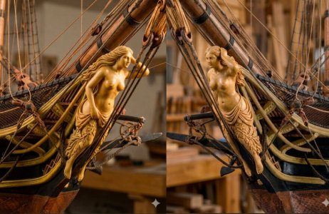

For those who love to read and reflect.
Many will understand that at a certain point, you start wondering what you'd like to build next (and many get so carried away that they don't even finish their current projects). Naturally, I won't start a new one until I finish my current project, but I still can't resist dreaming.

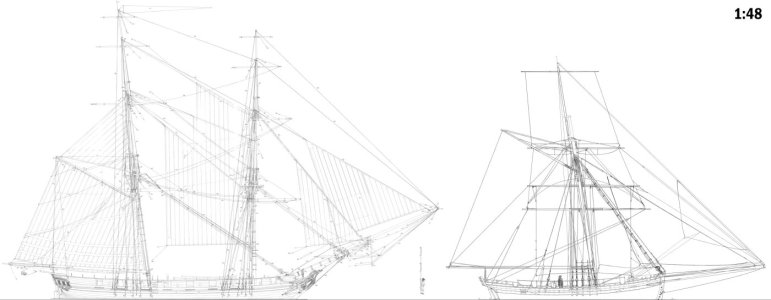

I've had a monograph on the brig Le Cygne 1806 for many years. I really like this ship and have wanted to build one for a long time, even before Victory and Alert. Here, by the way, is a visual representation of the difference in size between a cutter and a brig in 1/48th scale. The size difference isn't that big, but the brig is much larger.
I also like large three-masted ships, but the size... They're difficult to make in a small scale (1:100), as I experienced on the Victory, and in 1:48 they're so huge you wouldn't fit through a door. I wanted to do something in 1:48, and the cutter was the perfect solution. But I always wanted something in between. It had to be small, not huge, but also have a complex design, both in the hull and the rigging. And the brig Le Cygne was the perfect candidate, but!

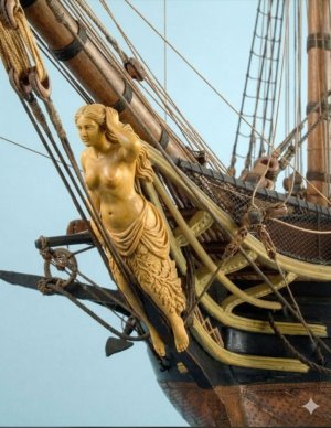

Two factors have been holding me back all this time... The first is the carronades. I didn't like them until recently, but! I've researched the subject, learned the history, thoroughly studied the mechanics and all the advantages... and I really like them now. The second factor is the Duck... The Swan's figurehead is just a real disappointment. So I started digging through monographs. It turns out that about 60 brigs similar to this one were built by the French, 20 of them were complete copies.

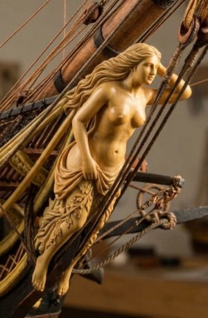

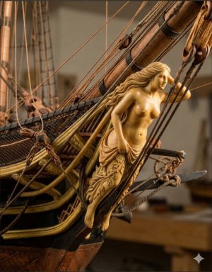

So I decided to find out which of my sister ships could accommodate the figurehead I wanted. It had to be a brig with a female name and carry carronades (some had either fully armed or partially mounted cannons). Working with Artificial Intelligence, we decided that Le Faune 1805 would be such a brig. This brig could carry a female figurehead, a nymph, so I decided to generate in Gemini my vision of the ideal figurehead for this brig. I gave it drawings of the forward section without the figurehead and a photo of a brig model with a different figurehead, so it would take just the model and insert a female figurehead, which I described in words. I described in great detail what she looked like, her pose, where her arms and legs were, where she was looking, and to add a few branches and leaves, because she was a forest nymph... and I was simply shocked by the result!!! Here's what I got:
To be honest, I didn't have the slightest faith that it would work, but this was exactly the result I wanted to see... I made absolutely no changes, and I realized that if you describe exactly what you want, Gemini will do wonders.
The idea of replacing the figurehead was indirectly inspired by @Kortes , who is building a similar brig based on these plans, but named Le Favori. Hi Sasha, here's a working diagram for you on how to design a figurehead for your model.
So, if I ever build anything else (if I have the time and opportunity), naturally after finishing my current projects, it will be the Le Faune 1805 brig (based on Le Cygne's monograph) with a figurehead like this...
...if I only knew how to make it))) but that's another story.
