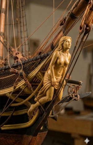

Thank you. I was shocked myself that the AI produced a result that completely satisfied me on the first try. I responded in more detail in a private message. Thanks for the link. I saw something interesting.
That figuerehead is absolutely stunning. No wonder one decides what's next just starting from this beauty female representaion. So... congrats even in large advance!
Judging by the fact that several people have contacted me via private message,
I've decided to explain in more detail how I generate figureheads in Gemini.
1. You should have a photo of the finished model you want to make, or something very similar. Preferably from a diagonal angle. Let's take the photo I generated (I used exactly the same one for my version, except it had a Cyclops figurehead).
2. In the AI task, you need to specify that it should not change anything (neither the model, nor the background, nor the tone) and simply replace the figurehead.
3. Ideally, you should upload the model drawings without the figurehead and specify that it take into account the position of the parts, rigging, bowsprit, and stem.
4. Add a reference image of the figurehead you want, or verbally explain what you want to see. If the reference image contains something you want to change, it's best to do it in a second pass. So, first let the AI insert the new figure into the model, and then you can change what you'd like in the reference. If you're describing what you want to see from scratch, be very detailed. What's the pose, where is the right hand, where is the left, where are the legs, what are they holding, what is the clothing, etc. If something's wrong, make adjustments.

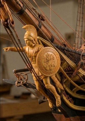

I'll use another brig model being built by @Kortes as an example to show how I did this. Sasha sent me a couple of photos. In one, the girl is resting her hands on the ground and has a mermaid tail, but since that doesn't quite fit the name Le Favori, I made the legs normal. Sasha also sent a bust of a Greek warrior, and here it perfectly matches the abstract, masculine name of the ship. I wrote for the AI to add a body in Greek attire, a shield with a coat of arms, which fits the theme of good luck. Since the sword in the hand is too long, I wrote for the warrior to lead the way, with the sword in its sheath. Here are two options:
I think the second option with the warrior would fit right in with the title of "Favorite." Саша, как говорится - на здоровье ;) :cool:

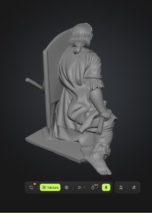

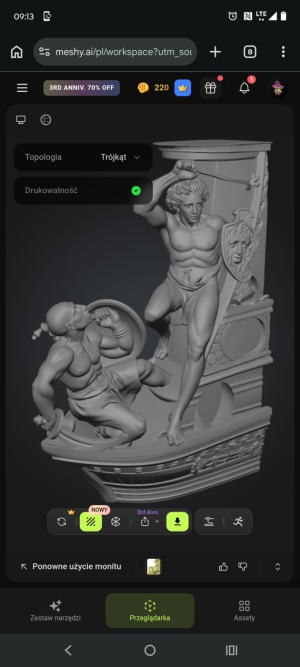

You can try to extract ai generated figurehead and put it into meshy. You can even sucssed in first try, but the best results are form multi reference wiews
Personally I wouldn't use ai, to me it's like using thermomix blender instead baking cake with own hands. As they say, to each his own. Nevertheless, I don't believe you can create sculptures by relying solely on AI. A middleman is needed to fit the results into the project as a whole. But it won't take long—maybe a year or two.
The upside is that AI can't cut woodROTF(YetAlien)
Sth I got from a friend. Find three mistakesROTF

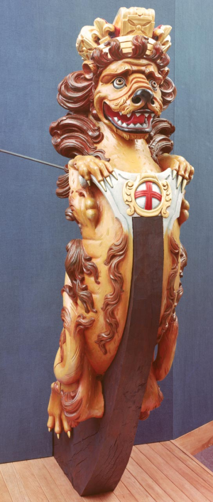

THAT would get me to try it. Until then, saws, burrs and chisels. I don't understand my own thinking here though. For my current project because no aftermarket supplier can provide 44 perfect, exact pattern, size, cypher etc. in Commonwealth pattern metal guns I am good with resin printed or cast resin cannon. But I am not happy with the idea for my own model for a single resin printed figurehead. Am I alone on this? I know full well if this kind of thing was available to 18th century model ship builders, some/many/most would use it without question. Then again, maybe it is time for a change for me. This brings up a question. What color was the common crowned lion figure head used on ships named after towns painted? Was there a written standard? If they were always painted, why bother carving it out of wood? I found the following
  • White and Gold: The most common and cost-effective finish. The lion was painted solid white with gold leaf or yellow paint applied to the mane, the royal crest, and other decorative accents.
  • Natural Wood & Yellow: Some lions retained the natural carved wood or were painted a pale yellow (yellow ochre), with details like mouths and flags highlighted in red and blue.
From RMG

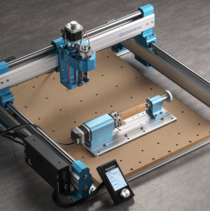

Have you tried reaching to some companies with cnc lathe. It possible to make it, but without engraving royal symbols. Milling those symbols increases the price and time-consuming work. I would suggest making gun barrels on cnc and adding resin royal symbols

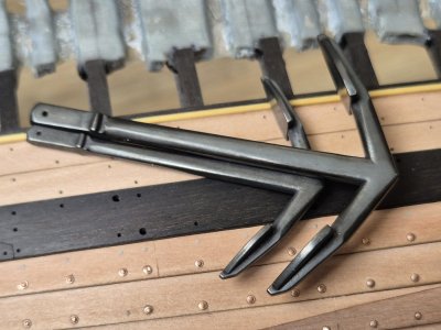

Don't forget that electroplating is also possible! You can print any complex plastic object, then coat it with copper and then blacken it, and you'll never know it's not metal, because it's already metal, but with an internal plastic core. I'm currently working diligently on this, and my recent tests show that the product created using this method is technologically complex, yet extremely realistic (I mean, it's blackened metal).
In my opinion, no paint can replace the true shine of blackened metal. But on my Victory, I'll be painting all the metal parts, including the guns, with matte black camouflage paint, because in 100th scale it's forgivable. So, overall, I'm in favor of all methods. ;)
