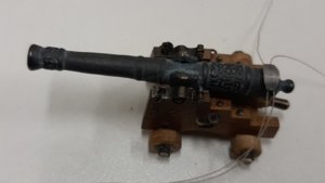

Inspired by the blog of John @neptune I decided to modify my gun carriages and change the wheels for wheels without a steel band.
This was my first gun carriage build as provided by the kit.
For this first the laser char has to be removed, I do this in my drill using a small m2 bolt and nut fitting two wheels at a time and removing char with a file while running the drill.
The wheels bolts are fitted keeping the two halves of the wheel together. The kit provided 1 mm brass, I replaced this with 0.6 mm steel.
For drilling the holes I prepared a small special tool template on my column drill to have every hole alligned correctly.
I also made new axles with new locking pins and a reinforcement iron belt at the end of the axle. The belt is made with shrink sleeve.
After fitting the iron pins to the wheel, filing them and burnishing the ends it is time to dry fit the wheel and axle. To simulate the two halves of the wheel I cut a fine line around the wheel.
As I want to position the guns in different positions this one will be loaded and the zund hole covered with lead. For the lead I used soldering tin flattened with a plier and shaped around the gun barrel. Glued to the barrel with some rope.
The ropes tight to held the lead slap in place

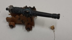

Next is the large pin in the wedge, far to big to my taste so I made a new one from boxwood by turning it on the lathe.
A big improvement by making something smaller. The kit supplied handle in front of it.
As I represent this as a loaded gun I add a plug to the gun barrel to keep it clean and dry.
Again on the lathe I turned it from boxwood.
And drilled a 0.3 mm hole in it to fit a ring.

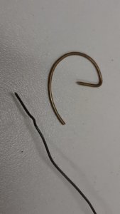

The ring I made from copper wire from an old network cable.
After soldering and burnishing the ring I fitted a rope to it and cut it from the remaining boxwood. I cutted it at last because otherwise it is to small to handle.
Then fit it into the barrel to keep the charge dry and protected against the elements.

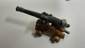

Fitting it on the deck.
7 more to follow including the gun rigging.
