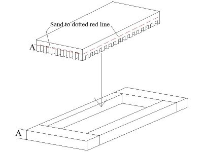

7. Sand away excess wood on the bottom and clean up any remaining unwanted wood. The piece on the right is nearly sanded through.

It is best to cut the pieces of grating as close as possible to the size in the drawings so there is a solid edge all around. Openings with hanging ends of battens and ledges was never done like in the second photo below. The battens always ran fore and aft. Once the gratings are made, then make and install the coamings so there is a tight fit.
