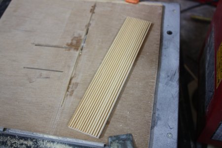

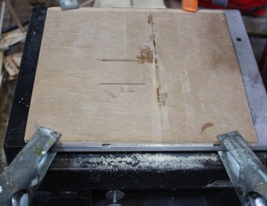

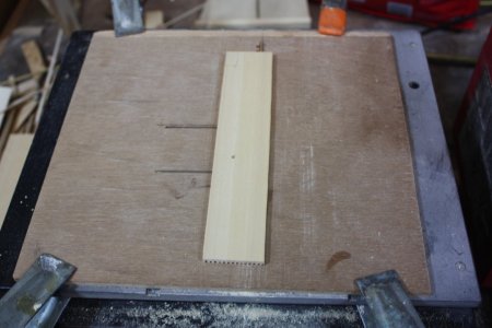

1. Make a board with a plywood board and glue a guide and cut a slot for the blade so the distance between the edge of the guide and blade is the size of the opening that you want.
2. Make shallow cuts

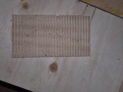

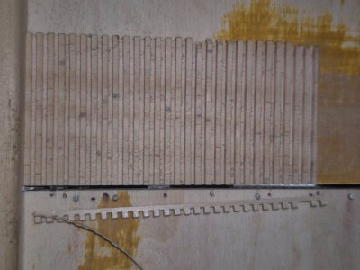

4 Make deep cross cuts that do not quite cut through the board.

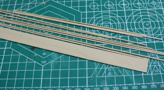

5. Make batten material

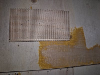

6. Inserting battens. Once they are all in place spray with lacquer to glue them in place.

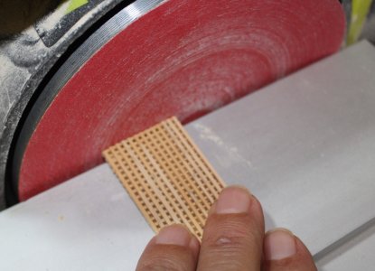

7. Sand away excess wood on the bottom and clean up any remaining unwanted wood. The piece on the right is nearly sanded through.

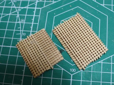

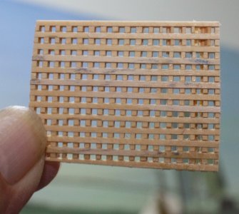

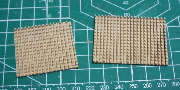

8 Assembled grating stock from which individual gratings can be cut. As can be seen in the photo, some light sanding is needed to clean up this stock piece.
It is best to cut the pieces of grating as close as possible to the size in the drawings so there is a solid edge all around. Openings with hanging ends of battens and ledges was never done like in the second photo below. The battens always ran fore and aft. Once the gratings are made, then make and install the coamings so there is a tight fit.
Delusional kit gratings below. The gratings never should have open holes along the outboard edge. The holes were normally between 2" and 3" square so a sailor's heel could not go into it.

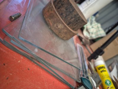

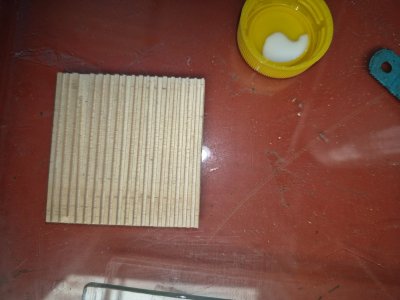

Ok, so what I do is put about that amount of PVA glue ( as shown in the Photo with the glue added into the bottle cap) into the lid and add enough water to dilute it, enough to cover both sides of the piece of wood. Now this is the tricky part, as we know, when water is added to a fragile piece of wood, it does crazy things. It will warp the wood and even to the extent of actually splitting it, so first up, apply the wash to the non-grooved side and then to the grooved side. It will still warp, but by placing the piece between 2 pieces of glass, as I have done here, and adding weight to it, the piece will straighten. Allow at least 3 hrs before removing.

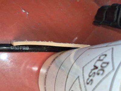

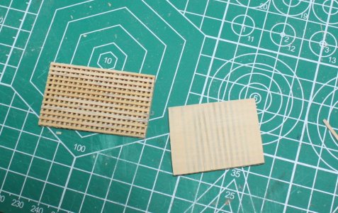

The wood here is warped, as shown in this pic, before placing it between the glass pieces. You will see I had not cut the grooves on one side yet, as I was trying another method, which did not work.
Here is the piece now with the grooves added, and I have a pointer showing a bad mistake......

So, when I have more info and pics, I am having a little success with PVA wash but knowing how to apply the wash is very important.

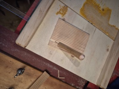

was referring to once you cut the grooves on one side, then turn the piece 90 degrees to put the beginning of the first groove that is going to be the first cut of the strip. Let's see if I can explain better with Pics.
I am showing the side of the cuts facing upwards, to explain the procedure...
Here is the material with the grooves cut....
Then I turn the material to 90 degrees to do this cut again, at half the depth on the groove side....
Then, I turn and do this cut across the grooves. This again is only cut halfway through.
THEN..
I turn the piece over and perform the last cut to produce the Strip.
The strips do not lose many of the extruded shapes or any at all, since I have been using this method. One extruded shape is missing in this pic.
Also, you can see the alignment dowels I have placed across the sliding table for all different widths of the material I am working on. You can see my failed attempts to get it right, also.
