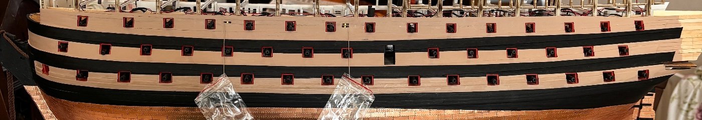

It may be the photos, but the blocks all look like they are upside down so the line is running against the tail, instead of between the crown and where the sheave would be.
Hello Allan, you are right! The blocks are all turned upside down. Sorry to say, but these blocks are scrap, and I don' t understand why AL - and other kit manufacturers - provide such blocks with their kits. I would never use them but buy proper scale blocks instead.
Werner
Werner
Not going to change them now
What blocks do you suggest for when I do the quarter deck guns

I think you’ve answered your own question as to what kit manufacturers supply poor quality blocks, the price ! At the end of the day they are there just to create an illusion of the tackles and at that scale, unless you zoom in you probably wouldn’t notice that much, but I’m going to try to get the quarter deck guns looking better as they are immediately more visible

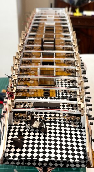

In this 2nd instalment, I build and place the furniture for the upper deck stern cabin areas, build and fit the entrance doors to the officers roundhouses at the bow. Then onto the bits and sheaves around the main mast and I have to say, placing part U32.C is a lot trickier than it looks in the video
Next in the video is making the pillars, but I decided to skip that part for later, and as I was in sheave mode, started on making the boxes and sheaves for the hull sides. Finally in this instalment, I fit the large cleats on the inner side of the hull and attach threads as indicated. It doesn’t mention in the instruction video but I sanded the “horns” of the cleats into a rounder profile. With the threads, it states leaving 400mm of thread hanging out through the sheaves but with the experience I had earlier in the build with the length of anchor cable to cut, I decided to leave over 500mm instead, as I learned early in my electrical apprenticeship regarding cables, “it’s easier to cut them shorter than make them longer “
Again, lots of progress pics below.

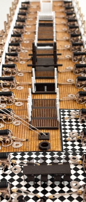

Alan,
As always a nice update. Too bad about those blocks... but given that only single side holes are drilled into these (all kit provided) "junk blocks its easy
to occasionally reverse installations.
Good decision getting aftermarket blocks - they make huge idetail improvements. Especially for a ship such as yours. Yea, but in the aggregate very costly
PS: Did that table map come with the kit -- very cool!!!

Thanks for you comments
The map is my own addition, a photo of an old map that I reduced in size and printed out

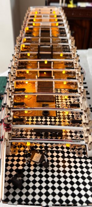

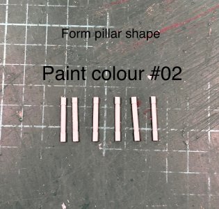

Instructions video #33 completed

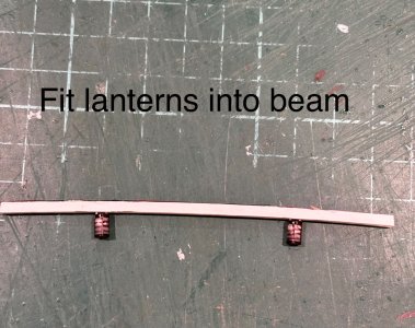

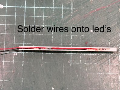

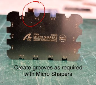

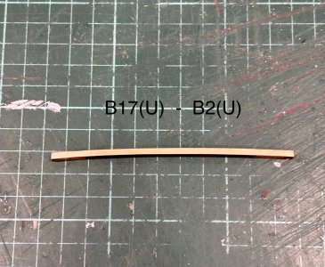

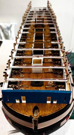

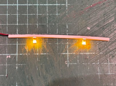

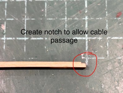

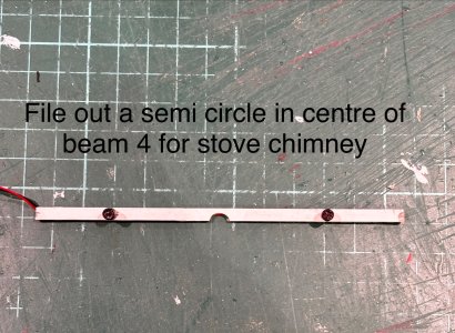

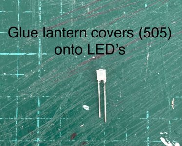

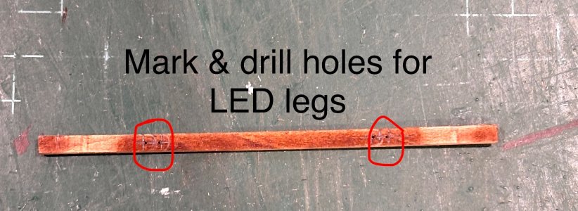

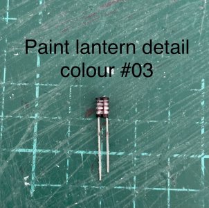

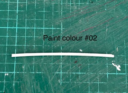

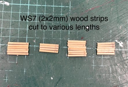

In this final part I form, paint and place the pillars on the upper gun deck then prepare and paint the supporting beams for the quarter deck before making and fitting the led lanterns to them and fitting them in place on the ship. Routing the wires is different this time, previously the frame timbers were drilled through to the outside then notched out to allow the wire to travel the length of the hull keeping within the space created by the inner and outer planking. This time a notch is made at the end of each beam for the same purpose, I assume that this is because the frame timbers, especially towards the bow are getting thinner now. You still need to drill through the frames to route the cables but with these thinner frames I’ve drilled 2 smaller holes for each individual wire instead of one larger hole as I’ve done before. You may notice that I haven’t painted the central section of 3 of the beams, that’s because in the next video instructions they are cut out to form the waist/skid beam area.
As usual I have attached progress photos.
