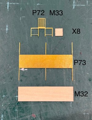

Video #29 Update

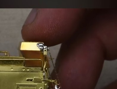

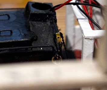

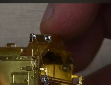

Part P70 arrived today so I fitted it as best I could. It has to be bent into an offset shape to go through the chain. None of this was shown in the video, just the part in position
I had to paint the lower part before fitting as it passed behind a brass ring which would not be there if fitted at the correct time. I have included a couple of stills from the video to help others with the positioning

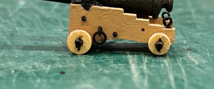

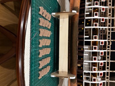

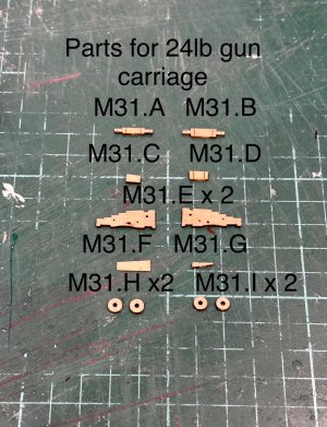

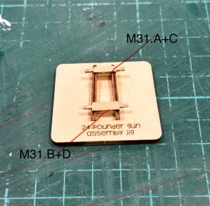

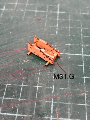

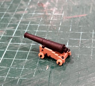

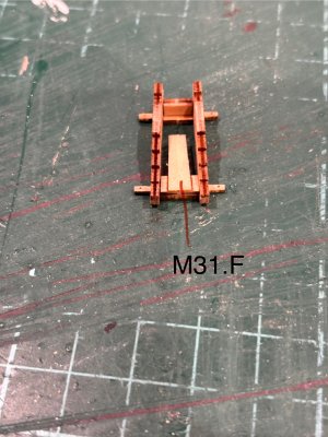

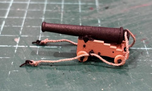

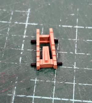

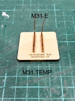

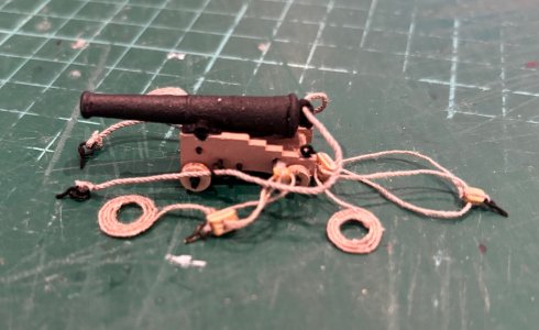

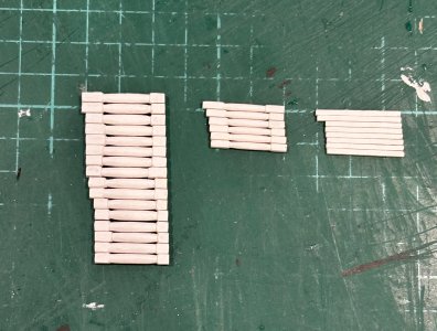

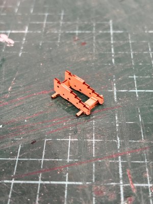

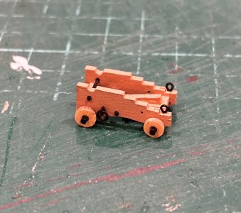

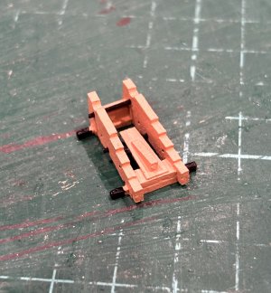

In the first part it’s back to making guns for the middle deck, 28 x 24lb on this deck. I won’t go into too much detail as it’s been covered before ( video #23) so will just show some progress pics
A couple of things I did differently this time. Firstly I glued the wheels to the axles, they don’t need to turn and last time I found it difficult to keep the glue at the bottom of the wheels when moving the guns into position on the deck. I think I mentioned last time that I didn’t like the look of the silver wire holding the wheels in place, so I looked at some photos of Victory’s actual guns and saw they were secured by what looks like a metal rod (possibly wood originally). So I bought some 3mm brass rod, cut it into short lengths and blackened it. I then drilled out the existing holes in the axles and glued the rods in place. I only have half of the guns actually in position on the deck at this point, but wanted to make the post today so I could wish you all a merry Christmas

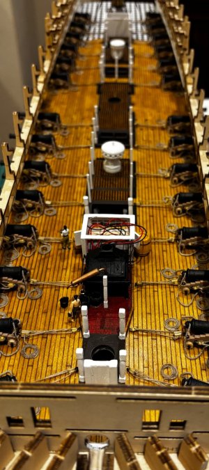

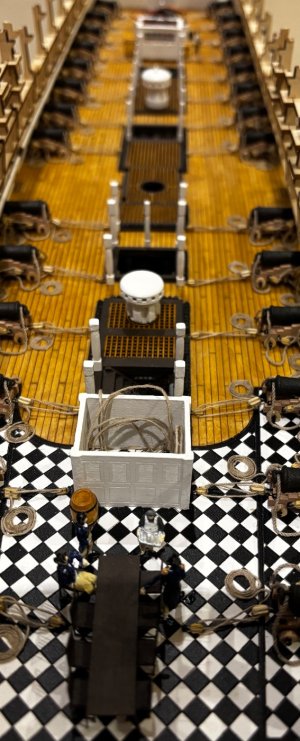

I dragged my heels a bit over the festive period but finally got all the guns mounted on the middle gun deck.
Before I start on the pillars and beams I thought I’d just post this short one.

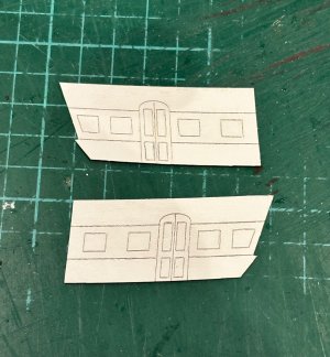

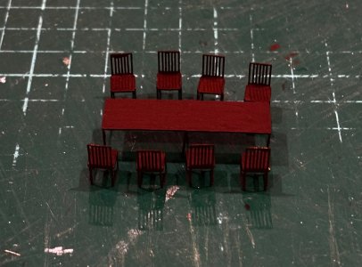

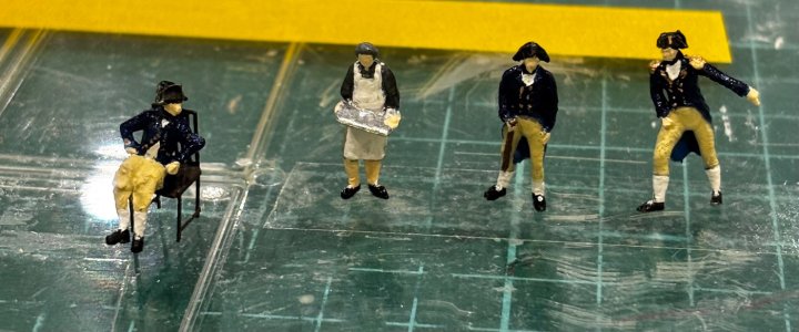

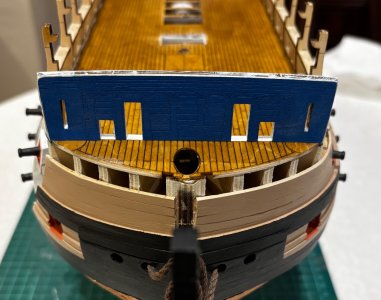

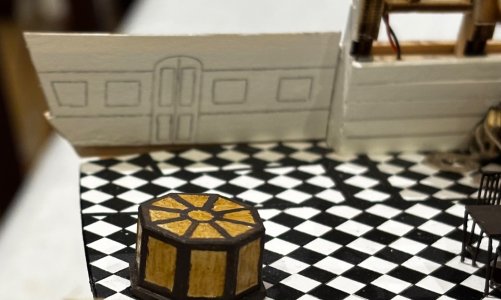

I made the furniture for the wardroom and painted up a few figures so I could create a little diorama in that area

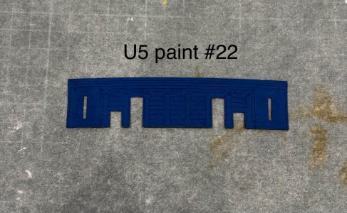

Finally, although this is not done until the end of video #30, I decided to do the printed walls at the stern sides.
Instructions video #30 Completed

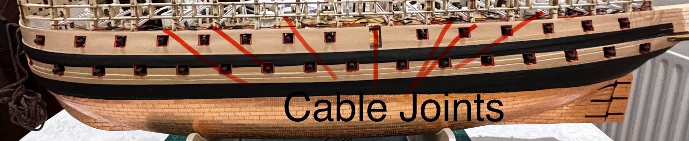

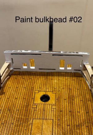

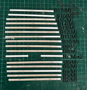

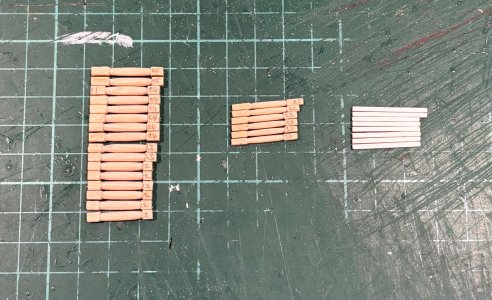

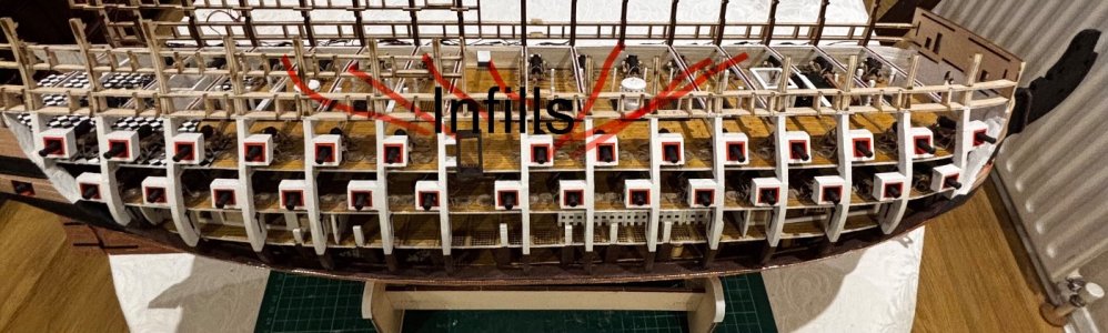

☑️ In this final part I measure and cut the various lengths and sizes of timber for the pillars before shaping them on the mini lathe. After painting they are fixed in position. Next I groove out the tops of the beams, paint and fit the led lanterns to the beams and wire them up. After fitting the beams in place the cables are then solder joined and covered with heat shrink tubing.
Finally I cut and fit the internal planking infills between the beams.

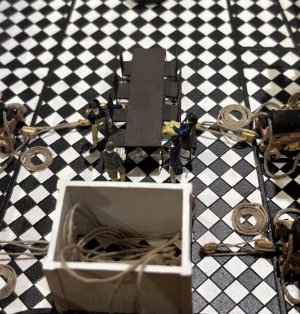

A little diversion while I’m waiting for some paint to dry
Years ago when I was building another Victory kit I sourced some small brass buckets that turned out to be too large in scale, but I went to the trouble of making some GR cypher decals for them. I came across them the other day and decided to place some around the ships pantry with some sacks
Hey Alan,
Wow, that looks great. May I ask how big these letters are and where you had them made?
By the way, the figures look very nice. Are these the figures from AL for Victory?

Thanks Gunter
The whole cypher is probably about 2mm high. I made them myself by copying the cypher, reducing it in size using desktop publishing software and printing a batch of them onto clear decal paper in my printer
Yes they are the AL figures although I had to adapt the one sitting down

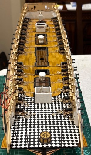

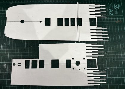

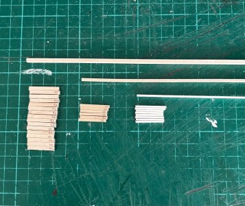

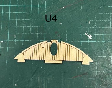

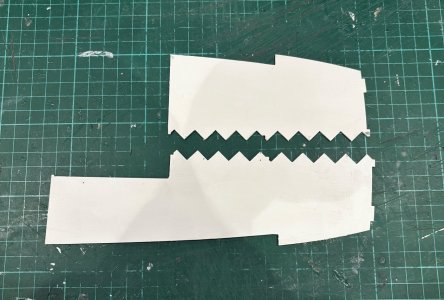

Instructions video #31 Part 1

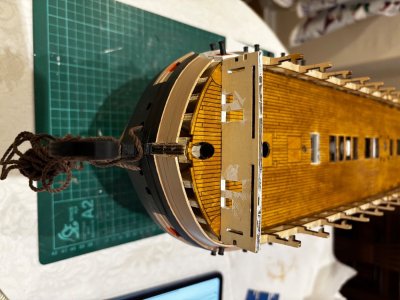

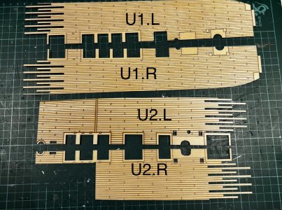

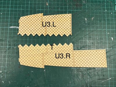

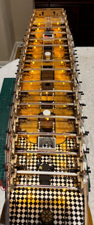

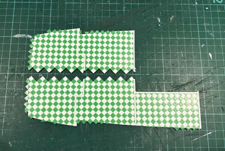

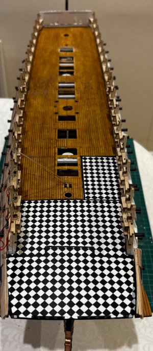

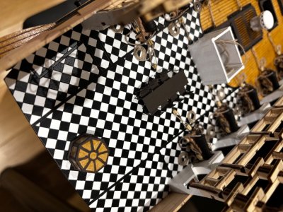

Video #31 is quite a short length compared to some of the others, but the work involved takes quite some time, that’s because it’s all construction tasks that have been described in detail in previous videos like fitting decks, internal and external hull planking, gun port linings, wales and painting etc.
In this first part I deal with the decks.
Similarly, as I’ve already gone into more detail in my previous posts, I will just post picture progress which should be self explanatory.

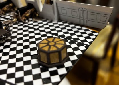

Hey Alan,
That looks great. I do have one question, though: is the checked pattern a foil? I mean the green checked one. Because later it's black – did you paint over the foil with black?
As always, it looks incredibly beautiful!! Thanks for showing us. Thumbsup :D
