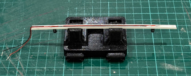

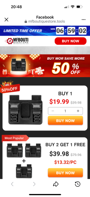

This is the stand I was commenting on, for the cross beams with wires.
Ah,ok
It’s a soldering “hands free” aid from an add I saw on Facebook. Not sure my pic is the actual store I purchased from (didn’t think I paid that much, but I could be wrong, had it for quite a while now) but think there are plenty of similar things out there if you search for soldering aids or clamps etc

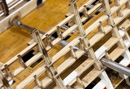

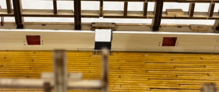

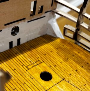

When i read the instructions on the Thick frames at the op behind the gun ports I didnt cut then to shape as i assumed they would be covered ind it would be difficult to get them flat
However After fitting them all I realised that the need ed moveing over to allow the Gun Ports to be the right size
Removed Y5 burnt the wood a bit and cut that (Will clear that later)
Removed Y1 and it went well
Using my Sander it was actually very easy

Ah,ok
not needed you just twist the wired and a drop of solder

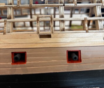

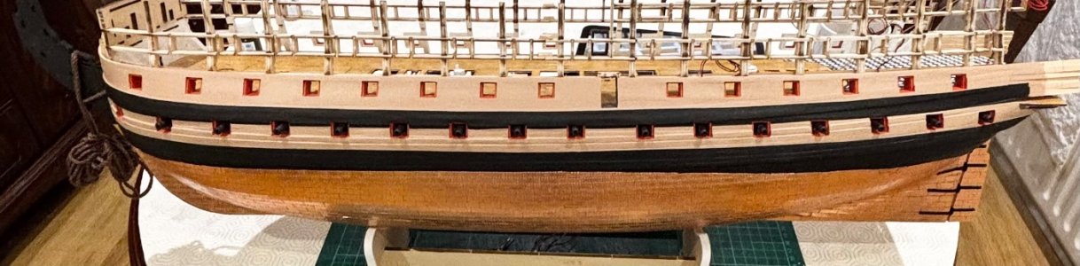

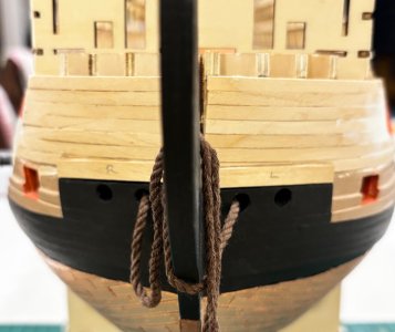

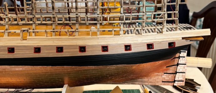

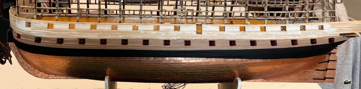

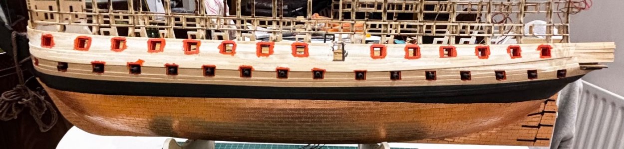

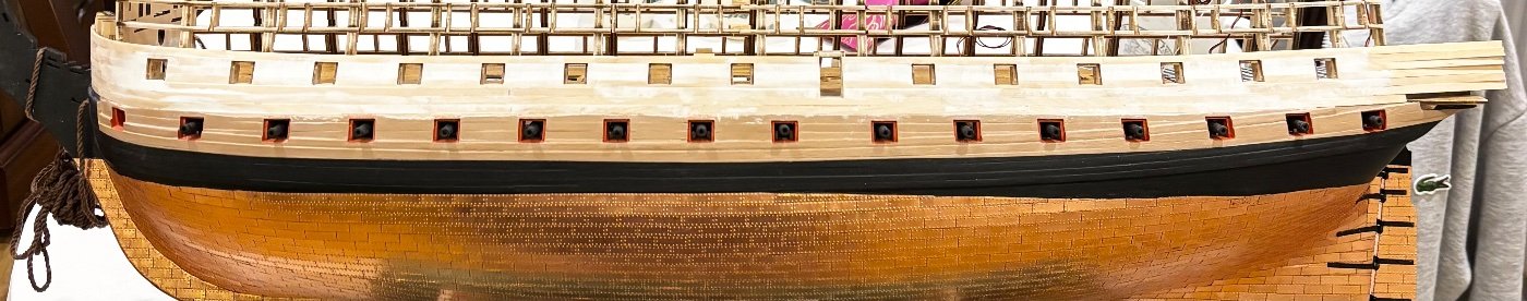

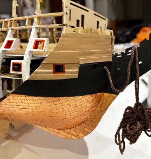

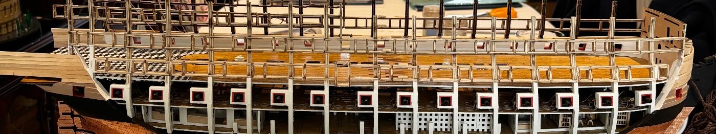

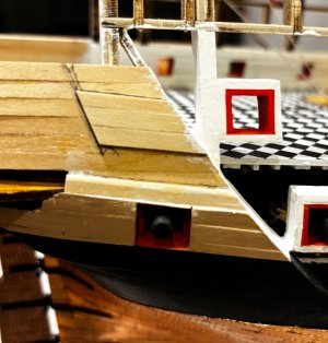

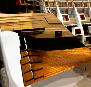

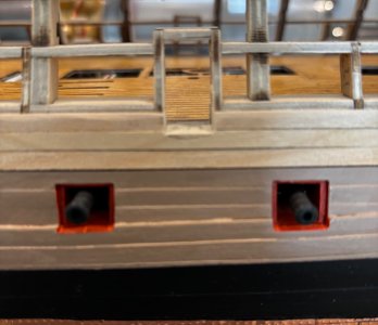

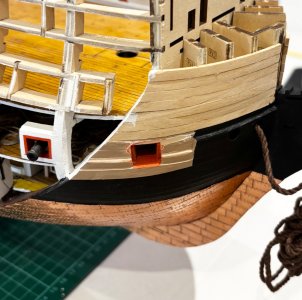

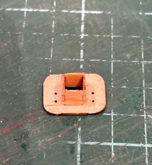

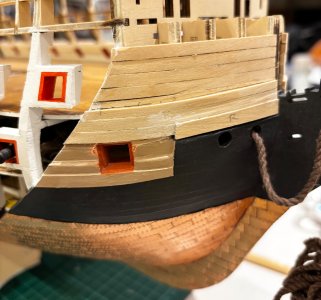

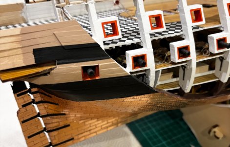

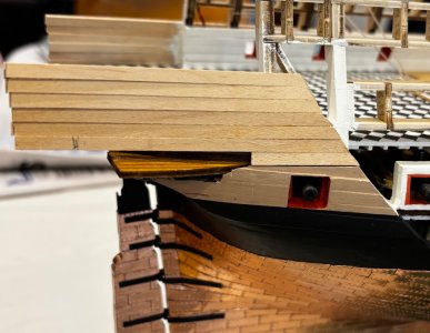

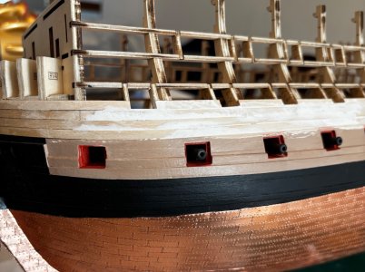

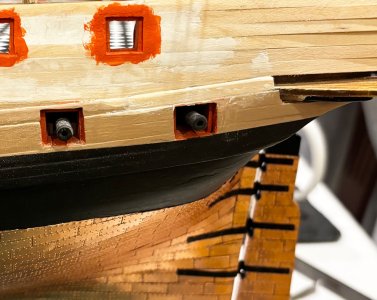

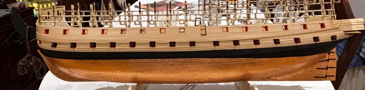

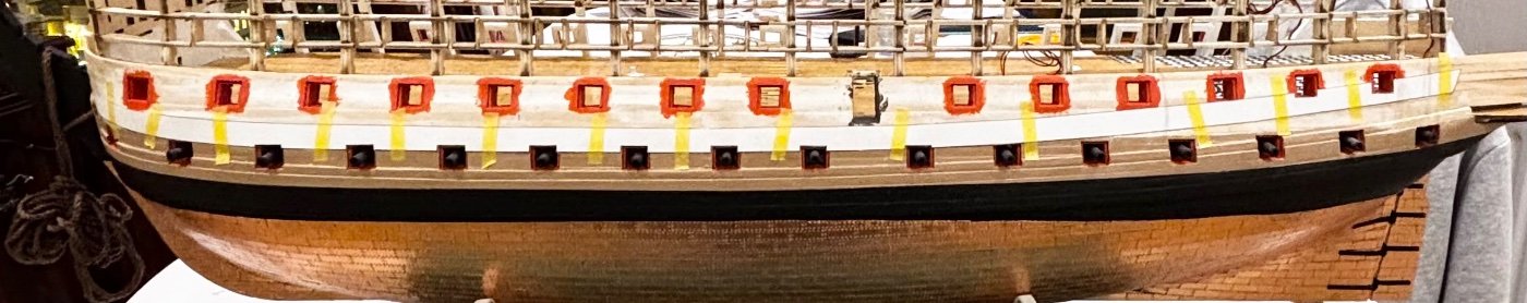

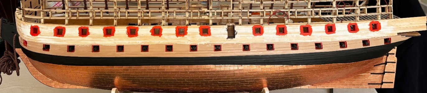

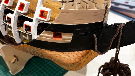

In this final part of video #27 I start by assembling and installing the parts that I assume make up the lower decks of the stern gallery. Next it’s planking the inner and outer hull and fitting the gun port linings. This time I completely changed the sequence as shown in the video, firstly I planked the outer hull, then fitted the gun port linings before planking the inner hull and finishing the planks flush with the inner edge of the linings. This saved all the filling in I had to do on the lower deck and I think it’s a more prototypical way of planking. It was more difficult to trim and clean around the inner gun port openings,(perhaps why they show the different method on the video) but I’ll take that.

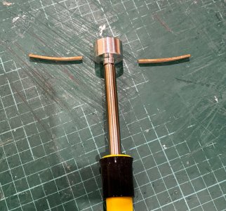

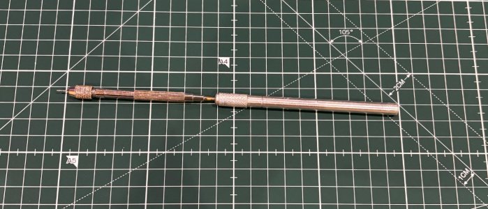

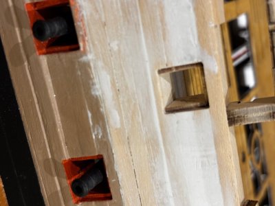

Next it’s making the template and drilling the holes for the gun tackles either side on the gun ports. You may recall that earlier in the build I had contacted AL about the pin vice their builder uses to drill through the gun ports but without success. I already own a pin vice with a chuck small enough to go through the gun ports but the chuck doesn’t close down enough to hold the 0.5 / 0.7mm drill needed for the holes. So I contacted them again and pressed for an answer, this time they replied with an apology for not answering sooner and informed me it’s their own mini pin vice set ref: 27018-1 (for anyone who’s interested),
So I purchased one. They still didn’t explain how he extends it, but I cut off the turning grip at the end and inserted the shaft into my other pin vice previously mentioned, this gave me the length required and fitting the whole assembly into a small power drill made drilling the holes quick and easy.

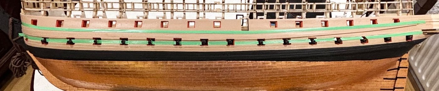

Next it was cutting away the horizontal brace parts on the starboard side between the gun ports and the upright hull framing, sanding down and painting the hull. In the video he doesn’t plank the small inner section at the bow or cut away the stern most horizontal brace, I could see no reason why, perhaps just an oversight, so I did both those things. Finally, using the paper templates provided, I mark and install the middle wale and paint the middle black “beeline”

For extending the pin vice, can you crimp a piece of brass tubing onto the handle? It may require you to remove the top end of the vice.
Allan, I'm very sorry to hear of your loss. My thoughts and prayers are with you. I'm glad you can get back to your modeling.
Your ship is coming along nicely and looks great.
Thank you for your kind thoughts
I did cut the handle end off which allowed me to fit it into another small chuck pin vice to give me the length required
