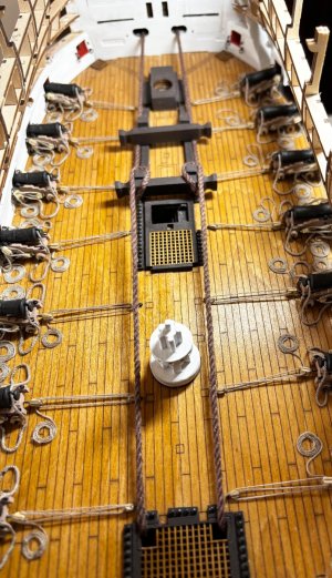

Hey Alan,
Glad you said that. I'll keep your tip in mind. Your deck really looks like madness. Thanks for showing it. I am impressed.

Thanks for the tips on the cannons and anchor rope. I received my kit and will be starting it this weekend. Hope mine turns out as good as yours . I will be watching and learning from your build log

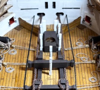

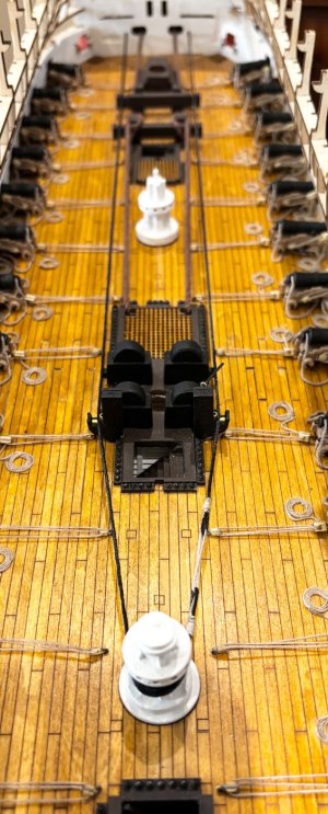

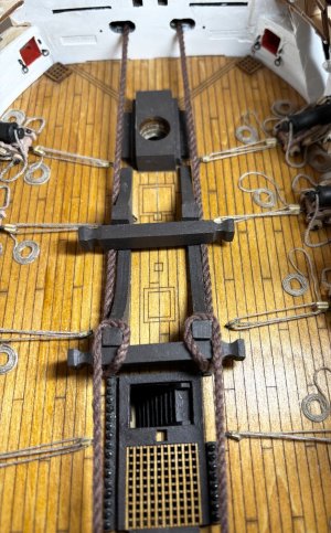

Instructions video #24 completed

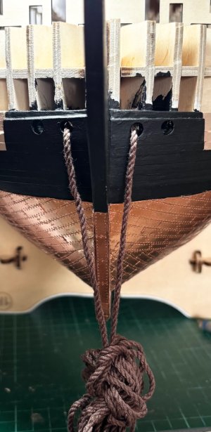

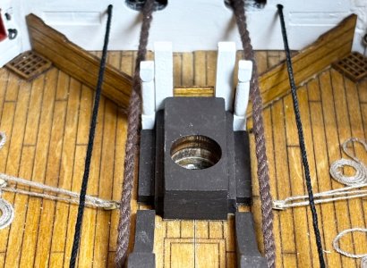

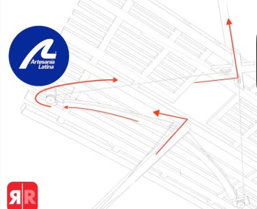

In this instalment I guide the anchor cables around the bits and out through the hawse holes in the bow
Construct the messenger cable and install it around the capstan and out through the pre drilled holes in the bow bulkhead (NOTE: In the video you are only instructed to harden the ends of the thread with CA glue to assist pushing them through the small holes,
I found that the way through was blocked by the wood pieces of the bow framework so had to drill though from the inside at a slight angle to make a route out for the threads)

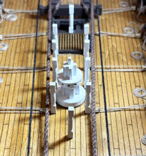

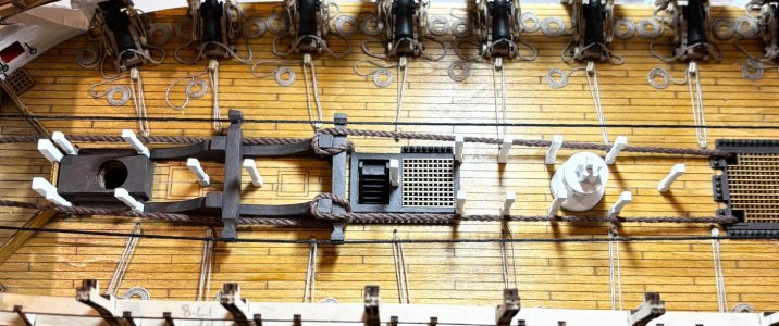

Next I stain and install the 3 boards that create the manger area at the bow.

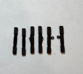

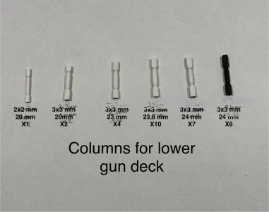

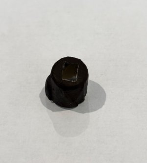

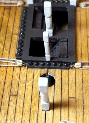

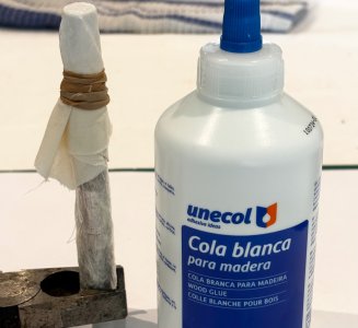

Next on to my mini lathe to turn 30 columns of varying heights and sizes to be placed on the lower gun deck.

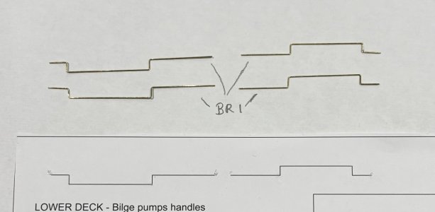

Finally I bend some 0.5mm diameter brass rod as per the templates to form the bilge pump handles then insert them in position.

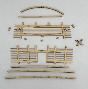

Instructions video #25 Part 1
I have taken quite a few photos so far in this instalment so I’ve decided to split video 25 into 2 parts

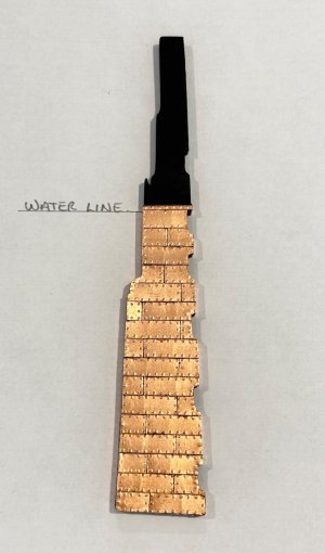

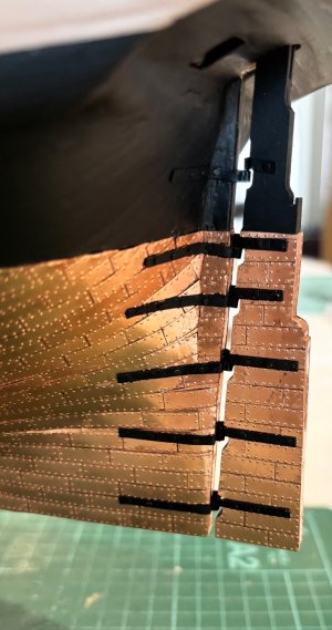

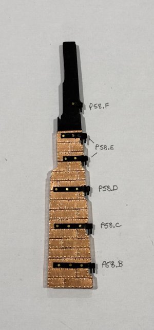

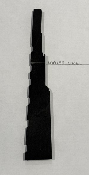

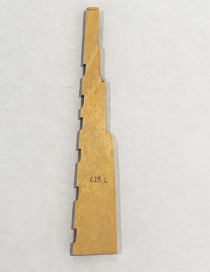

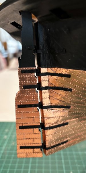

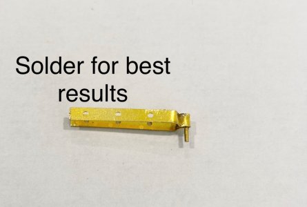

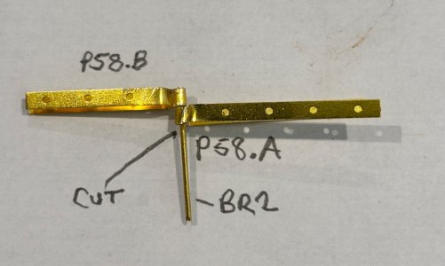

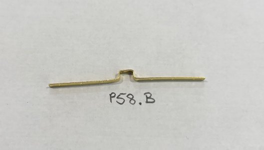

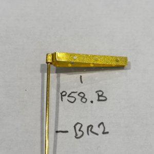

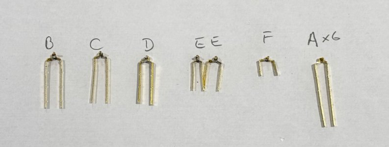

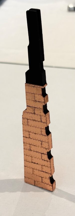

In this part I build the rudder and copper plate it. Make and shape the Gudgeons and Pintles, fit them in position and install the rudder in place.
Finally in this part I make and install the rudder’s gaiter. I was initially concerned that they did not included the spectacle plate at this stage, but fast forwarded several videos and see that it is included in the kit and is fitted at a later stage (video 50 I think) after attaching the chains to it.

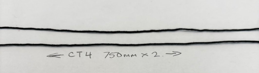

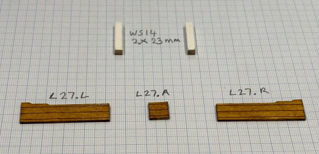

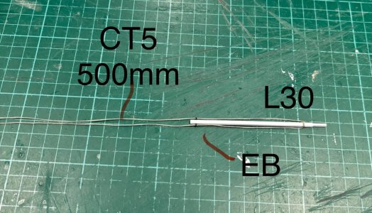

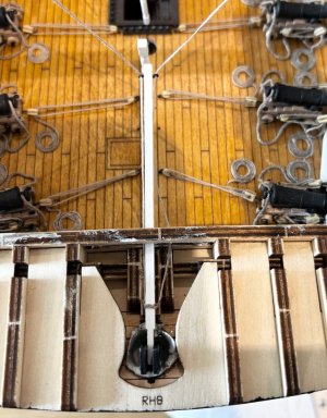

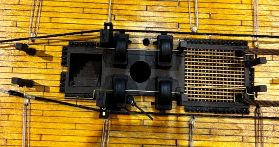

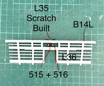

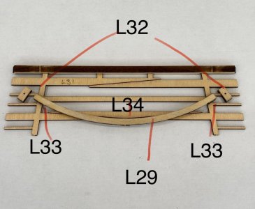

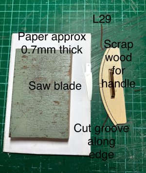

In this final part of video #25 I built the rudder steering gear. In the instructions it doesn’t tell you to glue the tiller (L30) into the slot in the top of the rudder, but I could see no reason not to, it also helps keep the tiller level when trying to pass the thread around the brass sheaves/blocks etc.

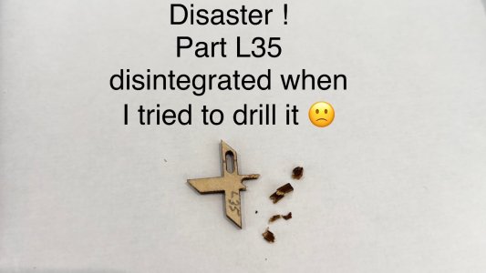

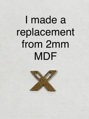

I had a disaster when trying to drill a hole in the edge of part L35, it basically disintegrated into many pieces!
I did email AL that evening and to there credit they replied next day to say they had shipped a replacement, but from experience of other deliveries from them I know it will take over a week to arrive, plus I was concerned that as it would be made from the same thin plywood, the same thing might happen, so I sourced some 2mm thick MDF and made my own replacement.
The rest was reasonably straight forward and hopefully the following photos will be self explanatory.

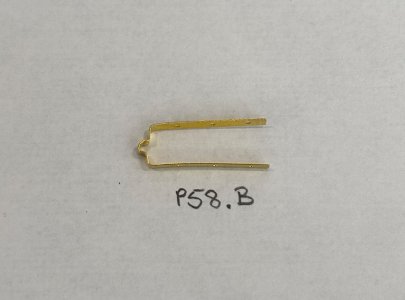

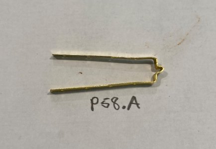

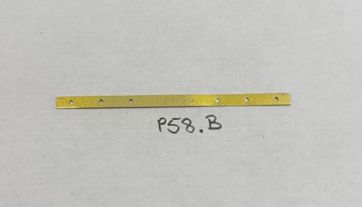

Hope you don't mind my asking but what is the width of the pintles and gudgeons? Thank you very much. '
Thanks, I thought they looked too heavy which I think is typical of AL and some other kits. From what I can find in several contracts they were 4.5" rather than the kit dimension of about 6.5"
The problem is Allan, kit makers have to be practical. Having a thinner strip of brass with several holes in it would make it more fragile and difficult to work with

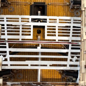

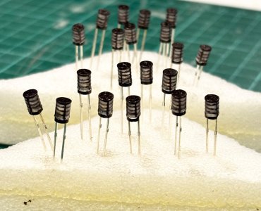

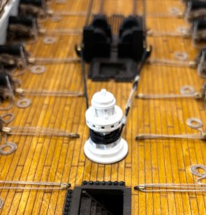

In this one I have to install the supporting beams for the middle deck, including all the LED lanterns and wiring. I’m away for a week or so so just tested the 20 LED’s required, fitted and painted the lantern covers. I will continue on my return.

Regarding the pintles and gudgeons, I have never had an issue with making them to scale using brass or copper. Drilling the 7 or 8 holes can be tricky but I do it after the parts are epoxied in place on the hull and rudder. A tiny dent with a pin or punch to make sure the drill bit does not wander should be done for each bolt location. Copper is softer and easier to work with and can be blackened after it is in place with a dab of diluted liver of sulfur.
I’m sure you can, and so could I probably if I really had to but kit manufacturers have to cater for all skill levels and to be honest, I’m happy with what is supplied

I agree and this can be seen in that they make kits for various skill levels. But, this does not mean they have to supply the wrong parts such as out of scale hinges, incorrect cannon sizes and patterns, belaying pins on ships that never had any, and the list goes on. Thankfully, there are now a couple kit makers that are offering kits based on thorough research and using their research to manufacture a first class kit. This is a win win for them and for us.

It seems to me that all you’ve done from the start is to pick holes in this kit.
If you don’t like the kit or my build, my I respectfully suggest that you unfollow it
