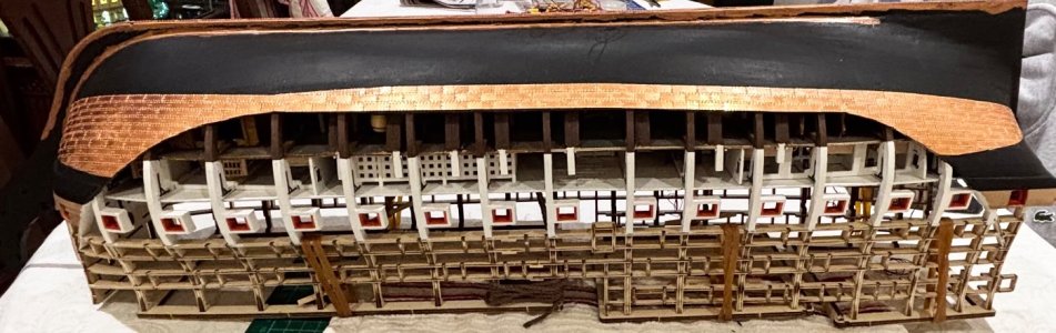

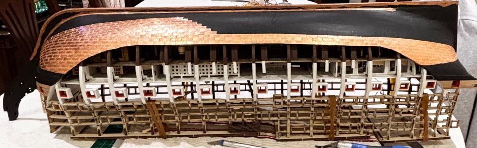

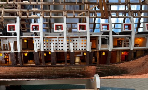

Instructions video #22 completed
Finally Thumbs-Up

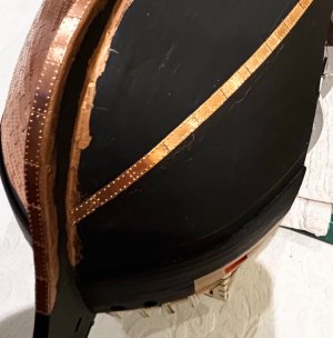

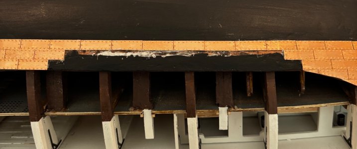

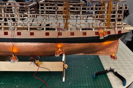

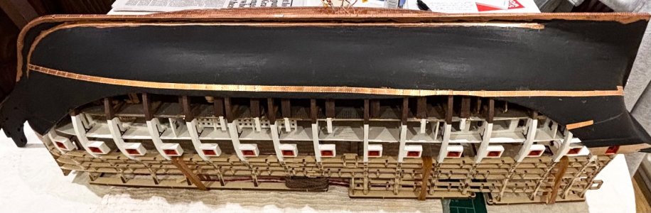

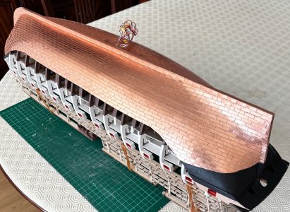

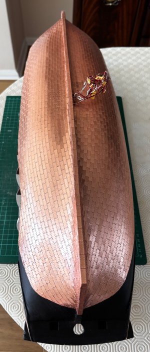

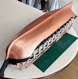

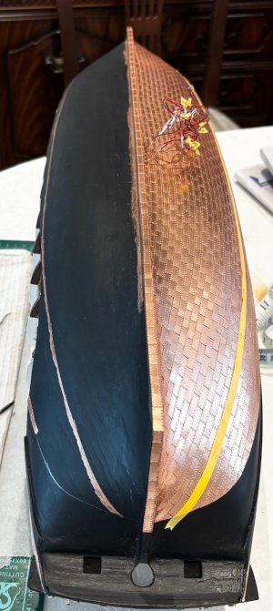

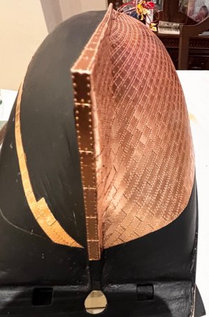

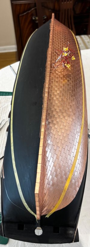

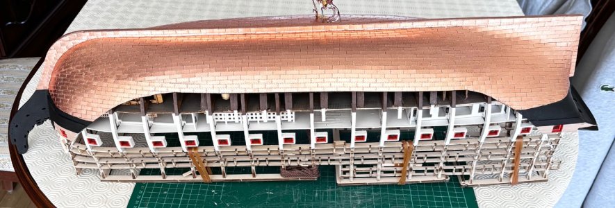

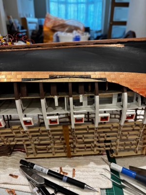

After many hours and many copper plates, north of 2,300 actually, finally finished the copper plates. When I started on the starboard side I wanted to achieve as close a mirror image as possible to the port side, but because of the hull cut out, I didn’t have the reference points along the waterline around midships that I used to start the plates on the port side. So I identified and highlighted the 10th row down from the waterline on the port side, this is the last row that goes the whole length of the hull before the change of direction and cut ins start. I then used a cloth measuring tape to measure down from the keel at about 25mm intervals, then replicated these measurements on the starboard side, that enabled me to mark a line in a similar position and used that line to install row 10 on the starboard side. From there I could install copper plates back up the the waterline and measure reference points along the lines to mark where the cut ins start and plate down towards the keel. Didn’t achieve a a perfect mirror image, but it’s close enough.

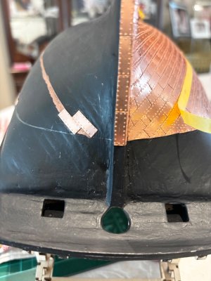

Towards the stern end of the hull cut out is a sort of dip in the line that had always looked ok when just painted, but when I started having to cut the copper plates around the sort of S bend it created, it started to look ragged and untidy, so I levelled it across so I only had one curve at each end of the cut out to deal with. Finally, on my own initiative, I decided to check the wiring to make sure no damage had occurred during the copper plating and all the previous sanding and planking works.
I will now have a little break before starting video 23 which will be the construction and rigging of 30 32ponder guns for the lower gun deck :eek:, so look out for my next post in about a year’s time :D

Great shots and really fantastic realisation. The copper plates are amazing. I can imagine that you need a break. But I forbid you to take a year off!!! Who am I supposed to learn from and copy how great the Victory is built? ;)Don't do that to me ...:eek:
But seriously, I think it's great to see your progress and also how you're approaching building the Victory. Also, I'm glad your Victory survived the spins and standing on its head well. I hope no parts fell out? I'm glad the wiring held up well too. Otherwise it would certainly have been difficult to check the wiring to see where the fault might lie.

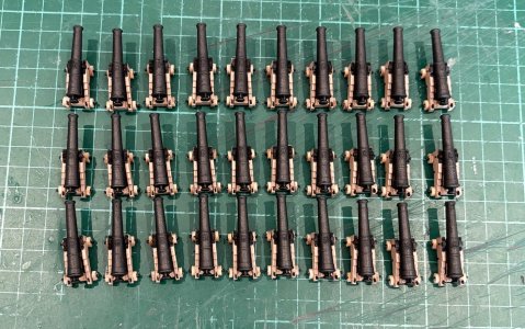

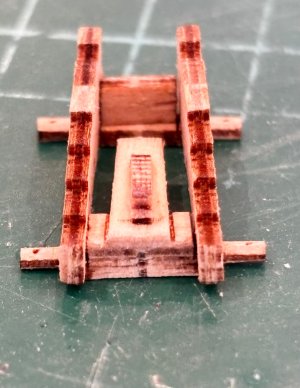

Instructions video #23 part 1

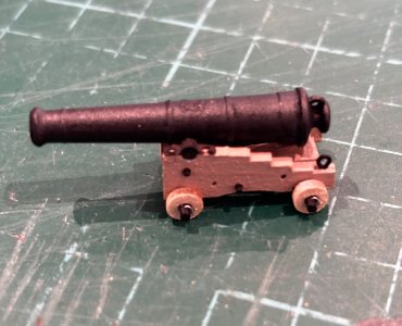

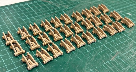

30 cannon complete
Blocks and tackles to follow

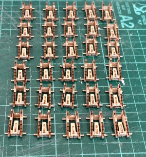

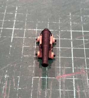

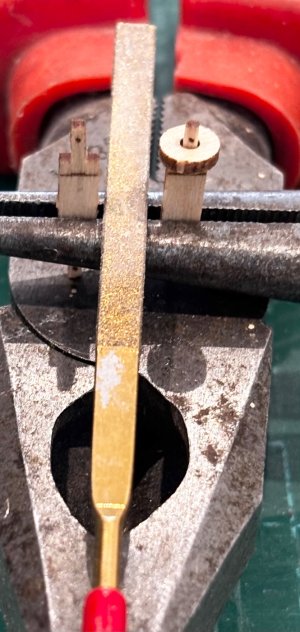

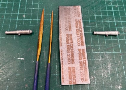

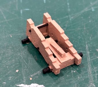

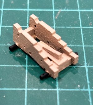

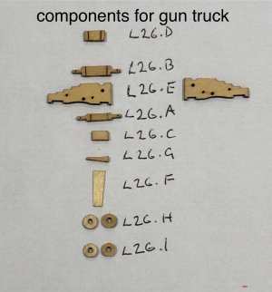

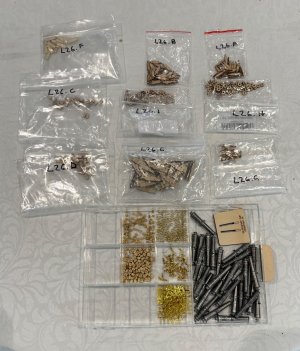

Like most modellers I would think, when confronted with multiple repetitive tasks, I like to work in what I call conveyer belt mode.
In this case, I removed, sanded/ prepared every component required for all 30 cannons before even thinking about assembly. I then did each construction step 30 times over until I have 30 completed units.

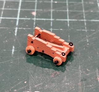

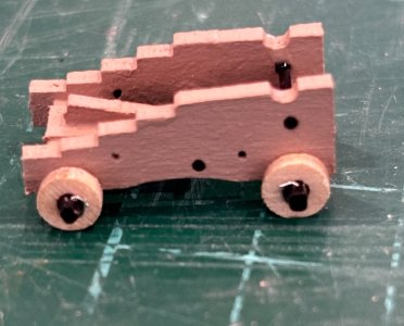

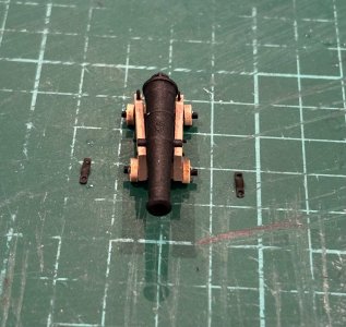

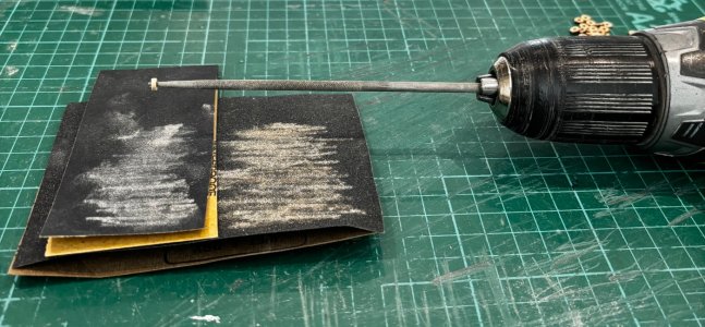

I changed the construction video instructions a few times to suit how I wanted to work, I used a rat tail file in a drill to sand down the carriage wheels, drilled the 0.5mm hole in the rear of the carriage before painting, and cut the brass rods to size before blackening, this took away the risk of scratching the paint if I was cutting them in situ as shown, and meant I didn’t have to touch in the ends with black paint. Also, I didn’t like the look of the wire holding the wheels so I cut it as short as I could and wrapped it around the axle.
Finally, I think, I put a spot of black paint into the holes in the trunnion caps. I have also added my own enhancement of the gun carriages by fitting the two eyebolts at the rear top of the carriage. Considering the amount of detail AL have put into these carriages, I’m surprised these were not included in the kit. I know they are not used, in fact I think I’ve only ever seen one photograph of them in use with the gun tackle, but they are still a prominent feature on the real carriages
Anyway, that’s about it, now on to the blocks and tackles , after a day off :D

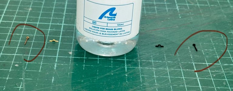

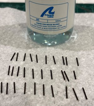

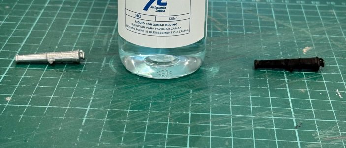

Quick question does that AL bluing liquid also leave your fingers all black - I've used something else (forgot the name) but a real mess to use
requiring washing the parts after - hence also the blackened fingers.

It does work quite well, I always soak parts in acetone first then rinse and dry before using the blackening liquid I find that helps it adhere better. But you do get some come off on your fingers , I’ve never washed the parts after blackening, perhaps I’ll try that

The kit includes all the LED’s required for the ship, 122 I think, also wiring switches, battery holders (power supplies) and solder

really very impressive how you build them. The copper ring is world class. Respect. Can I ask how much the copper plates cost? Here in Germany, 100 pieces in this size cost 8.20 euros. You're right about the burnishing. It gives you black fingers. Because the surface is anodised. You should wash it off. Especially as, if you don't, you may end up with white spots that look really unattractive.
I pull my chair even closer to the table so that I can watch you closely. It's really fun to marvel at the progress you're making.

Hi Günther
Thanks again for your comment
I think I was paying around £5.25 for 100 (around 6 euros ?). I purchased 25 bags (still need some for the rudder) so I’ve spent about £130 on the plates. Did I mention in my post that in each bag of 100 you’ll find 15 to 20 that aren’t stamped out correctly, you can use some of these for off cuts etc but still a fair bit of waste. I didn’t do an exact count but calculating from how many I have left I have used about 2,350 plates

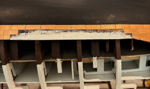

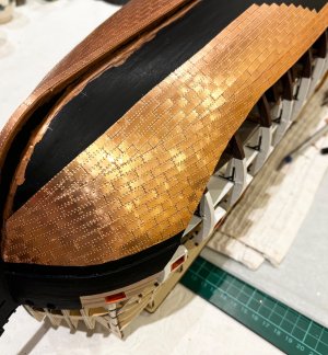

It may just be the lighting in the photos but are they upside down? The plates were nailed on so there would be dents where the nails were hammered in rather than the appearance of rivet heads.
You folks doing the lighting amaze me. I guess we can all do it but I am totally intimidated by this. Nicely done.
No, it’s supposed to be rivet heads
Not prototypical but gives a nice effect. All commercially made copper plates are like that as far as I know
