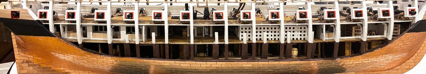

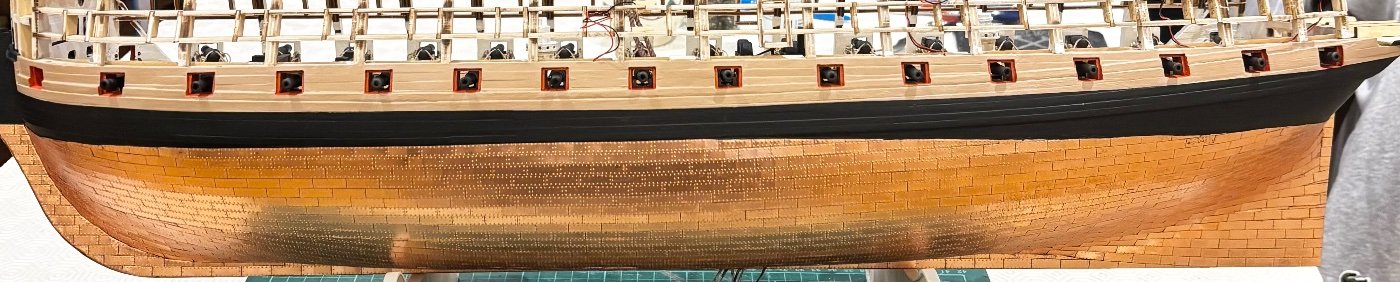

You folks doing the lighting amaze me. I guess we can all do it but I am totally intimidated by this. Nicely done.
It may just be the lighting in the photos but are they upside down? The plates were nailed on so there would be dents where the nails were hammered in rather than the appearance of rivet heads.
Hey Alan,
Thanks for the reply. That's quite expensive. The work alone is insane. You have my respect! I also bought the kit. Also the roller for the copper foil. I'm going to try it out and then decide whether to buy the copper plates or use the foil. I would be happy to show you a picture of it. As for your photo of the Victory, where did you find it? I'm confused at the moment, because I feel the same way as you do, that the nails were hammered in and thus countersunk and no rivets are visible, but recessed. Or am I wrong?
Best regards
Günther Ship-1
Hi Gunther
The photo is the USS Constitution, but it is pretty much identical to the description of plating given by Peter Goodwin in The Construction and Fitting of The English Man of War on page 225. After about 1760 the nails were copper with typically 5/32" diameter with 5/16" heads assuming he is correct. Manufacturing limitations apparently were the governing factor in the plate size which was typically 48" X 15" Victory was not coppered until a refit in 1779. I love to see someone model Victory prior to this date with payed bottom, Armstrong cannon and painting other than the Nelson chequer.

No, it’s supposed to be rivet heads
Not prototypical but gives a nice effect. All commercially made copper plates are like that as far as I know

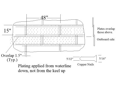

Vanguard and, I think the newest ones from Amati, have etched nail dents rather than the pox like bumps. Hopefully some members know of others as well. Scale is an issue as well so some folks have had more realistic plates by making their own. At the smaller scales, copper paint, scribed lines, and pin holes are another option. Assuming the AL Victory scale is 1:84 the plates should be 14.5mm long X 4.5 mm if they are going to be properly overlapped. If the builder chooses to butt them together they would be about 1/2mm smaller in width and length. If appearance matters, check out the patterns of both brands and how the full size plates were actually done to see which you think is best for your own project.

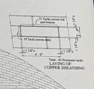

From drawings in The Construction and Fitting of the English Man of War by Peter Goodwin
Hi Allan
This is from the book “HMS Victory, her Construction, Career and Restoration “ by Alan McGowan. I used this as a rough guide for installing my plates. If you’ve read my original post on this, you will know that I’m aware of the scale issue. Using these plates was my personal preference over the supplied self adhesive tape. I’ve seen many photos of other completed Victory models using these or similar plates, all showing the “pox” bumps as you call them. I like to do a nice job but on some things I’m not a rivet counter, excuse the pun :D

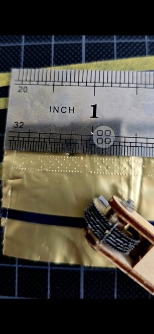

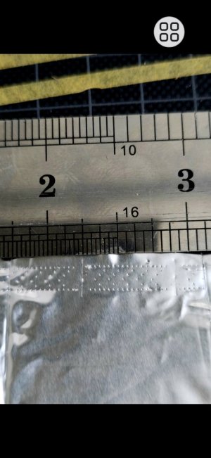

Hello Alan,
thank you very much and very good picture of the copper plating. I have some pictures of a sample of the AL roller to imitate the nailing. I think it is very close to the one above. What do you think? However, the dimensions are not correct based on your calculation. So the aluminium roller is too big.
Best regards
Günther Ship-1

Hello Alan,
Best regards
Günther Ship-1
View attachment 535040 View attachment 535041
Hi Gunther
Sorry for late reply to this, but yeah, the roller seems to make the plates longer than they should be. Also, if my drawing from the book is correct, you should not have nails in the middle of the plate either. But at the end of the day it’s your model for you to decide which way you want to go

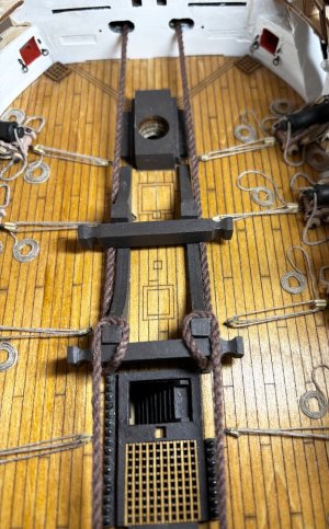

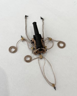

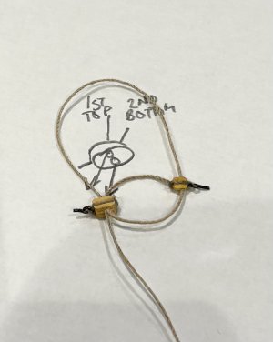

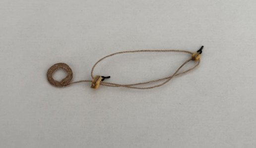

I now tackle (excuse the pun) the blocks and tackles

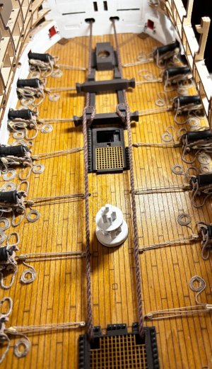

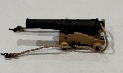

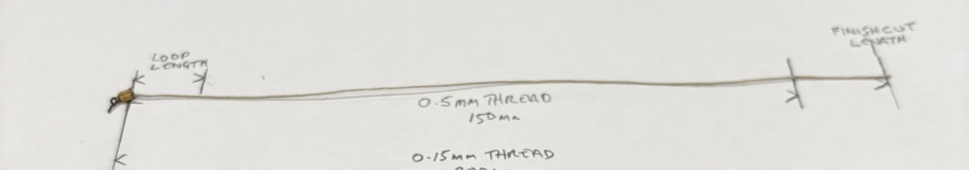

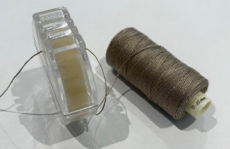

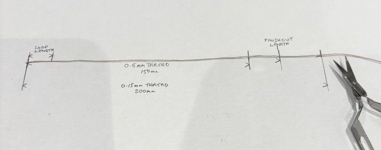

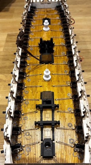

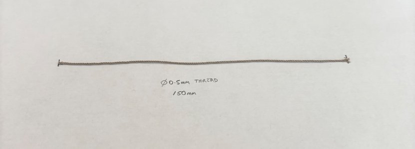

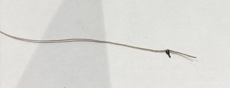

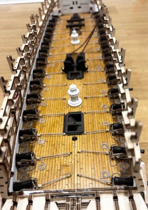

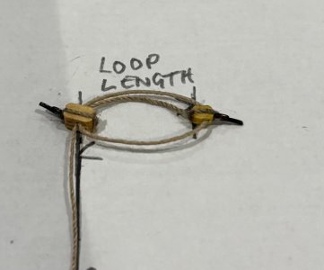

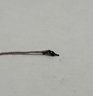

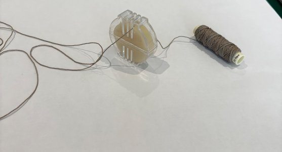

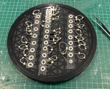

As before I adopted production line mode, and rigged all 30 cannons before placing any on deck. I made myself a little measurement rig so that all threads etc would be approximately the same. Before cutting the threads I pull them through bees wax, which helps stop them fuzzing. I decided not to follow the instructions and made rope coils on the ends of the tackle ropes, a lot more work but I felt it was worth it.
Once I started to rig the cannon it became clear that the 0.5mm holes we are told to drill in the back of the gun carriages are not big enough to take the pin of part EB, the pre-drilled holes in the side of the carriages should have been a clue, so it follows that the holes drilled around the gun ports in video #17 would not be large enough either, so I had to revisit the gun port holes and enlarge them, not so easy with the capstans and other deck fittings now in place. So if you are doing this kit and haven’t reached video #17 yet, ignore the instruction to drill 0.5mm holes and drill them 0.7mm instead, likewise the holes in the back of the gun carriages.

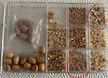

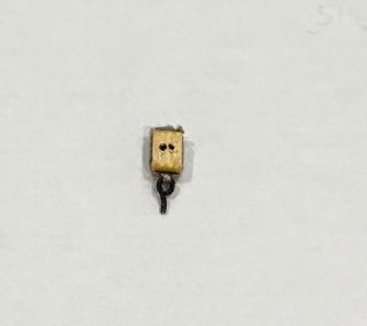

Hi Alan, I am also up to this stage of making the block and tackles. My question is did you make the small wooden 'block' parts yourself as I cannot seem to find these parts in the kit. How did you fashion them? Thanks so much. Love your work. Tony M
Hi Tony
All the wooden blocks are located in one of the clear plastic parts containers
I didn’t think much of the quality of the smallest single hole blocks, some didn’t have holes in them and I found I had to enlarge the holes to pass the thread through them even using a “Big Eye” needle
Hey Alan,
great work. That looks fantastic. beautifully clean work. I still have the Vici lying around. But it will have to wait. really very nice. Question: Where did you get the part with the beeswax? I think it's great and would love to have it too.

Can’t remember exactly where I got it, was a long time ago, but as RussF said, any sowing shop will do
Hey Alan,
Thanks for the tip. I ordered it straight away yesterday. Really good idea. It makes waxing the ropes much better and cleaner. Your cannons look fantastic, very realistic. I'll remember your tips for building the Victory, including the one about drilling the holes in the bulwark larger. I can make good use of that. You build so neatly and accurately. I hope I can do the same. I'm already looking forward to more pictures.

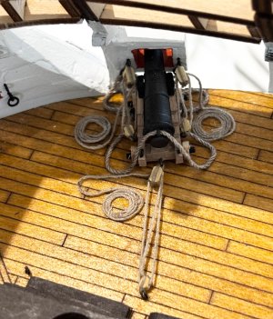

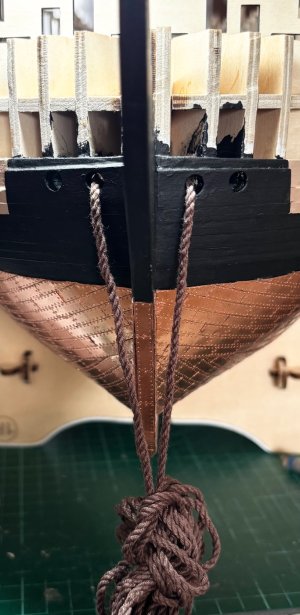

Another issue came to light yesterday, so just another quick tip before anyone gets that far
Back in video #14 we are instructed to cut 2 lengths of CT1 at 1000mm each for the anchor cables, which I did, laying them on the orlop deck with the same lengths and amount of coils as shown in the video
After completing the first steps in video #24 I was left with only a couple of inches of CT1 hanging through the holes in the bow compared to the video having what seemed like a fair bit more. I assume that these cables will have to go up around the cat head then loop down and be attached to the anchor, and I felt there was nowhere near enough to do this. So to get around the problem I glued the threads behind the holes in the bow while keeping tension on them with weights, once dry, I cut of the threads then inserted and glued each end of the remaining CT1 in the kit into the port and starboard holes leaving it in a large loop to be cut at a later date when I know exactly where they are going. In short, if you haven’t reached video #14 yet, save yourself some hassle and cut the CT1 lengths at least 1200mm, or just cut all the CT1 in half
