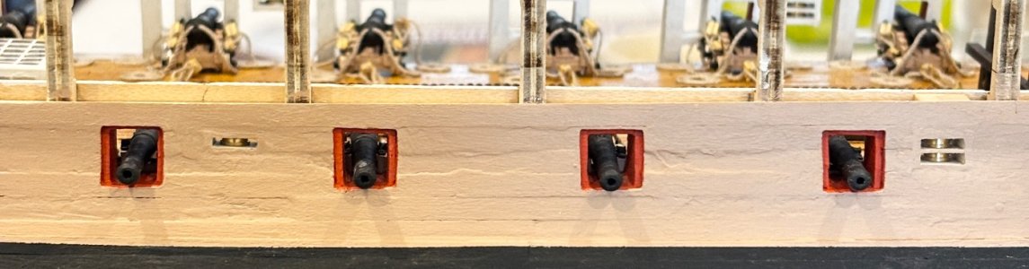

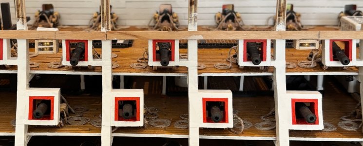

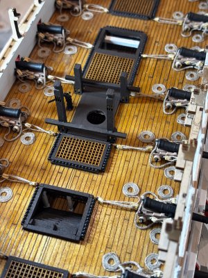

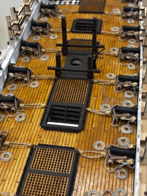

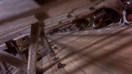

Not going to change them nowHello Allan, you are right! The blocks are all turned upside down. Sorry to say, but these blocks are scrap, and I don' t understand why AL - and other kit manufacturers - provide such blocks with their kits. I would never use them but buy proper scale blocks instead.
Werner
ThanksHello,
I suggest blocks from drydockmodelsandparts.com or syrenshipmodelcompany.com
Yeah of courseHello Alan, of course it is the price......if you think that on a fully rigged e. g. Victory model there are hundreds of blocks of all sizes for the guns and the running rigging, it is a matter of cost, and providing hundreds of high quality blocks in one kit makes a kit probably unaffordable to one or another builder. I had the same issue with my Confederacy from Model Shipways, and I replaced all provided blocks for the gun tackles with blocks from syrenshipmodelcompany, and it makes a difference......
kit manufacturers supply poor quality blocks, the price
Tell me about it. ALL THE GUNS on the Sovereign are fully rigged!Yeah of course

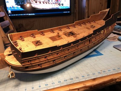

The fact that this is the Anatomy version where every one of the 104 guns is rigged, ( that’s over 600 blocks just for the guns), the cost would be astronomical
Its cost me over £70 (including shipping) to get some nice blocks from Syren, but I don’t mind making the effort for the more visible guns

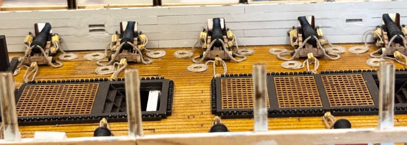

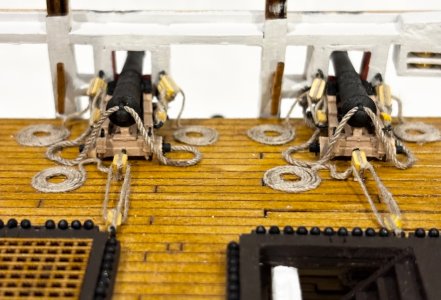

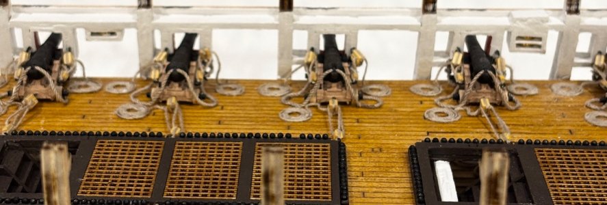

Brilliant! Thanks for that great explanationRope Coils

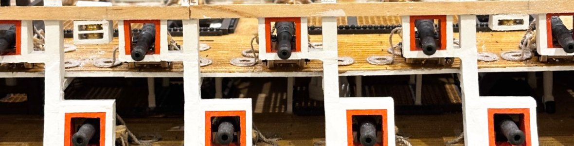

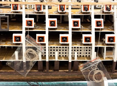

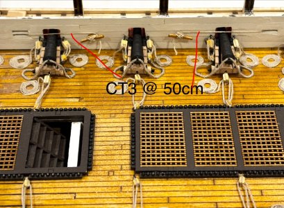

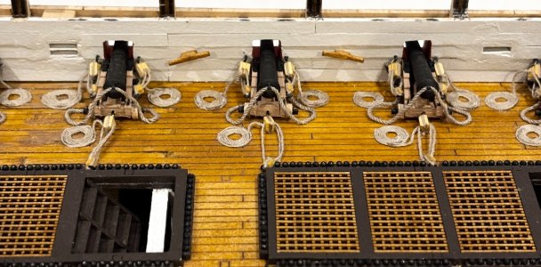

Following my last post, TonyJ asked me to describe how I do the rope coils. I know Tony is a fair way off from doing any guns so I was going to do it when I got to my next batch of guns, but it occurred to me that some others may wish to see it, so here goes
First off I would like to say that I don’t claim total credit for this, I have watched a few videos on YouTube and cherry picked the bits I liked and adapted it to the way I wanted to work. I will number the stages of the process followed by numbered photos
1. Start off by getting a piece or flat smooth plastic,( I use the lid from one of the components boxes supplied with the kit) and stick lines of double sided tape to it. Obviously it can be as big or small as you want depending on how many you want to do in each batch. From what I’ve seen it appears that most modellers make the coils as a stand alone item, as I’m doing in this demo, then attach them to the deck adjacent to the guns to give the desired effect
I decided to do the coils on the thread attached to the block a tackles which I thought was more prototypical. If you do the same, you will need to leave spaces between the rows of tape to lay the block and tackles while you carry on working.
2. Remove the top cover of the double sided tape on the upper row and place a circular former in the centre of the tape at one end
The former can be anything you want depending on the size and scale of your coils
I actually used a spare gun carriage wheel and sanded it down as small as I could without it breaking, then gave it a coat of varnish to aid constantly moving it on and off the tape and to prevent the thread trying to attach itself to it.
3. Place your length of thread at the top of the former and make sure it’s stuck well to the tape.
4. Using a pair of tweezers, start coiling the thread around the former, making sure it stays tight and close as it circles.
5. Once you’ve reached your desired size, remove the former and place it further along the tape ready to start your next coil. Flatten the coil you’ve just made down onto the tape using the flat end of the tweezers.
6. Once you’ve done all the coils in your batch, brush in a 50/50 mix of white glue and water and leave till fully dried.
7. Once dry, scoop the coils off the tape with a wide enough blade.
8. If all has gone to plan, the underside of the coil that was against the tape should not be discoloured and that’s the side to face upwards on the deck.

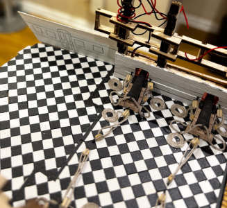

9. Here is one of mine made on the block and tackle. If you do them like this you will find that once the gun is fixed to the deck and the slack taken up on the block and tackles, you will need to do some coiling and dressing of the thread to loose the excess length.
I hope some of you will find this helpful

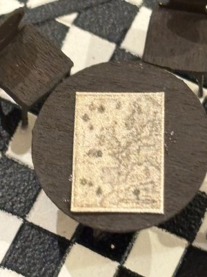

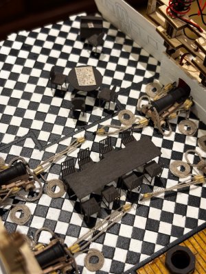

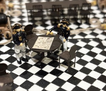

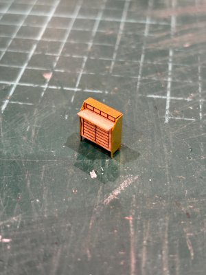

PS: Did that table map come with the kit -- very cool!!!
