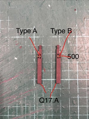

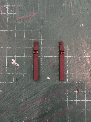

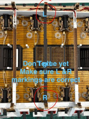

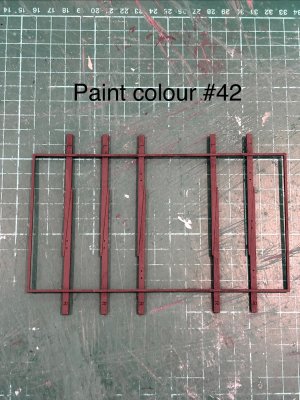

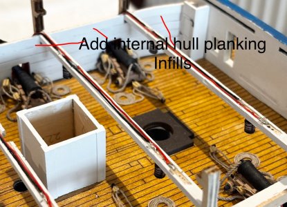

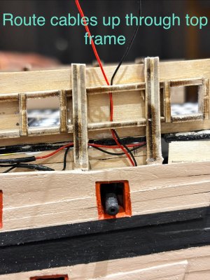

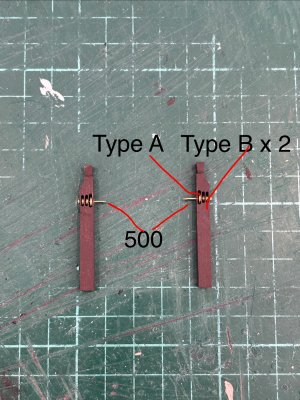

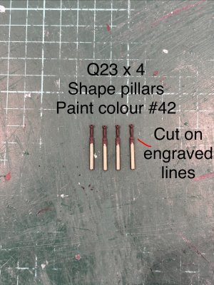

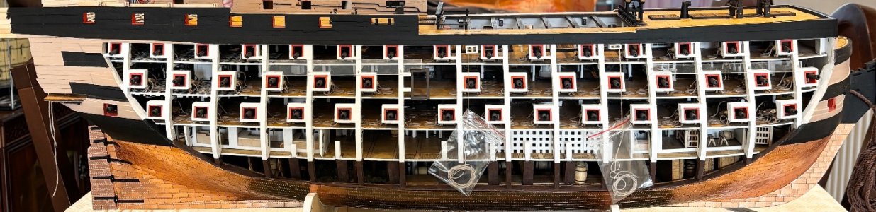

In this final part I form, paint and place the pillars on the upper gun deck then prepare and paint the supporting beams for the quarter deck before making and fitting the led lanterns to them and fitting them in place on the ship. Routing the wires is different this time, previously the frame timbers were drilled through to the outside then notched out to allow the wire to travel the length of the hull keeping within the space created by the inner and outer planking. This time a notch is made at the end of each beam for the same purpose, I assume that this is because the frame timbers, especially towards the bow are getting thinner now. You still need to drill through the frames to route the cables but with these thinner frames I’ve drilled 2 smaller holes for each individual wire instead of one larger hole as I’ve done before. You may notice that I haven’t painted the central section of 3 of the beams, that’s because in the next video instructions they are cut out to form the waist/skid beam area.

Hi Glenn
I use CA too and don’t have any issues, perhaps it’s the type or make that your using

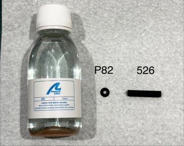

I use this (picture below) it’s not cheap but comes in 3 types , thin medium and thick for different applications, I mostly use the thick as it stays where you put it

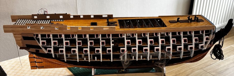

Instructions video #34 completed

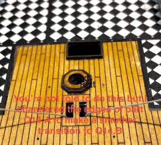

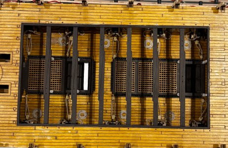

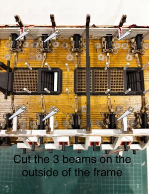

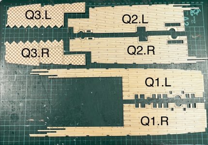

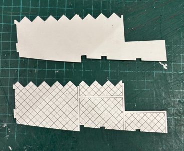

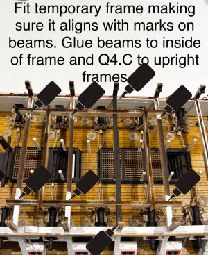

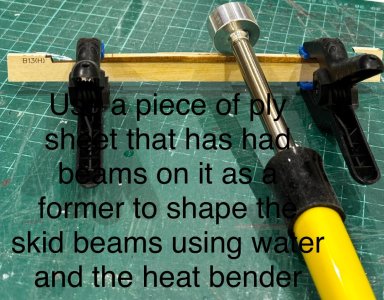

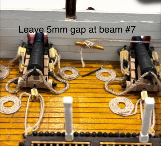

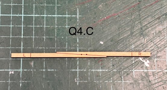

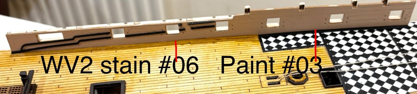

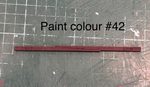

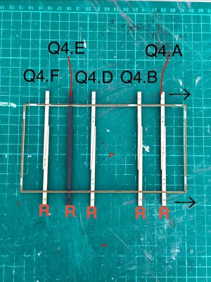

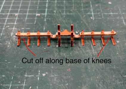

In this video instructions I paint and fit the inner hull planking on the port side in between the beams fitted in the previous instalment. Then, (using a piece of one of the kits laser cut sheets that had beams in it) put a curve in the skid beams. Skid beam Q4.C is placed in beam #7 location and using a neat template, that has to be constructed, I cut out the centre sections of beams 6, 8 and 9. Another jig is made to which the other 5 skid beams are attached, the assembly is then painted and fitted into the space created using skid beam Q4.C to position it correctly

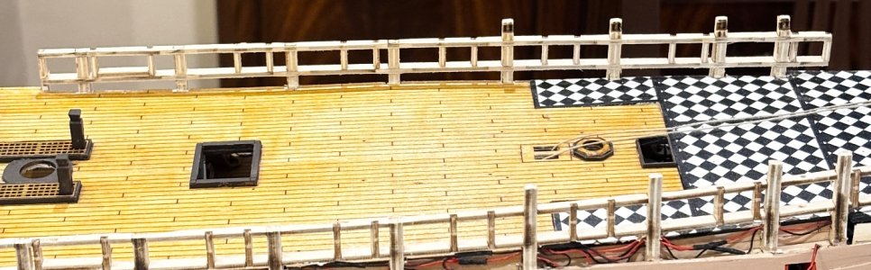

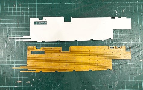

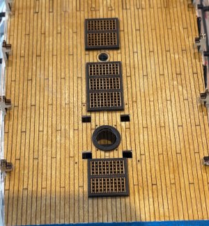

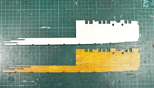

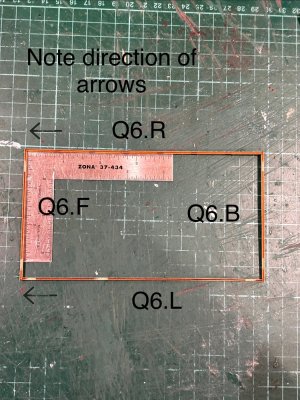

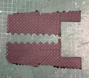

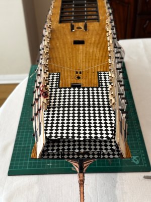

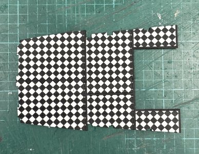

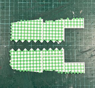

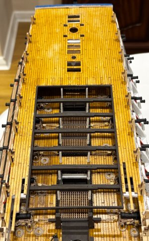

Finally in this instalment, I prepare and fit the quarter deck sections, I definitely won’t miss having to create any more of those chequer board patterns

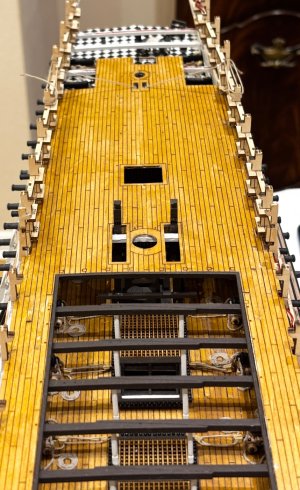

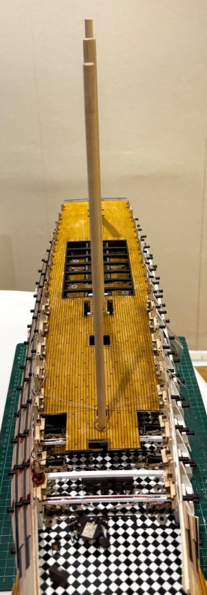

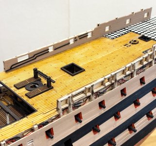

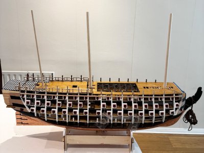

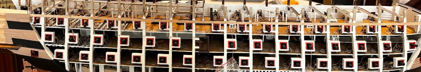

Although at every deck level I have test fitted the masts to make sure all the deck holes lined up I’ve never actually checked the rake (angles) of them

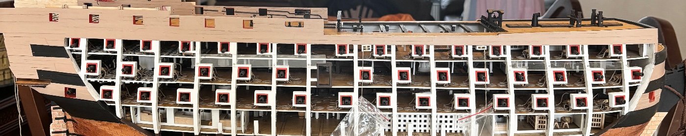

Now that all decks (apart from the poop) are in place, I’ve had a look at it and I’m fairly pleased with the mast alignment throughout the length of the ship and the rakes.

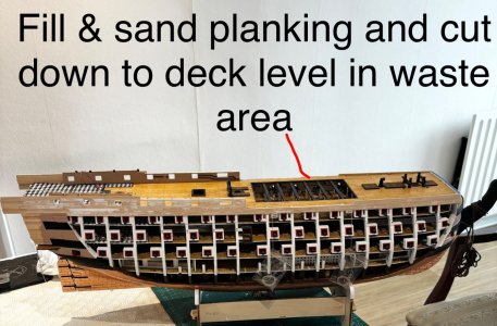

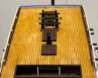

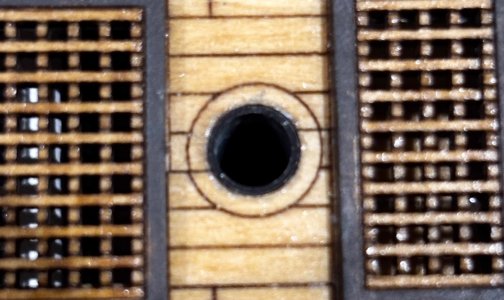

Instructions video #35 completed

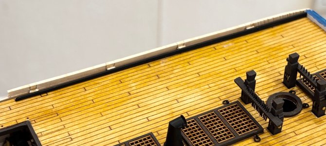

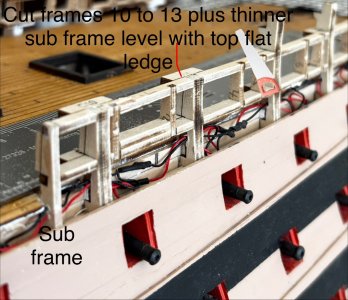

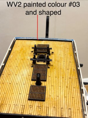

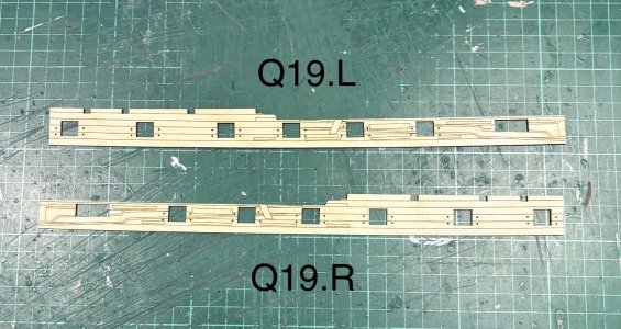

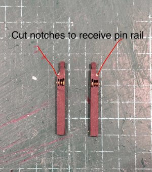

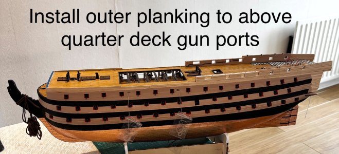

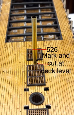

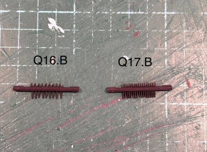

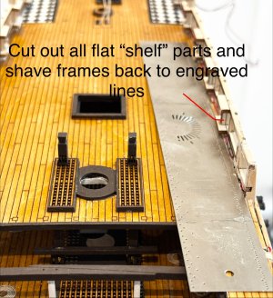

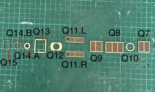

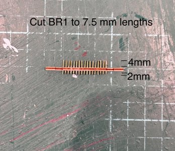

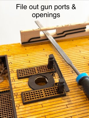

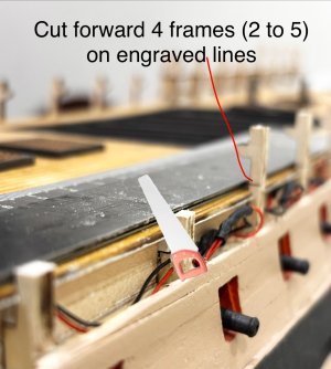

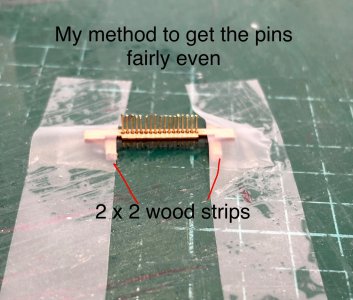

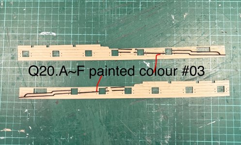

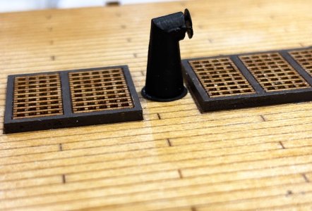

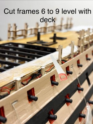

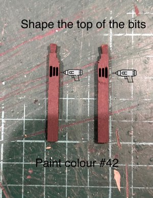

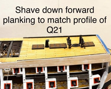

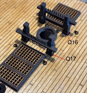

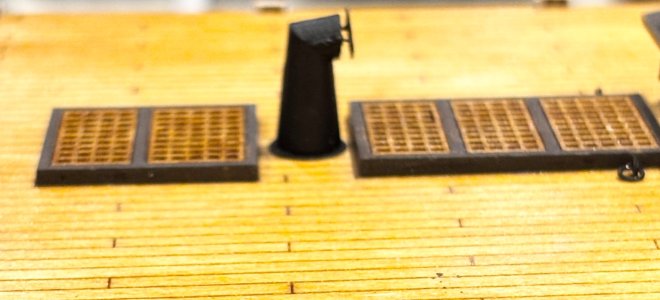

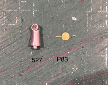

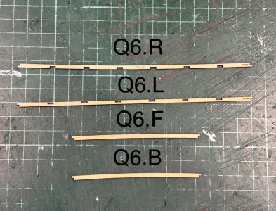

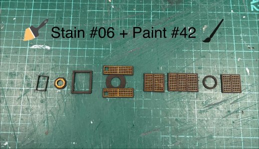

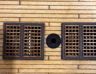

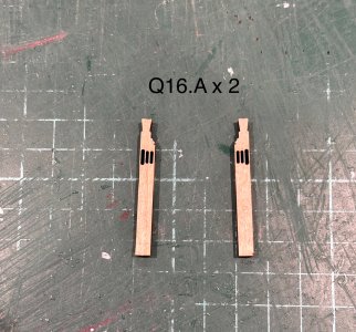

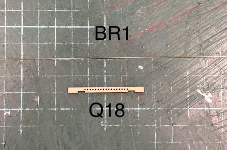

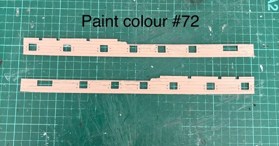

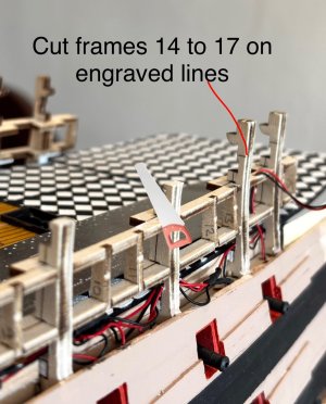

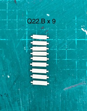

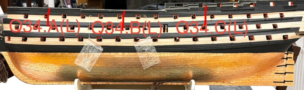

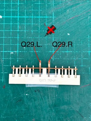

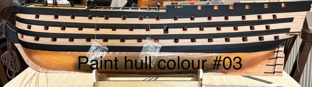

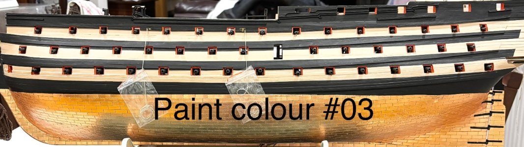

In this instalment I prepare and fit the various gratings and mast surrounds etc, for the quarter deck,then make and install the stove chimney. I then have to cut down the ships frames to various heights along the length of the deck. Next I make the pin rail for the main mast and the bits and pin rails for the fore mast. Then fit the inner and outer planking to the quarter deck up to a height just above the gun ports. Next fill and sand the outer planking, then the difficult operation of shaving/ sanding the planking down to various heights along the length of the ship. I must say, if I had to do this again I would attempt to cut the planking a lot closer to its finished position while installing it , as it’s not as easy as he makes it look in the video and also the possibility of damaging the deck, which I did slightly on the port side, but luckily it would appear to be inside the confines of a future cover piece.

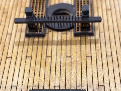

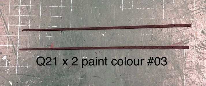

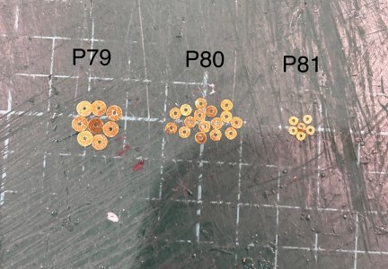

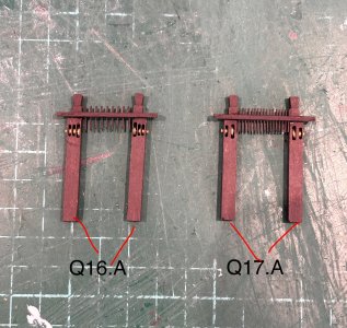

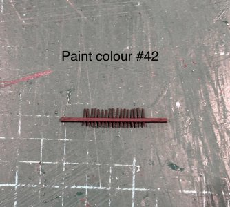

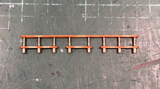

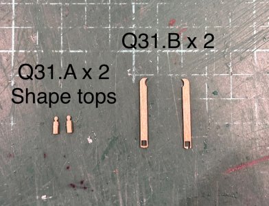

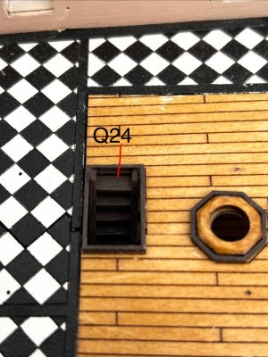

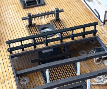

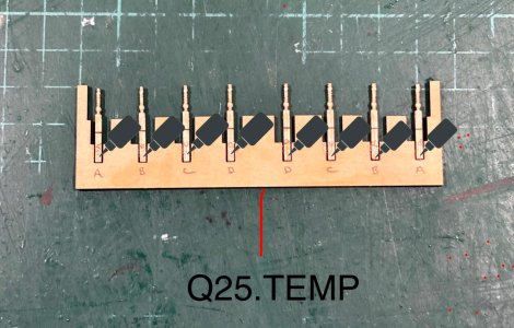

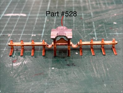

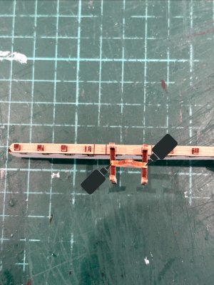

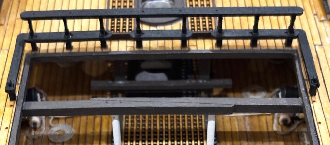

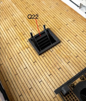

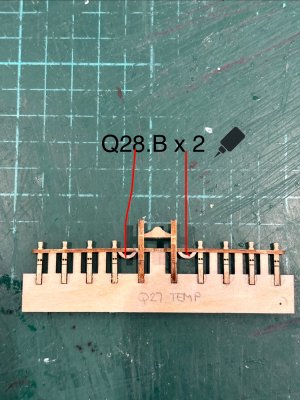

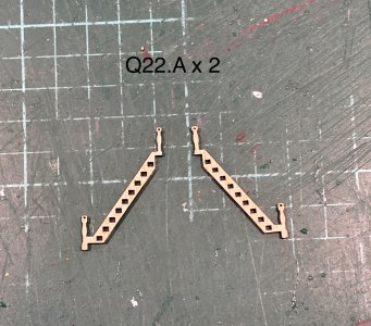

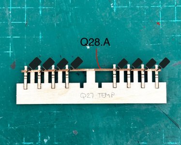

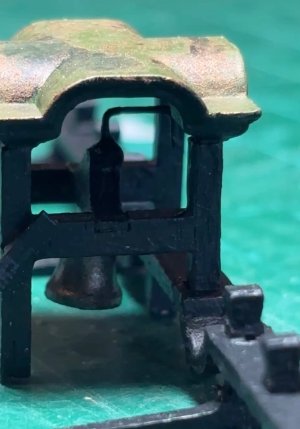

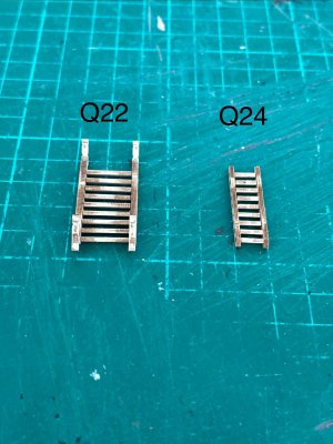

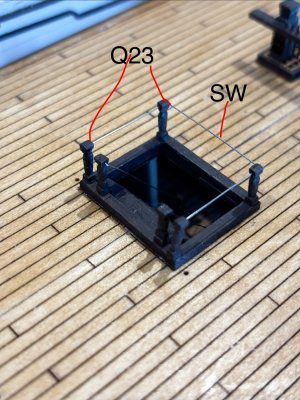

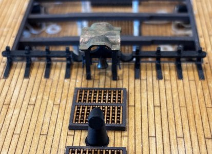

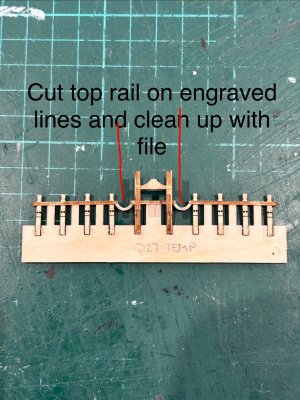

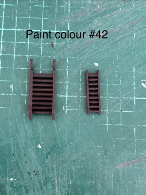

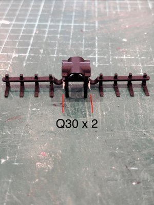

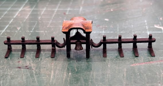

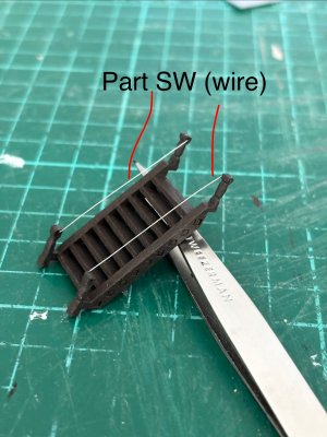

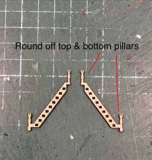

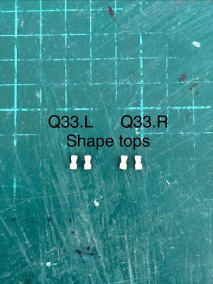

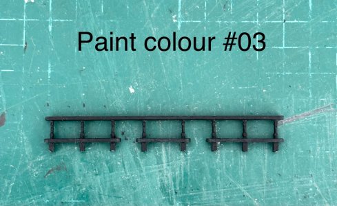

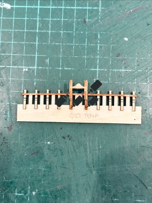

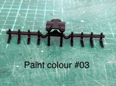

In this part I construct and fit the stair and ladder leading down to the upper gun deck. Next I build the rails fore and aft of the waste area, including the belfry. I didn’t want a shiny brass bell as the video depicts as I’m sure it would not be like that, and it certainly wasn’t on my many visits to Victory over the years, so I used a photo of me by the belfry as reference and mixed some paints to give me a dirty metallic bronze colour. I also coloured the canopy top with copper paint and added some patina green weathering
I also included another “I know it’s there “ item by fitting the bell crank that I made from small brass wire

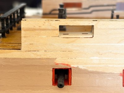

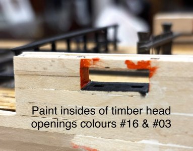

Then I make and fit the riding bitts in the upper hull rectangular openings.

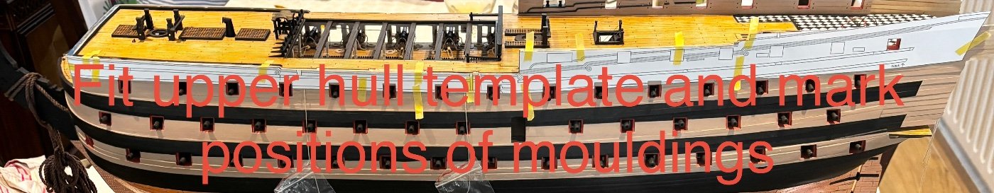

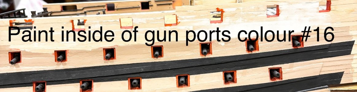

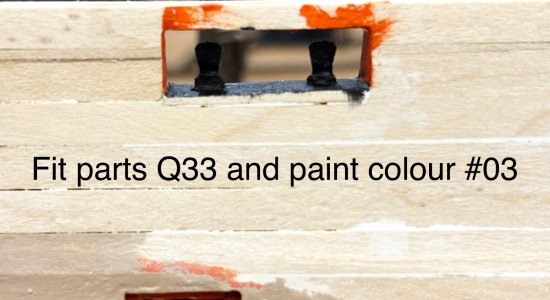

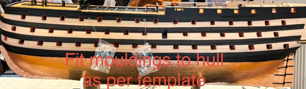

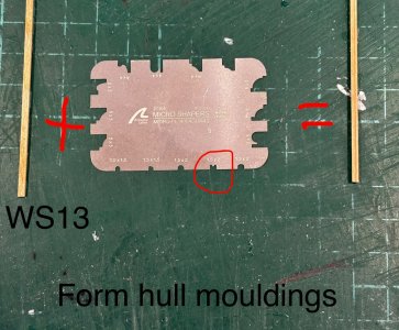

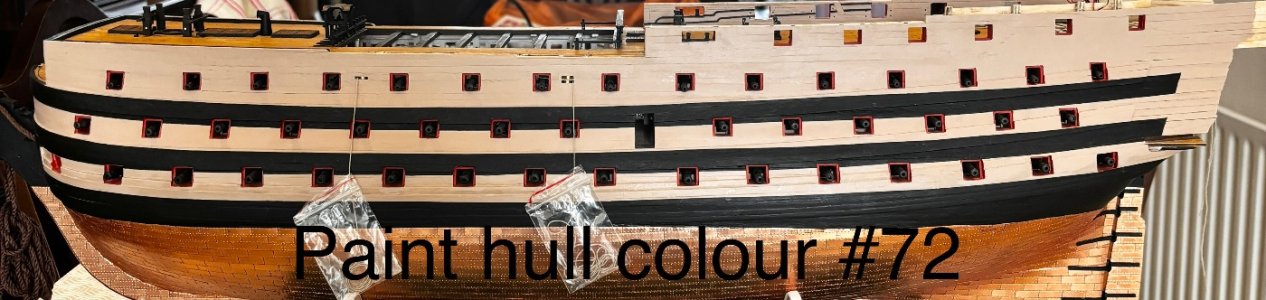

Finally it’s painting the upper hull , making and fitting the various mouldings along the upper hull sides.

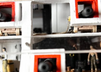

Instructions video #23 completed
I now tackle (excuse the pun) the blocks and tackles

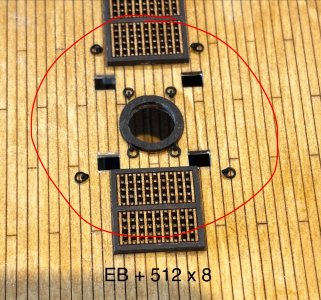

As before I adopted production line mode, and rigged all 30 cannons before placing any on deck. I made myself a little measurement rig so that all threads etc would be approximately the same. Before cutting the threads I pull them through bees wax, which helps stop them fuzzing. I decided not to follow the instructions and made rope coils on the ends of the tackle ropes, a lot more work but I felt it was worth it.

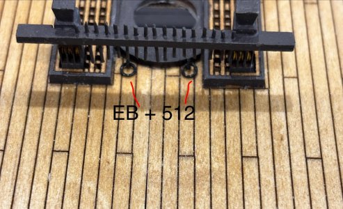

Once I started to rig the cannon it became clear that the 0.5mm holes we are told to drill in the back of the gun carriages are not big enough to take the pin of part EB, the pre-drilled holes in the side of the carriages should have been a clue, so it follows that the holes drilled around the gun ports in video #17 would not be large enough either, so I had to revisit the gun port holes and enlarge them, not so easy with the capstans and other deck fittings now in place. So if you are doing this kit and haven’t reached video #17 yet, ignore the instruction to drill 0.5mm holes and drill them 0.7mm instead, likewise the holes in the back of the gun carriages.

The length of the loop for the side tackles that attach to the hull is approximately 13mm, the rear tackle that attaches to the deck is approximately 24mm. Note: they all need tensioning once the guns are in position
