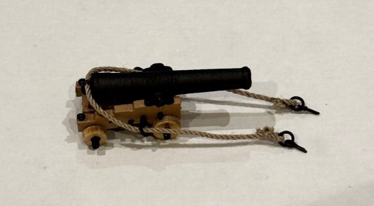

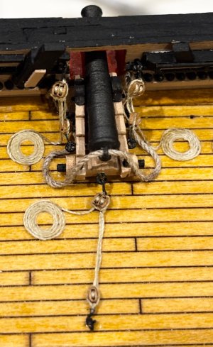

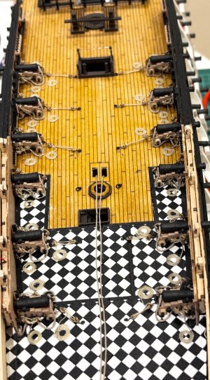

The length of the loop for the side tackles that attach to the hull is approximately 13mm, the rear tackle that attaches to the deck is approximately 24mm. Note: they all need tensioning once the guns are in position

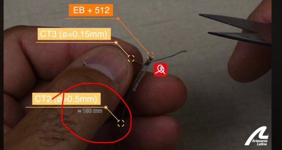

Thanks for the feedback. How long is the cannon hoist?
What do you mean by the cannon hoist ?
If you mean the breaching rope that goes through the breaching ring at the rear of the gun, I make mine about 90mm once completed and tied to the ring and eyebolt
The instructions tell you to start with a length 150mm long
Yes, thank you, just that one. Where is it said in the instructions that the length is 150mm? Anyway thanks again for your availability

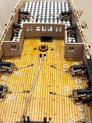

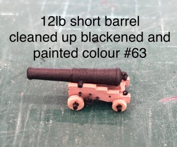

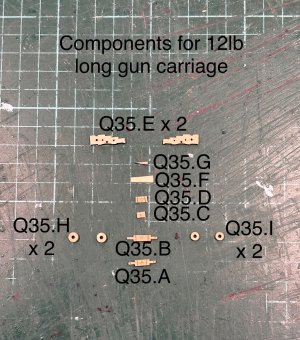

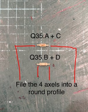

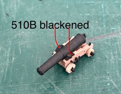

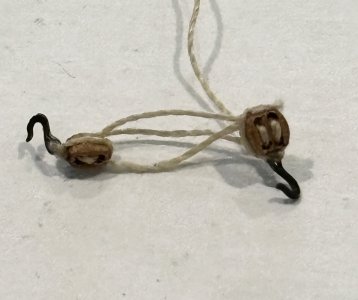

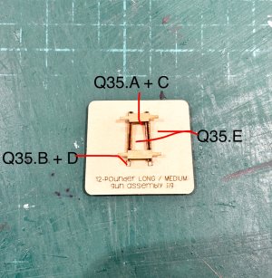

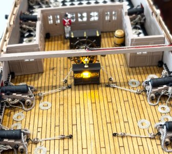

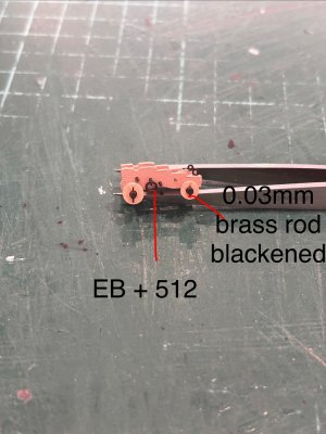

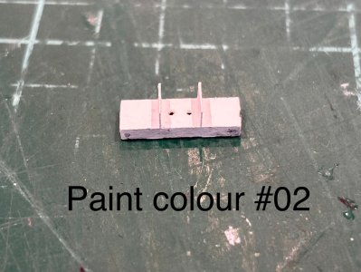

First off, apologies for taking so long to post this next stage

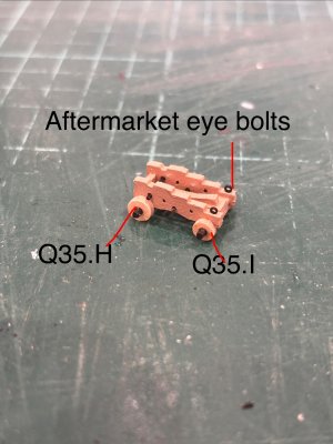

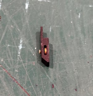

Part of this instruction video included making the quarter deck guns and I wanted to use better quality blocks and strop them with hooks for a more prototypical look, while searching the web I came across a site called HiSmodel that not only did better quality blocks but supplied complete sets of blocks for standing and running rigging as well as gun tackle blocks for a number of listed kits in various scales, so I ended up ordering a complete set of blocks for my 1/84 Victory. Although I had some brass PE hooks from a previous project, they also supplied PE hooks and eyebolts already blackened, so I ordered those as well. When they arrived from Czech Republic and I started to strop them it was obvious that the .15 thread in the kit use previously for the guns looked too large for for these blocks so I had to source some smaller thread. Surprisingly, two other manufacturers I tried, there 0.25 thread was smaller than the AL 0.15, perhaps that’s why myself and others had to drill out the holes in the smaller kit blocks to take AL’s supposed 0.15 thread.
There’s also been a holiday in between too
The hook method was more difficult to do and from a distance you can’t really notice it but I’m glad I made the effort
Due to restrictions on the number of photos you can attach in each post, I’m going to list Video #37 in several parts

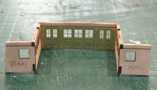

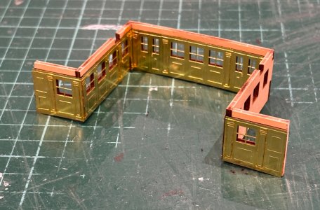

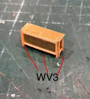

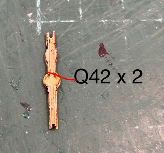

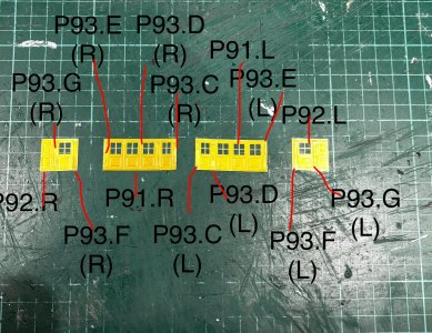

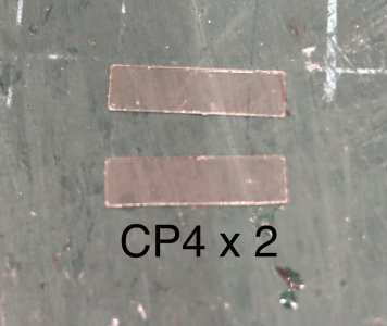

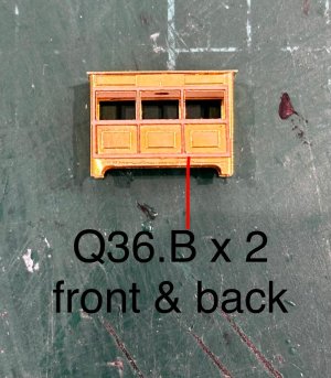

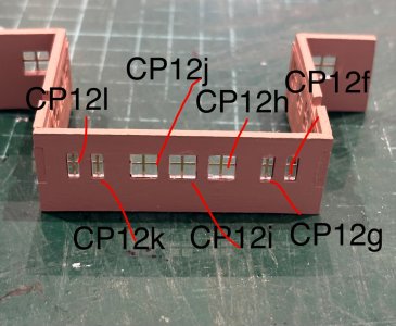

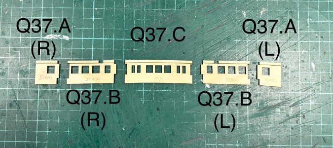

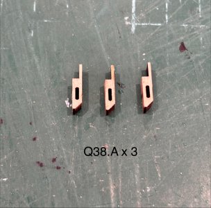

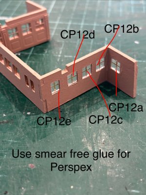

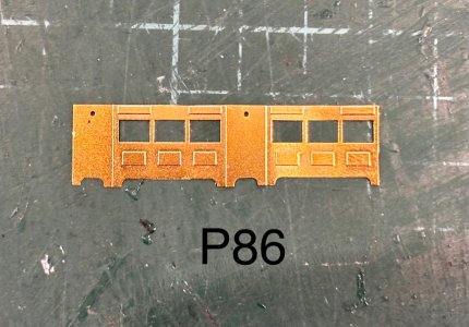

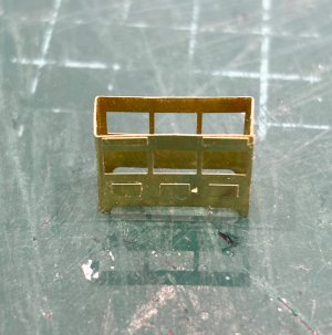

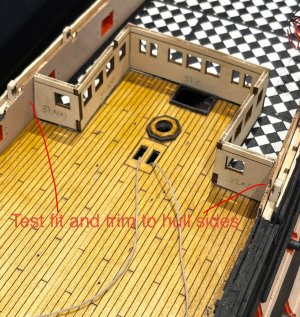

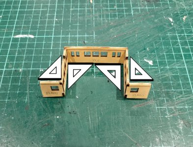

Instructions video #37 Part 2

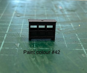

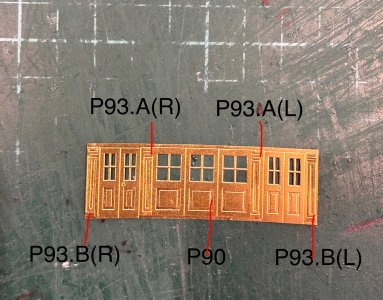

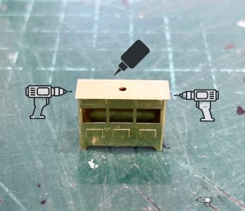

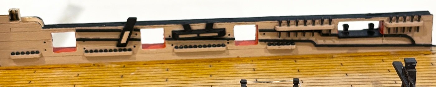

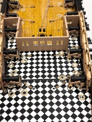

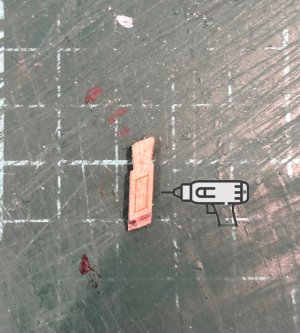

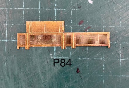

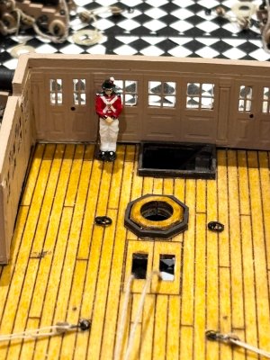

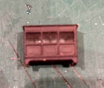

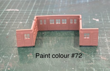

In this 2nd part I build and install the cabin walls on the quarter deck

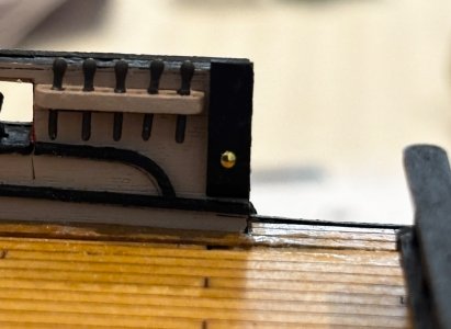

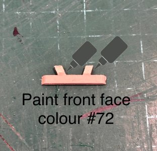

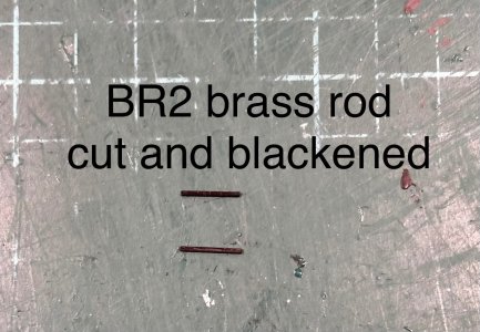

Instructions video #37 Part 3

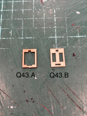

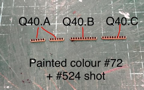

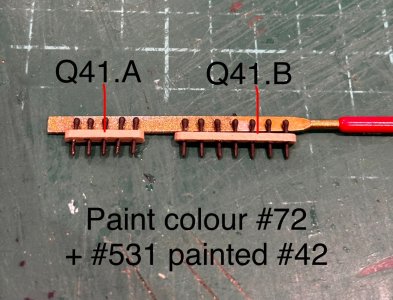

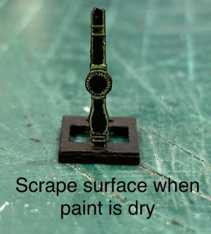

I now construct and fit the various belaying points and shot garlands on the quarter deck walls

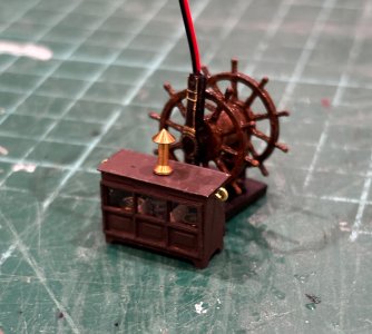

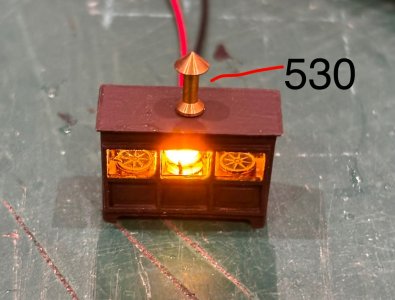

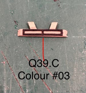

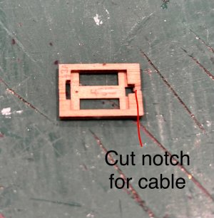

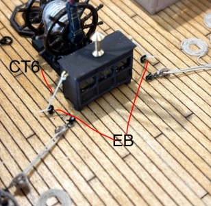

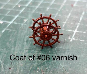

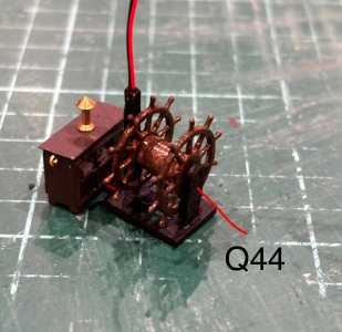

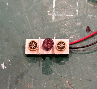

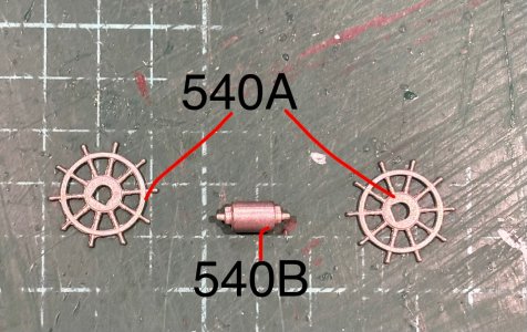

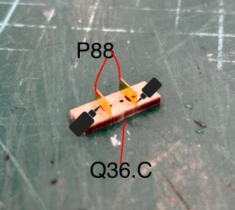

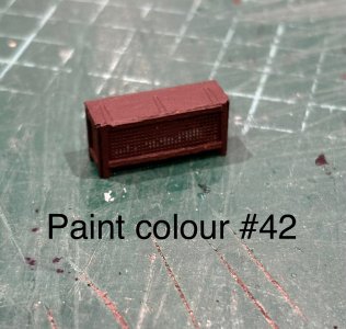

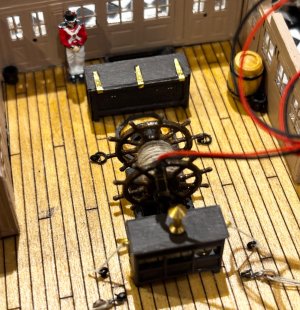

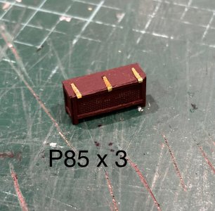

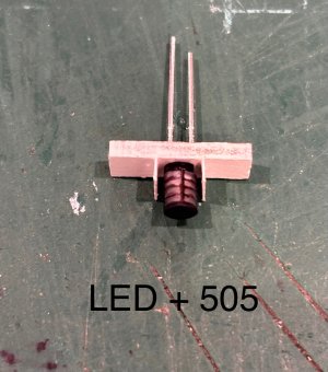

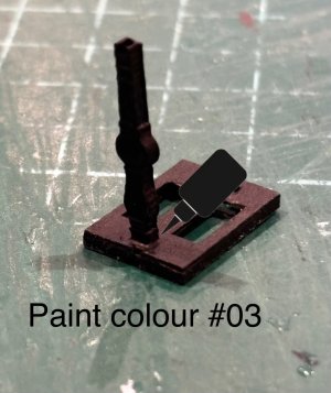

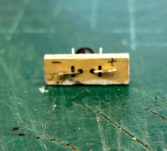

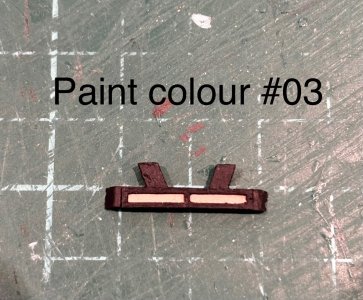

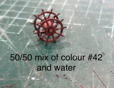

Instructions video #37 Part 5

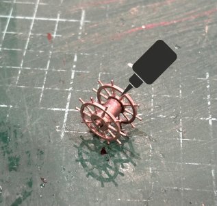

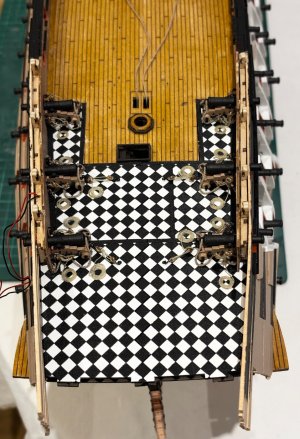

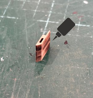

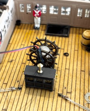

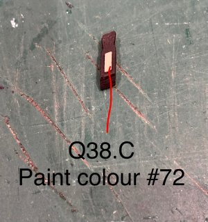

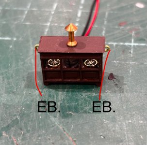

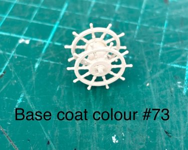

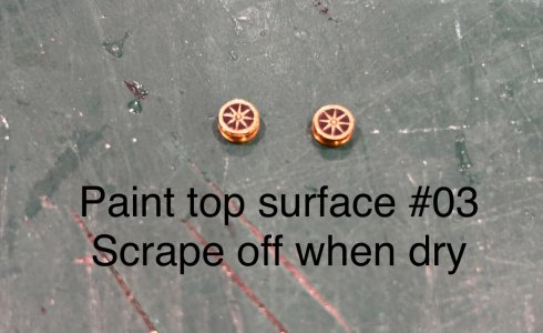

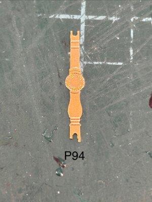

Finally in this instalment, I build the ships wheel, a chest that sits behind the wheel and install a beam to route the cables for the binnacle lamp

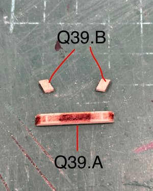

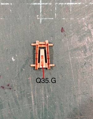

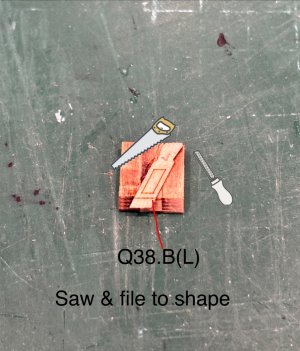

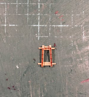

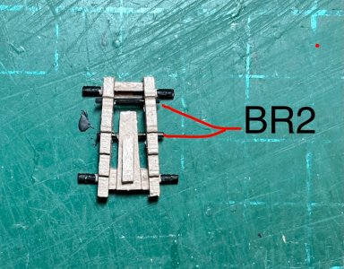

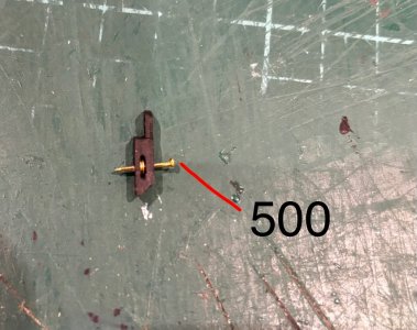

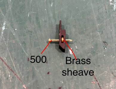

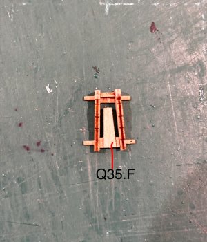

Instructions video #37 Part 3 edit
Somehow I managed to miss this part in the video and only noticed them while looking through the next one (video #38). So I’ve knocked them up double quick
Caruana gives data on the breech rope lengths and diameters based on information from the Public Records Office Supply Section. The lengths they gave were as follows:
Gun size ----- Length in feet
42 pounder --- 30
32 ---------- 30
24 --------- - 30
18 ---------- 28
12 ---------- 28
9 ---------- 28
6 ---------- 27
4 ---------- 27
It does not specify different lengths for different lengths of barrels but should be pretty good for our scales. The breechings stretched as much as 15% in a short time, so this gives a lot of leeway from 27 feet to 34.5 feet. :)

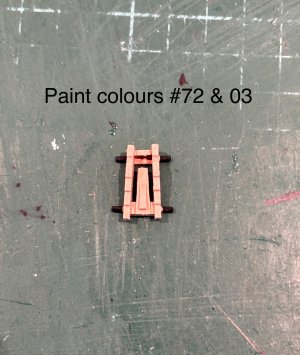

Job well done, especially the anchors of the cannons. Is it possible to know the link of the site you are talking about?
Hi Alan

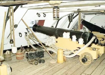

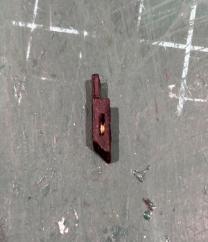

I was wondering what the two eyes are for on the back of the carriage bracket. Thanks
Hi Allan
I don’t really know what they are used for , think I’ve only ever seen them in use in one photo years ago, but they are a prominent feature on the gun carriage that’s why I decided to add them myself
Regards
Alan
Hi Allan
Regards
Alan

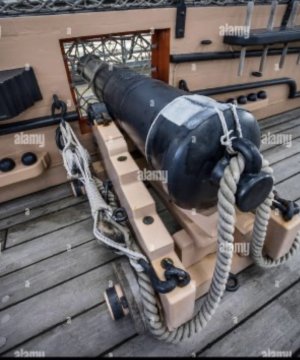

I found this photo, not the one I was thinking of, but shows the block and tackles attached
The tackles are wrapped up so this wasn’t when the gun was “ready for action “
