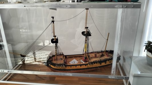

I can't believe it's 7 months since I updated my build log.
During that time I have dumped my old Ender 3 3D printer (it was just not working for me) and bought a Bambu A1 Mini printer. Since I originally began dabbling in 3D printing, the tools available on the Internet have come along in leaps and bounds and I have started using AI to convert images to 3D models. I'll be posting some of them in a few days when they are glued in place on the ship.
I have struggled mightily with the rigging, (which was expected) and was the reason I decided on the dis-masted diorama.
Having decided the perspex (acrylic) case I had made is too high for me to easily lift the ship out for working on it, pondering solutions for months and planning a strategy in my head, I cut out the back, added aluminium bracing and fitted acrylic runners to slide in the back piece. Now I can just spin the stand around (the base is on casters) and take the ship out without the high lift. It also means less danger of damaging it each time.
I also dabble in electronics, especially scrapping, and that is a time consuming hobby.
A couple of trips away and seven months has gone by.
Anyway, I am back to modelling again and will start my Build Log updates again over the next few days.
