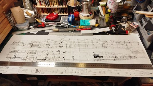

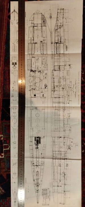

Сестрорецк [Sestroretsk] Scratchbuild scale 1/64 Russ. torpedo boat 1894

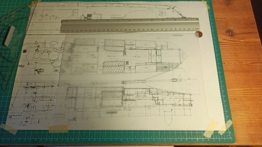

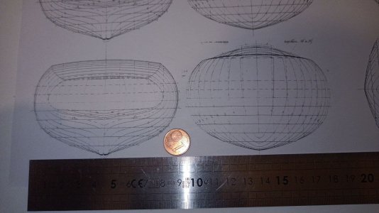

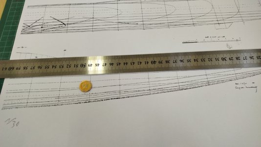

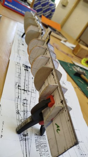

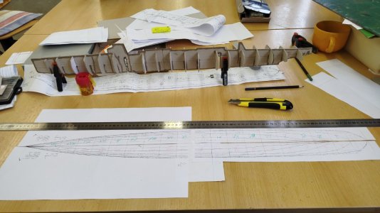

Today I do start the CWL horizontal "fillerpices" to force the bulkheads rectangular towards the centerboard:

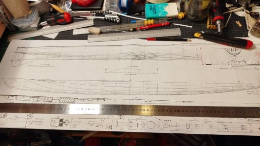

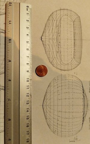

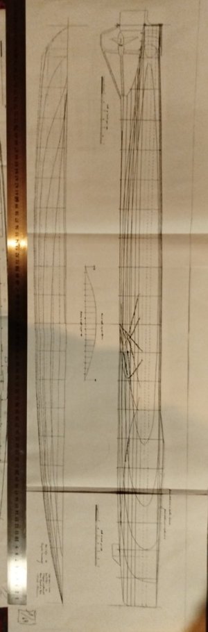

Here the WaterLineDrawing for the correctly set distances between the bulkheads:
And the width is right the outboard hull line must be placed from point of the CWL/hull-crossing towards the next bulkhead as the straight was of the centerline's drawings is a problematic feature:

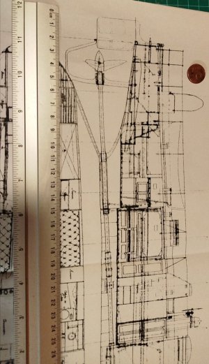

Here the dealing with the thick ess of half the centerboard and full thickness of the bulkheads...

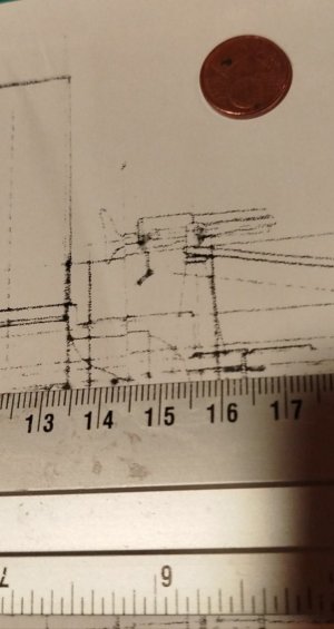

...and the three most aft bulkheads
to form the quite complex trensom:
So let's see what can be done today?

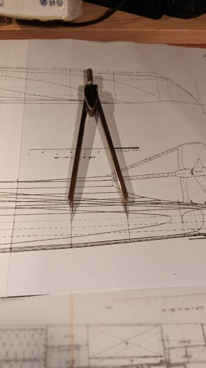

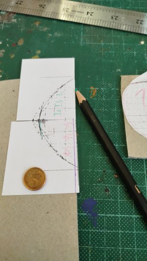

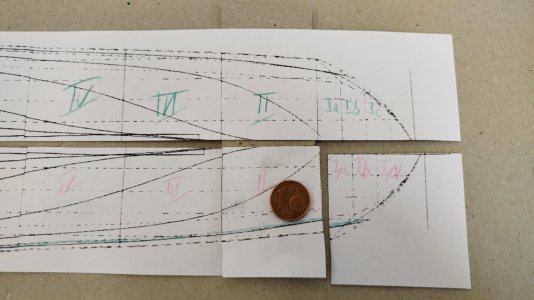

Hello, blowing the dust away I saw my self confronted with the construction of the filling pices between the bulkheads.
As percision is more importand then swiftness I worked my way with a drawing compass...
..as my buttomhole streatcher for similar distances wasn't the right tool to use.
So I numbered all the gillingspaces from I up to XXIV.
Scratching the lines with a dull scalpell blade:

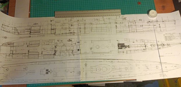

Hello

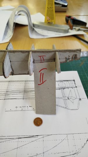

today I dealt with the filling pices between the bulkheads.

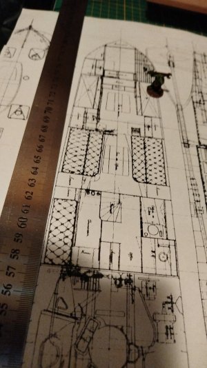

IMG_20260226_114148_130.jpgI took the breadth from the water line plan and
have to remember to cut out two mms for the thickness of the centerboard.
I do show how different the size of the filling pices is by putting them into a pile (and built a box to store them untill next week).
