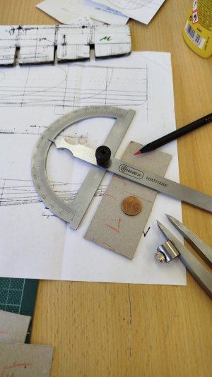

Hello, blowing the dust away I saw my self confronted with the construction of the filling pices between the bulkheads.
As percision is more importand then swiftness I worked my way with a drawing compass...
..as my buttomhole streatcher for similar distances wasn't the right tool to use.

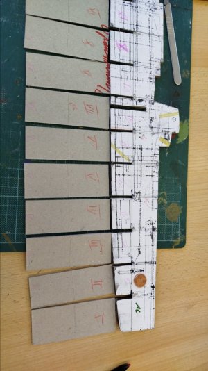

So I numbered all the gillingspaces from I up to XXIV.
Scratching the lines with a dull scalpell blade:

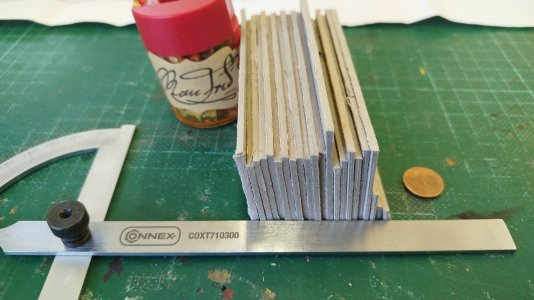

today I dealt with the filling pices between the bulkheads.
IMG_20260226_114148_130.jpgI took the breadth from the water line plan and
have to remember to cut out two mms for the thickness of the centerboard.
I do show how different the size of the filling pices is by putting them into a pile (and built a box to store them untill next week).
