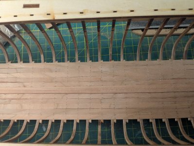

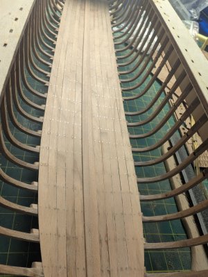

Finally finished putting the nails in. I am using Bob Smith Extra Thick and just putting a blob down on a palette and dipping the ends of the wire in it, before inserting them. The CA glue says 10-25 seconds cure, but I can leave a small blob on the palette for 1/2 an hour or so without it losing any viscosity.
The last 7 frames will be hidden (something I didn't think about until I had already drilled them) so I can refrain from putting nails there, but I wonder if I should do some anyway just for the added structural benefit. Sanding the outside is gonna put a lot of stress on the frame, nailing the last seven frames could help, or it could hurt in some ways.
Next up, gotta figure out how to grind the nails closest to the keelson without gouging any of the decking or keelson. then I need to figure out how to sand everything down without destroying my entire stock of sandpaper. Then I need to figure out how to blacken them in situ.

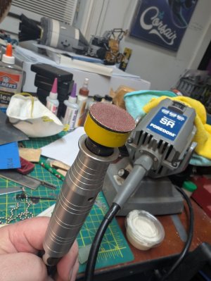

Getting rid of the nubs of the brass wire after gluing them in was pretty rough. I tried everything in my arsenal and then some and it was just kicking my posterior. I finally got these today in an effort to combat them. The flapper wheels were useless, too short to flap they ended up just being a worse drum sanding bit. But then I tried the other one and finally! PXL_20250912_041403593.jpg
This thing at a halfway decent speed made very quick work of them. Chewed them right down tot he wood. I did scuff a couple spots deeper than I would have liked so I must get better at using it, but all in all I am glad to finally be done with the inner nails. The outer ones should not pose nearly as much problem as they will be far easier to reach.

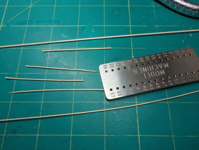

When I finished I practiced making trennels. I still need more practice, but last time I only made it down to the mid 40's and this time I made it to the low 30's.PXL_20250912_044307217.jpg
The brass wire on the kit is .6 mm (.023"). I am not sure I can get all the way down to that, but I really don't want to use brass wire on the Swiss Pear one. This is maple out of an Occre kit I no longer want to build. I think it would contrast well with the pear. I think wood nails would simplify things hugely! It would so much easier to use a chisel to get rid of the nubs.
Have you tried bamboo kabab skewers? Much stronger when pulling through the drawplate, very close to the color of maple and relatively inexpensive at your local grocer.

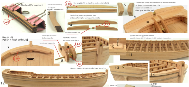

Started on my kit. So far, just getting setup. And translating the Chinese into English. Using google translate for that - tried others, but this works best for me. I translate on my laptop, then transfer the English instructions to my iPad as jpegs - which is easy to position and view while I model. (Translating on my iPad had issues)
I discovered that I couldn't translate a whole pdf page - as the whole page resolution was too crappy - and instead had to blow up the pdf, copy that part into a pic, and translate the pic and save it.

I have translated the instructions - I had to create 3 sections for each page, in order to get good translations. Each translated section is about 1.5mb and includes the pics. There are 23 files total. If anybody wants a copy - I'll send em to you ... tell me how you'd like to get em. They are currently in png format. And as I said, each one is about 1.5mb. And the zip file is 32mb. I included one of the section files so you know what I'm offering.translated_image_en (15).png
