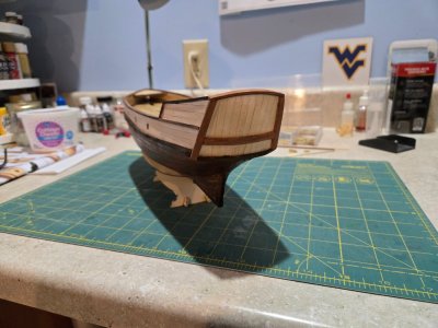

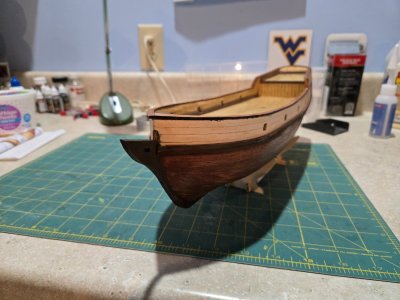

A quick update. The second planking has been completed stained and varnished. Lember boards and other trim pieces have been installed. Still need to install the rudder, but I hate gudgeons and pintles, so I'm procrastinating. I'm happy with how it's going so far, but there are several things I did wrong and hopefully will correct on my next ship. First off, there is a very slight twist to the frame which I didn't notice until I had the bulwarks attached and had already started planking. Next, I did a good job of fairing the bulkheads but did not adequately fair the added blocks at the bow and the stern. This resulted in a fatter than normal stern and a more rounded bow making the final planking less than perfect. Then I learned a lesson of not cutting stick lumber to what I thought was the correct length but cut it slightly longer and then sand it to proper length. Still have some sanding to do on the gun portals. I have just started on the deck furniture which leads to my next question.
I've just started work on the cat davits. The directions specify holes to be 0.5 mm but these seem to be much too small. Are these accurate?

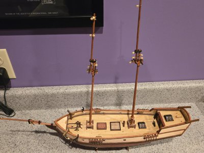

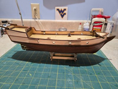

Here are some current pictures of my ship:

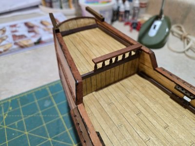

Long overdue for an update. Was on vacation last week. Here are some photos of how far I had gotten before vacation. I added the Cat davits, boat davits, railing, along with some of the pin racks and the channels. I positioned the channels according to the top view of the plans. However I think I may have to move the forward channels farther forward to not have my gunners shoot the chain plate. The illustration in the instructions shows it farther forward than the plans.

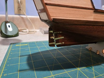

Here you can see the rudder is installed after much procrastination. I cheated here by leaving the pin the entire height of the rudder instead of three separate pins.

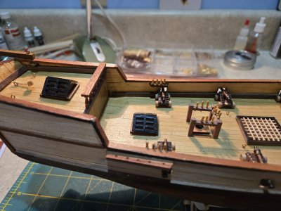

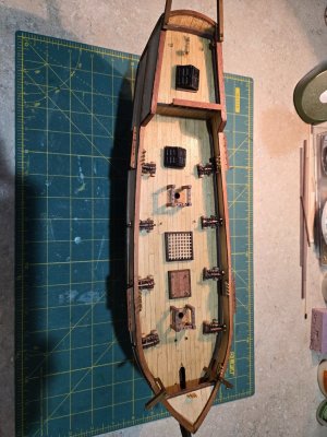

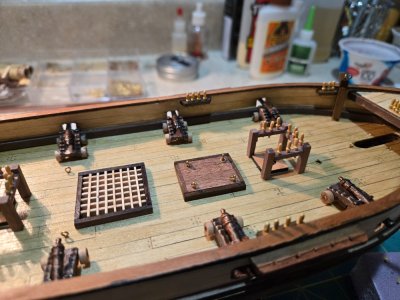

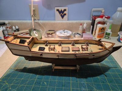

Here are some latest pictures showing some of my deck furniture. I wish I had a drill press to aid in drilling the pin racks and channels. For the life of me I cannot get evenly spaced holes that go vertically through the racks. Besides adding the furniture, which is not glued down yet, I also relocated the forward channels to avoid the gun ports. I am still unhappy about how the canons don't fit well in the gun ports. I feel the barrels should be centered in the port, not resting against the top. Even with the barrels pointing down they still don't fit. I feel that the carriages are too big and have tried to find a way to lower them by filing a channel in the bottom to recess the axles.
I'll probably go ahead and glue the furniture, excluding the canons, to the deck. Should I glue the belaying pins into the racks at this time? Some of the holes will need to made larger to get all the pins to seat fully.

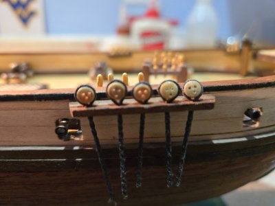

Here are my first set of five deadeyes. Every time I look at them, they remind me of Vincent Van Gogh's Scream painting. These chain plates, (do we still call them that?) have not been attached to the hull yet. Before I do, is there any need to increase the size of the eyes?
Thanks for looking and any suggestions or comments you can offer.
My pin racks were uneven as well. Once they were attached to the ship and the rigging was attached it wasn’t really noticeable. I use a pin vice to drill my holes.
I spent a fair amount of time yesterday tieing dead eyes to the chain plates. I used CA glue on them. Yesterday evening I started tacking them to the hull. Excuse me, I tried tacking them to the hull. I couldn't get a tack through the CA saturated chain plates. I have now switched to using thinned white glue. I felt really bad as I chopped the heads of twenty dead eyes from their thread bodies. I've redone 5 dead eyes with the white glue and was easily able to tack those to the hull.

I used CA as well. I completed the starboard side shortly after I completed the chain plates and didn’t have any problems. On the port side I completed the chain plates and came back the next day to attach them to the hull and had the same problem. I redid everything as you did, however, this time I attached the pins, twisted the thread, and simply tied the thread to the pins. It worked out really well for me.

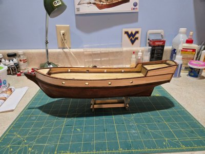

Since the last post, I have added the deadeyes to the channels and attached the chain plates to the hull as shown below. I have also added the steps, the door, and connected the anchors to the cat davits. Will include pictures later. I do not like the steps and door being cast from metal. Both of these should be done in wood.

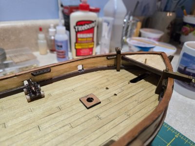

Started work on the Bow sprit. I cut and sanded the two parts as shown on the plans. Then using the side view on the plans, I cut the notch for the gammoning. Then dry fitting it to the ship I notice that the notch is not even with the corresponding hole in the bow even though the piece is fully inserted into the ship. I then looked at the top view on the plans and the notch is not even close to the notch in the side view. Did no one even teach the Occre designers basic drafting? I thought the 1 to 1 plans were supposed to be accurate.
and that is the reason we check and double check. :) Glad you caught it now. :)
If you want to change the steps and door to wood, do it now, before you put the masts on. It's much easier at this stage. :)

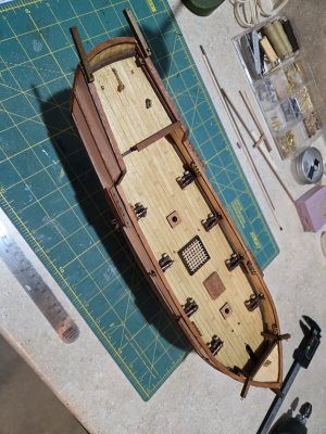

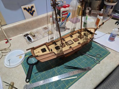

It's been a few days since my last post. I noticed some of my pictures didn't show up on a previous post. I believe it was because I used the attach files button, then inserted the pictures. There were some I attached and then didn't insert them so the I deleted the attached files. Oh well, here are two pictures of my current state. I have completed the bow sprit, masts, and yards.20250716_153448.jpg20250718_110751.jpg

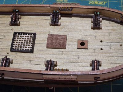

Notice I haven't placed the canons yet until I decide whether to try to increase the height of the gun ports or not. Also I just finished building the bilge pumps but need to do some finishing touched to them.
Next up is the rigging. From videos I have watched, I see that most people are using thin instant CA on their knots. I have thin CA with the micro tips but I am unable to place tiny drops even though I am using a brand new tip. A single drop on a piece of scrap wood is about the size of a dime. When trying on a rope, it saturates the rope and drips down to whatever is below. I have better luck using a pin to place tiny drops of medium CA but would prefer the instant setting of the thin CA. What am I doing wrong?
Another question is whether I should glue the masts to the hull or let the standing rigging hold the masts in place. Occre's instructions just end after you construct masts and yards and rely on pictures with rigging highlighted in red.
Finally, how much extra thread does Occre provide? During the lashing of the blocks to the masts and yards, I kept finding better ways to do it and redid several of them. There are a few more on the masts I am contemplating redoing, but I don't want to run out of thread.
I removed the wheels, sanded down the gun carriage, then reattached the wheels. I also made a small wedge and placed it under the cannon to tilt it down.

The cannons fit after sanding the carriages and making the wedges to lower the barrel. I just bought some liver of sulfur to blacken the barrels on this build. I didn’t like how they turned out when I painted them on the Albatros build. I used ammonia on the last build and found the brass eye pins were very brittle.

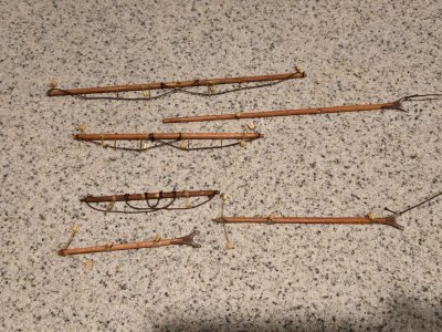

The mistake I made on attaching yards to the masts was trying to do it after I installed the masts. This time I'm going to attach the yards to the masts first before I attach the masts to the deck. I’m also considering drilling holes in the masts and yards and attaching them with pins. I’m working on my second ship, so this is all still new to me and I’m learning from my mistakes.

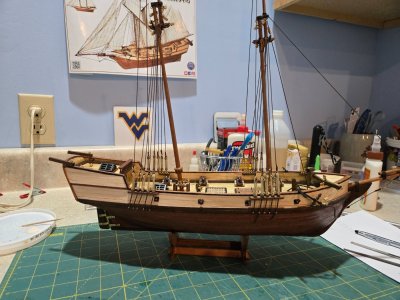

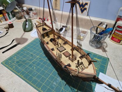

Thanks for the info PD. I have been working on the standing rigging and Ive learned a few lessons. First, when installing shrouds, it helps if you havent glued the mast head to the top of the masts. Then you can serve the shroud pair and loop it over the mast. I would think installing the yards before installing masts would get in the way of making your rat lines.

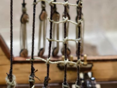

I have finished installing the shrouds, and have just started doing my rat lines. I thought I had pretty good eyes for a 73 year old but when working with these ratlines I have very poor depth perception when trying to grab a thread with the tweezers. I also went ahead and installed the cannons before too many lines got in the way. Here are some pics of progress so far.
Close up of the ratlines look very hairy. Trying to maintain spacing between shrouds is very difficult. Once a clove hitch is tied it's hard to adjust them. I'm getting better as I go. Also I may have too much spacing between each row. They will really get harder as I near the top of the masts.
