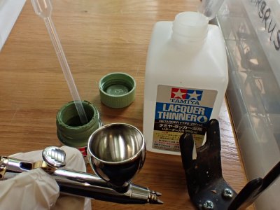

I like to spray the brilliant Tamiya and the even better Gunze paints. Both of these brands make acrylics with a solvent made from water and alcohol and a host of other stuff like flow improvers, retarders, and magic fairy dust. Some people substitute IPA and water but in the small quantities that I use, I like to pay the full price for the proper stuff with the additives. On this part of the process I'm using Tamiya's retarded lacquer thinner. The retardation helps me build up the paint layer very slowly and carefully and the lacquer helps the paint 'bite' into the plastic because this first application of paint has to be applied to naked plastic - no primer!

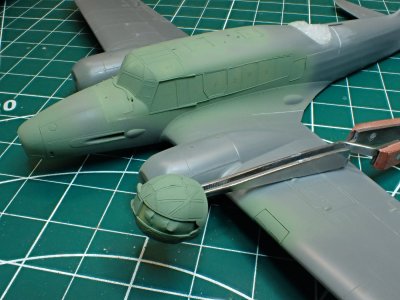

I'm painting the interior of the transparency framing with Interior Green paint. As I didn't have any masks for the inside of the clear plastic bits and also because I'm building this model the easy way, I'm painting the interior from the outside. Now you see why I couldn't prime the model first.
It's quite important on a 1/48 scale kit to paint the interior of the cockpit framing in some way because it is usually visible through the windows. On the Anson with those huge picture windows it's absolutely essential.
I built the paint up slowly to avoid liquid flooding through any unnoticed gaps in the gluing or masking and made it thick enough not to be translucent.

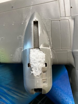

A little more masking. It’s nylon packing foam.

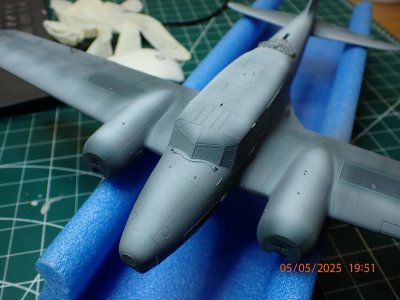

That looks pretty good to me.

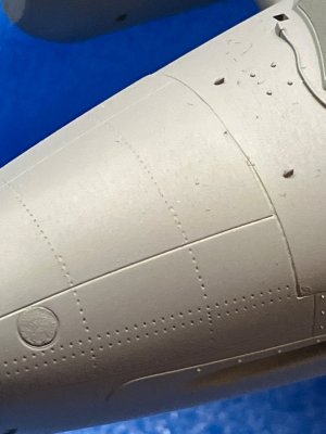

No trace of the joint is visible on the nose. You can’t really be sure until the primer covers the line of the joint and allows the surface profile to be seen clearly.
Not quite so good at the rear fuselage. The join is visible, but minimal and good enough.
Does primer obscure detail? Not so much.

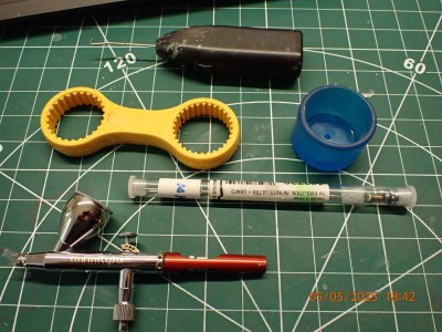

Same tools. The ring spanner and the rubber cup are for removing the lids from Tamiya and Gunze paint jars which sometimes stick fast as paint dries in the lid threads.
The cappuccino frother is a paint mixer when the end is modified. Cost a pound at Ikea years ago. I've seen exactly the same 'professional paint stirrers' on sale for twenty times as much.

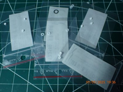

I've always liked to keep a full range of seals for the airbrush. Tonight I replaced two of them, which is the first time in a decade such maintenance has been required.

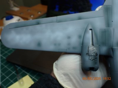

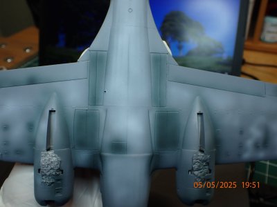

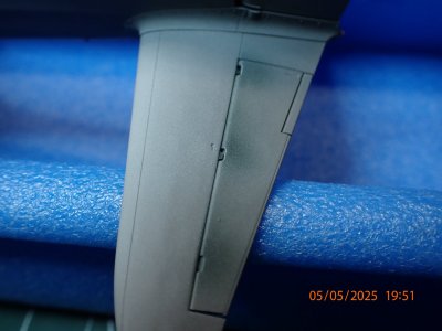

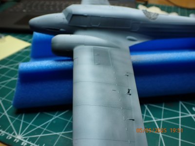

This is zenithal highlighting at the underpainting stage. If it works it's easier than doing it with the top coat. I've sprayed a whiteish layer of Tamiya paint downwards onto the tops of all the upward curving surfaces. These surfaces would reflect light from above and appear lighter. I've done the opposite with a very dark green paint sprayed from below for the shadows. I've also darkened the 'armpits' where wings and tail meet engine fairings and fuselage.
The idea of this is to make my topcoat colours vary in shade according to the effects of light on a 3D form without me having to change paint colours. All I need do is use acrylic paint's great advantage by spraying thin translucent coats so that the underpainting shows through.
Being out of practice and hamfisted it's likely that I'll just cover all of this lot up but if I can hack it, it can look really good. Models are just too small to cast shadows and highlights like the full sized objects - so they need a little help. When it's done well, the observer sees that the model looks more 'solid' and 'real' but won't know why.
As well as the shading/highlighting I've deliberately broken up the large flat areas with marbling and suggested some muck and grime. It looks overdone now but when the top colours are on, they will be suitably modulated like the real things.

Silver paint isn't great for this preshading/modulating technique because it's so opaque. I'll have a go though and back it up by using different colours of metallic for different areas. The 'silver' was silver dope over canvas in some areas, silver dope over aluminium alloy in others, and occasionally bare metal.

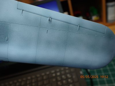

I'm also modulating the silver, mostly as an experiment to see how effective this all is.
That's the modulation on the upper wing where it might be too faint. I'm out of practice remember.

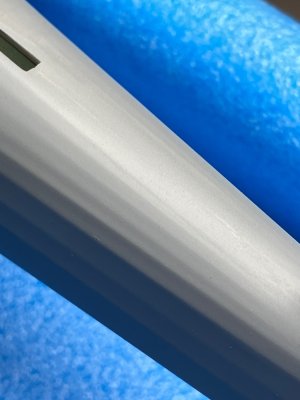

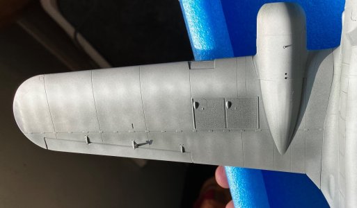

This is with incident sunlight perpendicular to the surface. (See the shadow of the control horn on the aileron.) This flat lighting would normally wash out the contours but can you see now how the various shades give a 3D effect? By chance and design, this is very much what I intended. I’m chuffed to rocks!

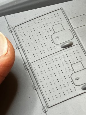

Raking sunlight reveals the subtle surface contours included by some genius at Airfix.
Seeing the two effects combined I’m chuffed to little monkeys! It’s the dogs!
