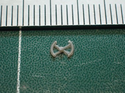

This is how I'm trying to model it right now.
Take a piece of plastic sprue. (Strictly speaking that's a runner, not a sprue but we'll go with that general misunderstanding.)
Heat it in the middle with a candle or cigarette lighter until it's softened exactly enough for the required final diameter. (Softer = thinner)
Cut to size (by eye) for the spokes.
Cut a thin slice from the thicker portion for the centre boss.
Repeat the process, winding the soft plastic around some round objects to form the curve of the hand grips.
Cut to size.
Make glue-proof working area with Sellotape.
Assemble and glue with Tamiya Extra Thin cement.
Back slowly away from the bench while it dries out and hardens completely.
Offer up a prayer to the Modelling Gods that it won't stick to the tape.
To be continued...

It's a little small, side to side, but well within my current tolerances.
I'm rather proud of myself for making that, despite the shakes, the poor vision, the false starts etc. It may not be accurate but it has 'Smithy Fecit Me' written on its soul.
Now I have to paint it!

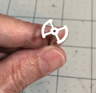

Just to demonstrate, I took a plastic wheel and modified…
Note the right side, it is still square edged. On the left I used an xacto knife to scrape the edges to be round. It is better than using a file because you can get in tight areas. Then added glue bumps with a toothpick. Yes I added less and made them larger for effect, disregarding scale so it can actually be seen. Then I added some more material around the tips of the handle with a toothpick and PVA glue. Just roll it around the surface to build up.
Then she was painted and a light dry brush on the handle…
And that was what I was suggesting. I would never suggest someone do something I could not do myself. ;)

That rule at the top is graduated in millimeters, not inches. Your dots need to go into a 1.7mm space between the spokes.
And compare the sizes of our index fingers and our wheels - "disregarding scale" indeed.
Now do one my size (and as fragile).
