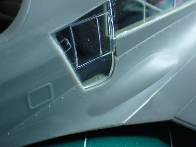

The fit of these complicated shapes was generally very good, needing only the occasional smear of putty.
The one nasty gap was at the access door. If this was a full effort build I'd never have known as I'd have opened the door for the sake of extra interest. Never mind, I will simply declare that this particular aircraft had a bent door. (if any cowboy out there feels the need to tell me how much better their door would have fitted, please don't trouble yourself, ignore function invoked. ;))

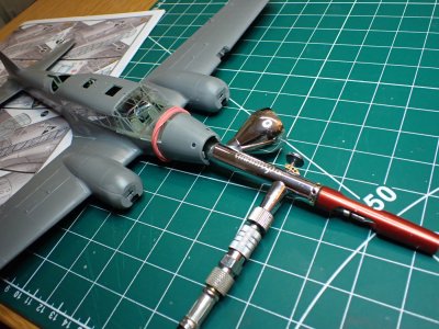

Painting begins ... with preparation. First, I donned rubber gloves. I won't touch the model with my fingers again until it's completely finished.
I degreased the entire surface of the model with IPA (India Pale Ale? No, isopropyl alcohol). This was to get rid of the fingerprints that I will have left everywhere. I wiped the larger surfaces with a paper towel soaked in IPA and then went over the windows with a soaked cotton bud to give the window masks their best chance of sticking.

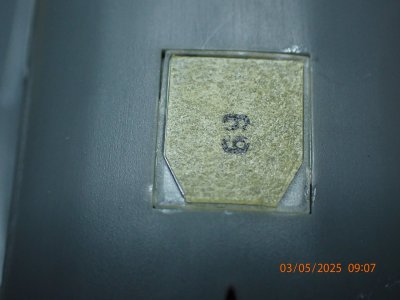

Next, I had to mask the windows, and there are a lot of them. I mentioned before that I'd bought a set of pre cut masks made by Scale Mask and they were brilliant. They fitted really well, were sticky enough to hang on through lots of painting and handling but not so sticky that removing them for repositioning became difficult. They were thin and flexible so they stretched over compound curves but stiff and strong enough for me to be able to reposition them without them stretching out of shape. They also made masking the Anson a two hour job, with a break in the middle because my eyes were bleeding, instead of a week if I'd been cutting my own masks from Tamiya tape.

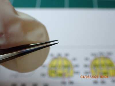

Sharp thin tweezers are essential as are the rubber gloves. These new ones are a little loose but the tight ones I bought last time made my hands sore. Compromises!

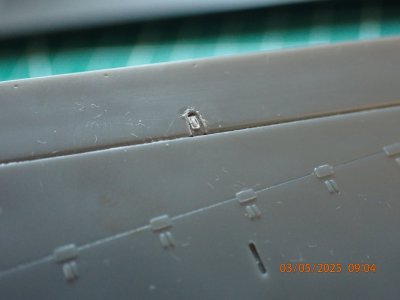

I broke off a control horn under the wing. This was not a surprise and I may well not bother replacing them (I removed the other one deliberately) because delicate underwing things always get broken by careless fingered people like me.

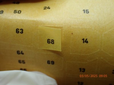

That's what pre-cut masks look like.

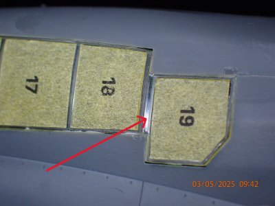

That's how good a fit they are. Note that the 0.1mm of shiny clear glass on the left is MY error, not Scale Mask's. My old eyes, even with magnifiers, no longer permit perfection. Say lavvy.

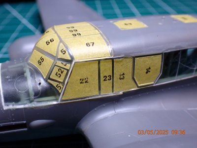

See how they are building up. I said there were lots of them.
I like the way Airfix moulded the windscreen integrally with the top of the nose. The join is a lot easier to make this way with no risk to the 'glass'.

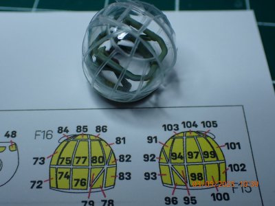

Did I mention that there are quite a lot of windows? The turret alone has 33 pieces of masking on the panes of perspex.

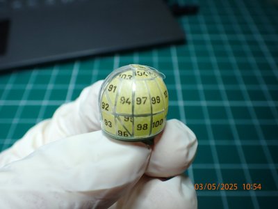

All done. Note the extra bits on the turret where the gun will be fitted. That's not covered by the pre-cuts, it's expected that you will sort things like that out for yourself. The blue liquid is latex masking fluid. You can buy latex very cheaply in big bottles but I prefer to pay the premium for the blue dye and neat little bottle that Vallejo provide for modellers.
