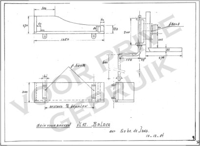

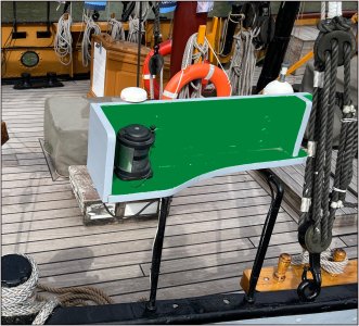

The last item I still had to install on the deck or bulwark: the navigation lights. That immediately proved to be a major challenge.
There is also a drawing of:
They are mounted on the bulwark on two separate irons, each with two 90-degree angles. On the back of the wooden boxes are two brackets in which the irons can rotate.
While sailing, the boxes can be moved outboard, and when mooring alongside another ship or the quay wall, they can be rotated inward.
The irons are inserted through the handrail and each rest on two angle brackets, allowing them to rotate at a controlled angle.
The original construction already looks fragile ... and then there's the 1:50 scale ...:rolleyes:;)

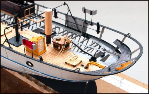

The result, after many hours of work with various versions that didn't work:
The irons are made of 0.8 mm wire. The boxes are made of thin plywood.
This is how they are turned inward:
"Of course" they can also be turned outward:
This is a very fragile structure, and after taking the photos, I removed them from the bulwark and put them aside. The risk of them getting caught on me later when I continue working on the rigging is far too great.

Nice work on those nav lights Peter. To have them functional is the cherry on top!
It is unusual to see nav lights positioned so far astern unless they are mounted on a pilothouse. Is there a white stern light to go on the taffrail as well or is it mounted on the mast?
Oh yes, you will definitely break those off more than once. Congratulations on reaching the stage where you will be going vertical. One of the most interesting builds happening right now!
Thanks for the compliments, Paul.:) In hoop: 'Break them' in the form of dismantling and rebuilding.;)
The nav lights look like they fit right in with the scale of the ship.
You also thanks, Daniel. Without the foto's and drawings I think I would have chosen on 'eye view' for a ticker wire. But that are the (dis)advantages of the real Balder nearby and the drawings. You have the real measurements. ;):)
You also thanks, Russ. Almost 'a piece of cake ..... ;)
I have to figure out what other light were in use. Have in mind that she starts fishing in 1912 ...... no electricity on board. Mainly carbide lamps were used.

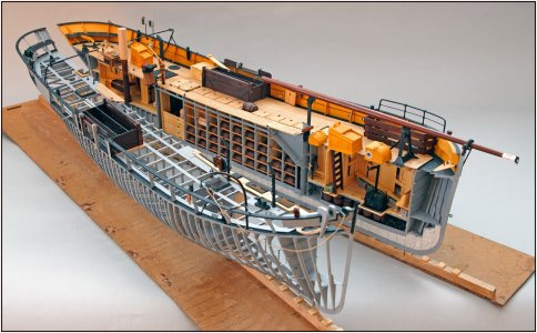

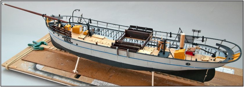

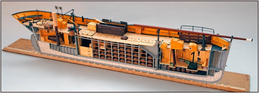

To work out the dimensions for the main and mizzen masts, I had to take both sections apart again.
I took a quick picture, since it had been a while. And I checked whether the 11 parts on the main seam would stay attached.
I had them build ‘clamped a bit’, so that works pretty well.

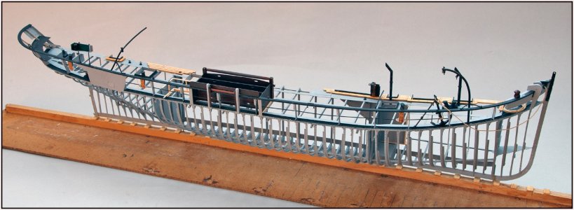

I took a picture of the other part as well:
The few parts don't obstruct the view of the construction too much.

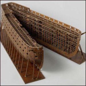

At the beginning of my build-log, I showed what partly inspired this project:
So this might be a sketch of how I could set up the model during a meeting:
That will take a while, so I'll just keep building.
