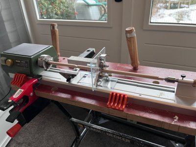

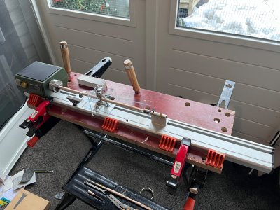

The bed of the Proxxon DB250 is too short for the masts. Here's the shorter mizzen mast. I ordered an extra bed from the Proxxon representative in the Netherlands for a reasonable price. It will arrive today or tomorrow.
I also made a support for the longer pieces:
I still had some pieces of plexiglass left over from the display cases I'd already made. I glued everything together with chloroform. And some spare bearings from my roller skates are now getting a second life.
