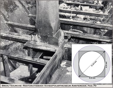

The mizzen mast has a square foot, 200 mm, that extends to around 660 mm all the way to the deck. But when making the stub, I had already shown this photo from the Amsterdam restoration book:
It clearly shows that the mast foot tapers from square to round with the same diameter.

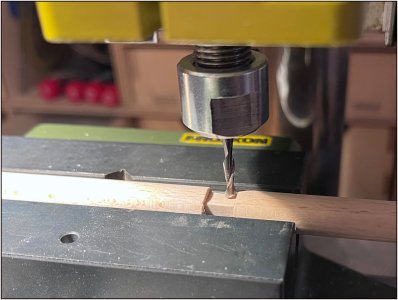

I made the square feet for both masts on the cross table:
My Admiral enjoyed watching me concentrate:
Always checking if the foot would fit in the mast socket.

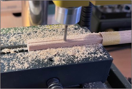

The square parts on 2/3 of the masts were also turned to the correct position and size:
The cushions for the shrouds will be placed there later.

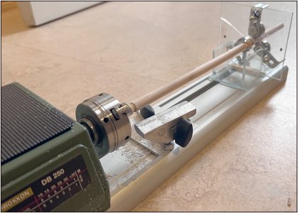

The mizzen mast was turned to the correct size of 6.6 mm at deck height:
The bed of the Proxxon DB250 is too short for the masts. Here's the shorter mizzen mast. I ordered an extra bed from the Proxxon representative in the Netherlands for a reasonable price. It will arrive today or tomorrow.

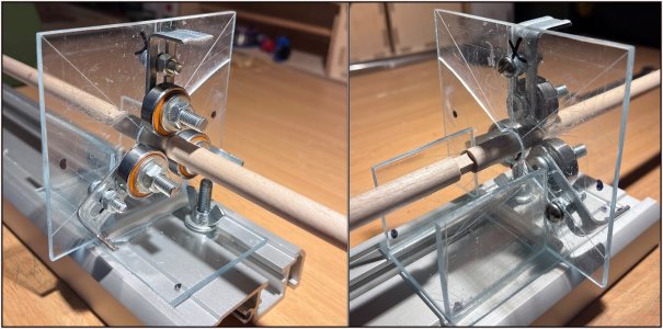

I also made a support for the longer pieces:
I still had some pieces of plexiglass left over from the display cases I'd already made. I glued everything together with chloroform. And some spare bearings from my roller skates are now getting a second life.

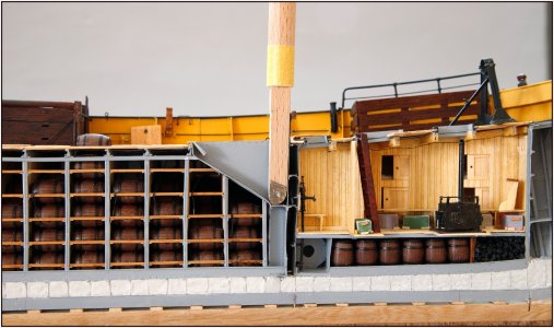

The main mast is square up to the top of the mast tube:
Because the mast can be lowered, I gave the bottom the necessary curves.
So that the bottom can pivot around the axle. Over the grayed-out piece goes a piece of brass that I glue into the kossing so that the axle is also supported on this outside and the mast also stays in position when both parts are taken apart. So, thinking a few steps ahead again...;)
The mast in lowered position:
The mizzen mast in place:
The foot and the passage through the deck have been made to size.
Then the main mast hinges precisely along the mizzen mast:
Now they're against each other. Once they're turned to size, I hope they'll line up perfectly. In practice, the main mast was then pulled tight against the mizzen mast with the starboard backstay. This prevents the main mast from constantly banging against the mizzen mast in the swell.

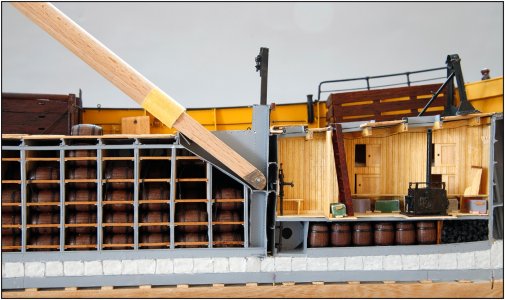

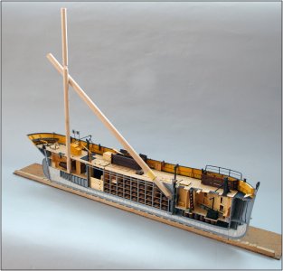

To work out the dimensions for the main and mizzen masts, I had to take both sections apart again.
I took a quick picture, since it had been a while. And I checked whether the 11 parts on the main seam would stay attached.
I had them build ‘clamped a bit’, so that works pretty well.
I took a picture of the other part as well:
The few parts don't obstruct the view of the construction too much.
