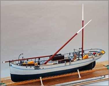

How a bit of color affects the appearance... :)
The masts have been given their reddish-brown color and white tops. Now with a view on the plated and painted hull side:
Here too, I used Schmincke Aero Color pigmented ink.
I also worked out all the lines based on the old specifications. Almost 23 meters (scaled lenght) of line in 8 different thicknesses need to be used.
This includes 12 shroud ropes, 2 backstays, 2 forestays, and 27 other lines.

You are right (again), Grant.:)
With the picture of the main mast and it's color, I had to create a color that looks:
But it was almost impossible to make this comparison ...... different light, different camera+lens etc etc. Even with my Canon+14mm fisheye as close as possible and crop it in PS a lot ..... :rolleyes:

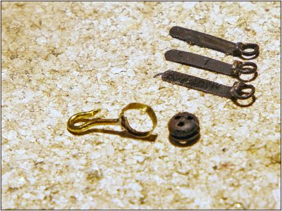

Here too, it became a matter of exploring what was possible. The deadeyes of the mizzen mast are 15 cm in diameter. That is 3 mm in scale. The chain plates are 8 cm wide, which is 1.6 mm wide.

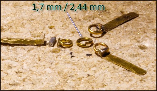

*I made the eye from the smallest eyelets in my stash. But the 'indicated 2 mm' is actually 1.7 mm internal and 2.44 mm external. The wire itself is 0.4 mm in diameter. That's almost the same size as the deadbolt.
I crimped the ring as much as possible. This way, it has a slight overlap. But that also provides a bit more grip for soldering onto the lip of the iron.
*I sawed the 1.6 mm wide strip for the 'iron' from 0.15 mm brass sheet. Between the eye and the lip, you can see a piece of solder wire with a diameter of 0.75 mm.
Soldering: I slid the eye and the lip against the solder and applied light pressure while heating it with the flame.
For making the sharp pictures I had to use my macro-lense with extension tube.
The next step was the band around the 3 mm deadeye with the hook:

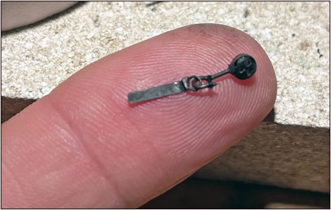

For this, I sawed a 1.1 mm wide brass strip. I bent it into the correct round and drilled a 0.6 mm hole for the 0.6 mm hook wire. I pressed this together with a piece of solder wire. The block fit perfectly, but I used a dab of CA to be sure.
All the brass has been "burnished."

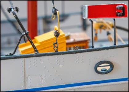

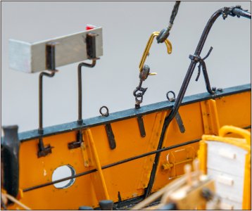

Fitting it in was a skill in itself:
The iron with the eyelet not yet secured in the bulwark. The top deadeye was secured around the mast with a piece of wire.
The hook opening was "tied" with a piece of black Serafil.
This is what it looks like from the inside of the bulwark:
Everything is clamped in place.

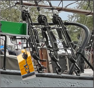

To see the proportions, the bottom deadeye with hook and eye has been pasted into a photo of the original:
The eye could be a bit thicker. But 0.1 mm to scale is already quite...;) I'll see if I can bend an eye from 0.6 mm wire to scale. And flatten the top of the hook a bit to make it a bit more robust.

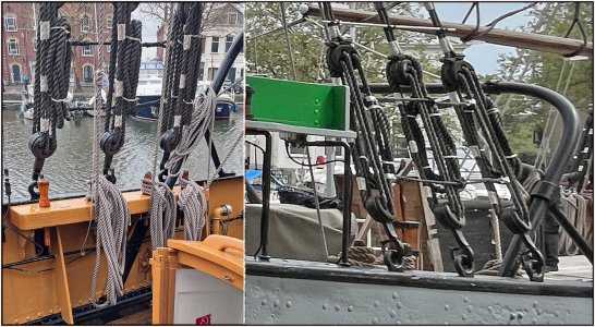

But everything is again 'on the limit. With reference:
You captured at scale the essence of the real lower dead eye. I also like your simple but effective brass wire dead eye spacer.
Masterful, Peter. The metalworks are very convincing. I believe scale is everything here and you should be very pleased.
“Just WOW! Especially at this small scale, the metalsmith’s work is absolutely amazing. Bravo, mijn vriend!”
In awe of your ability to accurately duplicate (in such detail), complicated pieces using three different materials (wood, metal, rope).
The proportions are perfect and add so much to this incredible build! Thanks for sharing.
