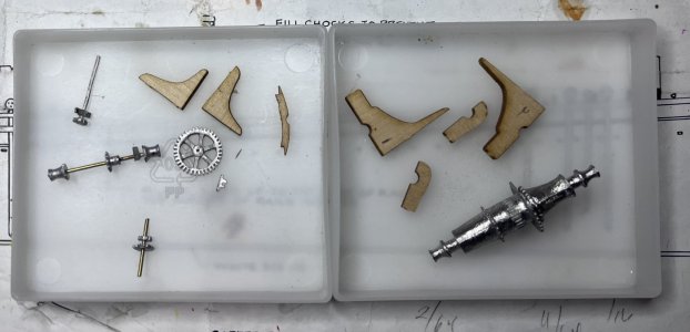

Next up were the so from the two mooring chocks, the bow and stern chocks, and the steering wheel, all from the Britannia metal pieces.
I used a few small files of different shapes to sand them free of the parting lines and gave them a couple of coats of primer.
3945
3946
View attachment 538239 View attachment 538240
And then Covid hit me again (and yes, I am vaccinated and bolstered). After a few days, I was up to some painting.
The chocks were easy as they are painted black.
I had wanted to dress up the steering wheel, so I used black, brown, and gold. They looked okay after they were done, but when I looked at a few pictures I had pulled up to give me ideas, I realized that in my Covid-infected brain I had mixed up where I was painting some of the black and some of the gold.
It sucked, but I repainted it and felt it looked better the second time around.
These five Britannia pieces are then glued in place.

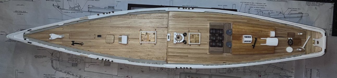

This build log is focused on more stuff on the deck, starting with what I should do directly in front of the main cabin. The plans have a note saying, “Sheathing over decking for stowage of barrels and other cargo.”
And it seems like it is about 50/50 in build logs as to something being in this spot of not, but there is no consistency on what should be here. But there are a couple of decent pictures of had actual Bluenose that show some barrels and cabinets.
So I made some barrels.
I know they are not perfect, but I like them. I then made two drums.
And then the stand for the barrels.
And attached the barrels and drums.
A quick placement of everything on the deck that I have created thus far gives me a quick And placed everything on the deck to see how it looks.
The mooring chocks at the stern look a little naked on the inside of the bulwarks as they are just the Britannia metal pieces sticking through from the outside, so I dressed them up by adding a small board.
And then painted and installed the main boom sheet.
And added more things to the stern of the deck.

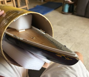

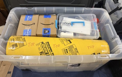

Quick update, even though I don't have any work to talk about. My wife and I have decided to move full time to Puerto Vallarta, Mexico, and are shooting to lreave on 2/27. Given that date and the state my Bluenose is currently in, I've made the difficult decision to NOT work on it. Yes, I've been home over a month and haven't touched her and won't as I feel she in in a good state to pack her up and transport her.
My thought is to pack her in a thick cardboard tube, one of those used for pouring concrete footings. I hope she fits in my carry-on bag, but if not, I'll figure it out. Gotta go, so much to do in the next month.
Good luck with your move to Mexico Hugo. I wish you and your family a safe move……..and your Bluenose. Cheers Grant
No Bluenose work to report, but after approximately 2 months and 2,000 miles, our packages arrived here in Puerto Vallarta. And the Bluenose survived the trip with NO damages!
