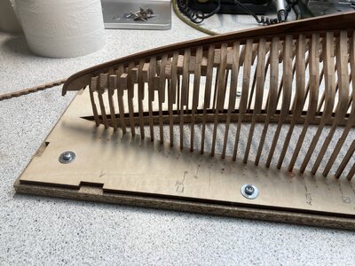

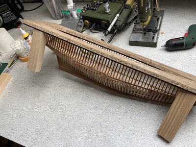

All frames and the keelson realigned and glued into the keel
Checked the keelson after every frame
Made distance blocks with my Proxon cutting saw
Maybe seem a bit exaggerated, but filed the keelson as tight as possible and I wanted to prevent the keelson from fitting less well later
All frames complete, no frames broken
All frames are now at right angles
So now I'm going to pick up my Sub again
You know how it goes, no peace in your head, if something is not right
Glad you used the spacer blocks between frames, I did the same to ensure they were square to the keel and parallel to each other.
She’s looking good!
Looks good! Nice solid build, Henk.
Thanks Peter,
Glad this phase went well, just watched it again and I'm satisfied with it
Looking very good, your work is paying off!
Thanks, spent quite a bit of time on it
and you know only the result counts
She’s looking good!
Thanks Dean,
I remembered this from your previous post, and I thought it was a good tip
This way you pick up something from everyone in this forum

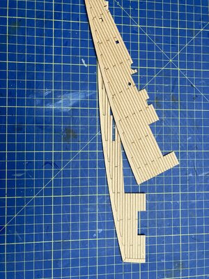

The last nails have been added
The mast feet are still dry fit and will be definitively attached when the deck upper deck is ready
For the upper decks I was able to get the right size and color slats in my hometown which I will plan later
(Add some cover seams in the photos I see :) )
