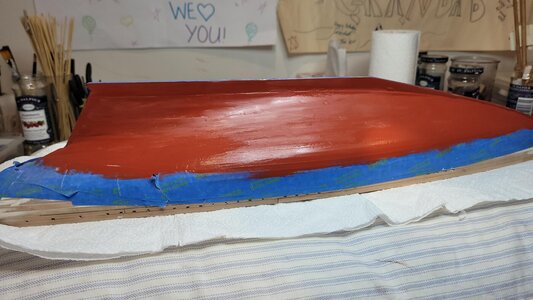

Painting today...going for the actual original colour scheme not because of any strong historical bias but I really like the colours. Red Ochre, Black, White and a white strip around the waterline.
Looks quite rich red here whereas in the flesh it is much more Ochre..must be a trick of the camera or light..? Gradually fill and fair and paint, maybe 2-3 coats then airbrush finishing thinned coats.
Oh very nice Robert, very nice indeed. A classic colour scheme isnt it. Yours looks great...better lift my game. Just tell me myou used pinstripe tape...if you painted that straight white line I dont want to know.

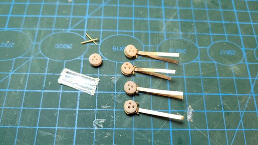

Caution...when fitting parts 147 which act as channels be careful to install them just sufficiently outboard so the chainplates can come through the 5 fine slots and run down the outside of the hull topsides. If you install the 147s too far inboard you wont be able to fit the chainplates correctly.
Actually the double thickness of the brass chainplates wont quite go through these tiny slots in the channels and I needed to very slightly ease the slots with a 0.5mm drill bit then the two thicknesses go through snugly. 4 done..only 16 to go. CA might work to hold the nails but putting a bend in the end of the nail and cutting it off compresses the strap around the deadeye better than CA would I think, and I wanted the deadeye to still be able to be rotated in the strap. Would quite like to have young eyes doing this.
Thanks Peter really appreciate your encouragement. I like the kit so much I am thinking seriously of building it a second time I would understand it so much better the second time. Need to persuade a son or daughter to buy me a second kit in exchange for the first build. A couple of shots of the installed chainplates and shroud deadeyes. Starting tom look like a Bluenose. A Bit fiddly getting the brasss chainplates through the two levels of bulwark rails but with the slots eased with a small drill it was OK in the end. Typical of what I mean is that the chainplates cross over a couple of the edges of scuppers and I am sure that is wrong.... more perfect alignment of everything at the start would have avoided that, buit I wont tell anyone if you dont.
