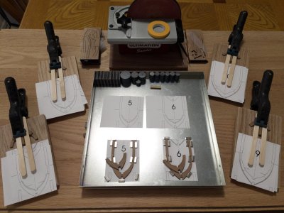

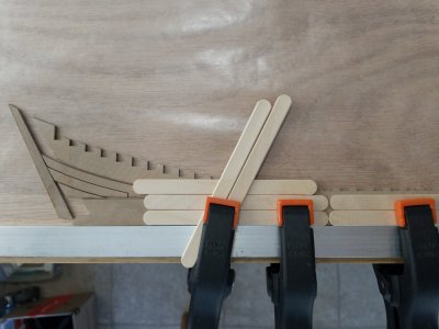

Assembly line: Both jigs are quite useful and the magnets are doing their jobs. One step at a time, glue two pieces > it creates a step > check with plan, > glue two others, etc. Slow but steady... not in a rush. I started to square the edge ever so slightly. 1/2 a turn of the wheel with grit 400.IMG_3449.jpeg

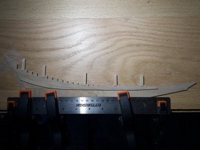

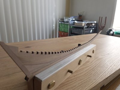

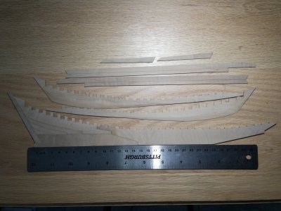

Keel Assembly: While working on the frames, I started on the keel. Dry fit each part and sand when needed. The parts are fitted with a straight back edge and glued one at a time. Use a sheet of wax paper underneath so it does not get glue on the table. Here is the partial assembly.

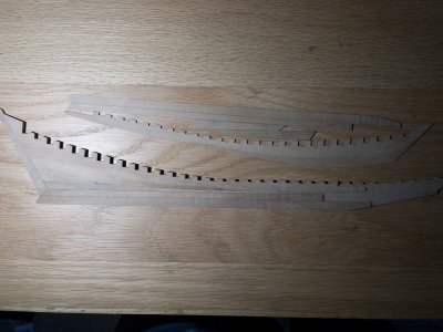

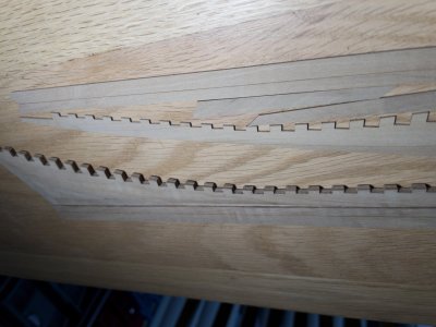

Keel assembly (part 2): <<A WORD OF CAUTION HERE >> I came across a small set back. Something I should have thought about but did not. I dry fit parts 10-15 thinking that the following with be then ok. Wrong... once dry, I tried to align part 18 and, of course it was off. The junction allows for a little bit of play. If not very careful the assembly at the far end could be ever so slightly off (upward by even couple mm), which will throw off the alignment down the road. I'm not happy with the work so far... so decided to go back to square one.
Luckily, the whole thing could be disassembled easily with hide glue. Hot steam vapor is enough to loosen the bound and separate the parts without any damage. The glue is them wipe off with a hot water rag and the parts back under press until fully dry. I will be going back to dry fit (including part 18-22) and deciding on another gluing strategy.
It’s good that you got the (little) misalignment in view at this early stage. And can start with the build again.
A few point from my experience during the build:
Be aware that the laser cuts gives a bit off square cutting lines.
I quickly became convinced to always think a few steps ahead. I used dry-fit components from subsequent steps to ensure the fit of the parts to be bonded. (As well as for any adjustments I had in mind.)
Perhaps use the same kind of fitting blocks as you use at the bottom parts of the frames and place 3 of them in a front, middle and aft notches by the keel assembling.
Greeting Peter, I "almost" had a premonition that hide glue would be quite useful with this build. However, it has limitation too and cannot replace forward thinking. I was indeed thinking about those small blocks as guide. Thanks again, for the comments... really useful.

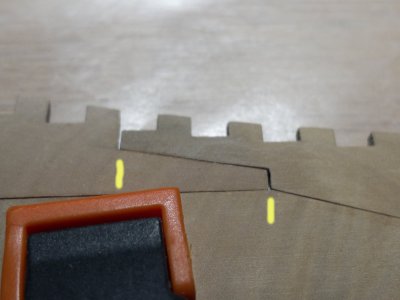

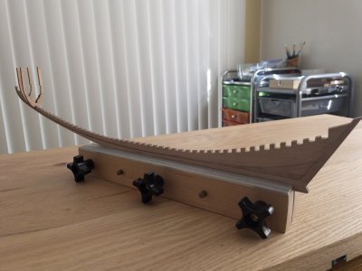

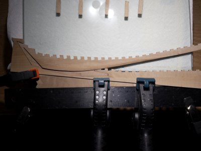

Keel (2nd attempt): With the experience above, I pulled part 18 to use as a guide. Dry fit shows that the misalignment was indeed from the assembly. Using the small tabs, I could align the parts perfectly. Once aligned and clamped I carefully removed part 8 to see underneath.
At first sight, everything seems fine... but something caught my eye. You can see in the last picture the issue to the problem earlier. Two 1mm gaps at the junction of two parts (highlighted in yellow). I will need to keep that spacing (retain the 2mm overall gap), otherwise the keel frame will be too short, and Part 8 won't align with the underlying body of the keel. Knowing that... on to gluing...

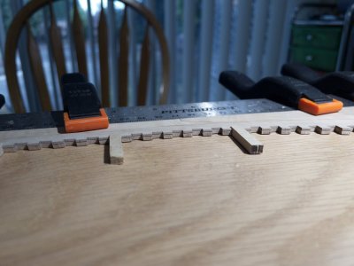

Keel Assembly (Part 18, 21): Part 18 were tapered down and ready to be set to the keel. It almost feels like laminating... so I used the same overall approach. The key is a thin layer of glue on both the part and the keel frame. To avoid making a mess and speed up assembly, I used the leftover from the laser cut board of each part pre-clamped to the frame as guides and finetune manually. In the end, very little clean-up and no glue beading out.... just a little touch-up sanding.

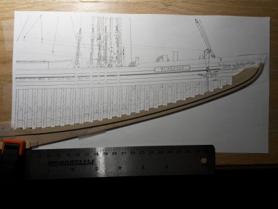

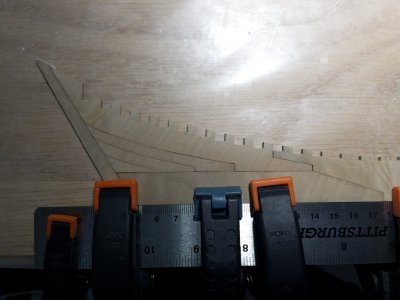

Keel extension: The second portion of the keel is dry-fitted carefully, working at the two joints to align those little "teeth". I use the plan as a guide. Just take your time, Loracs... no rush!
