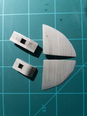

Building Water Wells: One modification that Peter introduced was to build water wells. I'm including the steps I used... but be warned, they are a pain to build... at least for me. In the end I got a set ready for later.
NOTE: I just realized I did not leave enough clearance at the top! Well, I got the idea/practice on how to build them. Will give it another shot. Sometimes, you don't get things quite right the first time. The process will be the same though.
Recommendation for building small copper parts (like above). Copper is nice and malleable but quite fragile to folding. Getting just the right thickness is tricky too. My suggestion for the future. Rather than trying to work with copper only, get some copper fold with adhesive (some are up to 4 inches wide). Then you can "coat" a transparent plastic sheet on both sides, even lay 2-3 layers. You will then have a copper sheet with very sturdy backing. The small piece can be cut easily and even fold back and forth without losing its integrity. I only had 1/4-inch tape on hand, but it tested quite nicely. Food for thoughts: full copper look (even with aging) but with solid backing.

Quick update: I reworked the water wells for better fitting. I like them as large as possible (personal preference) but they cannot be an obstruction. Plastic backing is indeed the easiest approach. Here's the third set being folded. This must be the longest thread on water-wells in the history of SOS..... hehe!

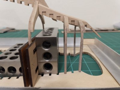

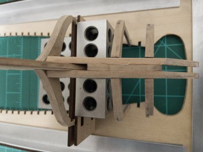

Dry Fitting Frames: Let me focus on what I'm looking for with this initial dry fit.
On the stand: That's an easy one. I made sure the frames slide in well and that there are no major mis-alignments.
On the keel: Again, does it slide in without force, position relative to the rabbet on either side, and finally does it sit square (90 degrees) without force on the keel. Both the keel and the frames are made from multiple pieces... so an issue can arise that can be fixed with very light sanding (either or both the keel or the frame). Some frames are a little loose but that is hard to fix and should go away on gluing.

That’s looking good, Loracs. The fitted nice to the bevel in the keelson. Be assured that the tops of all frames are on line, as fitted full in the jig. Because those aligned tops are the reference for the rest of all the inside beams.

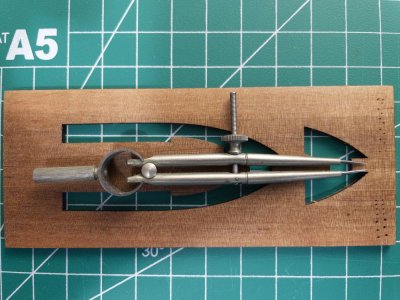

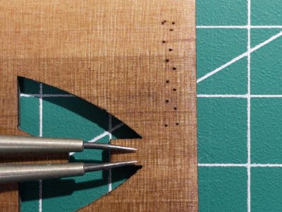

Nails: This build has a lot of firsts for me. Simulating nails is not something I have done before. Nails on 3mm wide planks will be quite tiny, 0.1-0.2mm, not something we can easily do the traditional way (drilling/filling). So, as pointed out before (I think by Peter), why not just some needle holes.
I'm using a quality compass, something I picked up at a flea market, for accurate and reproducible spacing of two needles. Just poke the board and finish with linseed oil/wax. Overall, they are not bad for tiny ones. Large ones will obviously be out of scale and would need filling (not doing those).IMG_3661.jpegIMG_3659.jpeg

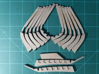

Keel extension: I have been spending more time removing chars from various plates... still not fun. I further the keel extension and ribs - fairing and adding bolts. Lastly, worked on the the solid area at the bow. This will help stabilize the first frame when I start assembly/gluing to the keel. This was a little trickier than expected but turned out well.

Keel extension (for lack of a better word): The extension was glued to the keel. As with Peter, I glued the middle parts right away for increased stability, just a matter of alignment. Speaking of alignment: This is the trickiest part so far. If the angle is off by less than a degree... the back frames won't fit nicely. Luckily, the kit tolerance on that part is high. If you align carefully with the keel, you will be ok. Still prudent to dry fit, just in case, before the glue cures (see dry fit below).
