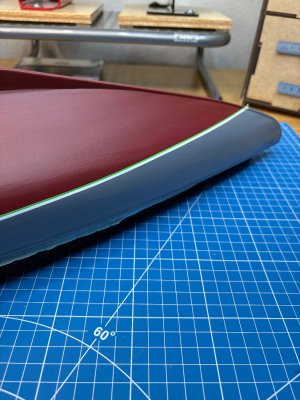

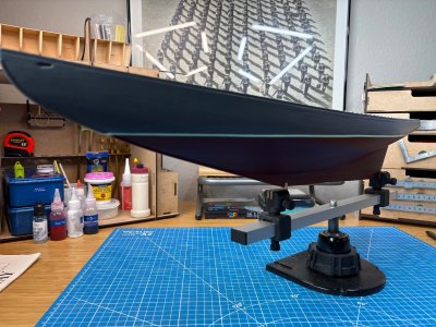

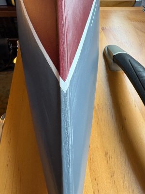

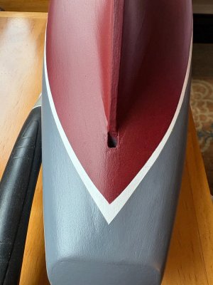

A few days later, I sprayed the lower hull and with overall good results. More detail soon on my method but the stripe as shown is still (intentionally) wide and will be narrowed to the 1mm final width when I spray the upper blue/black.

Thanks, Peter. I suspect that area had a little bit of oily residue from handling or I didn't buff it enough before spraying. Happy to recover from most of the little bumps along the way.

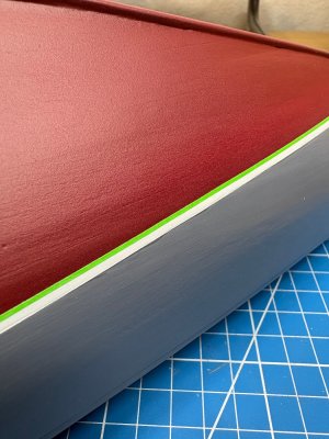

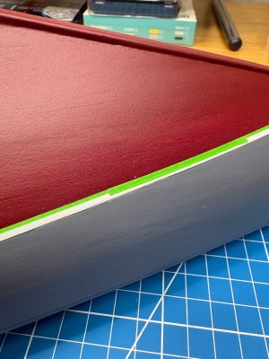

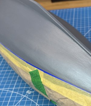

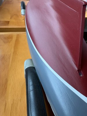

This is all new to me but I've found a number of ways to attack stripes and get clean color transitions, including of course pin stripe tape as a few have noted. I was originally planning to lay out the final 1mm stripe in the middle of the wider stripe (to avoid any gaps created by masking up to/on edges) but I was very impressed by the nice edge produced by the 3M vinyl tape.
So, I decided to use the bottom (keel) side of the wide stripe as the datum for the final pin stripe. That edge is also my approximate waterline, determined earlier by my laser level exercise. Placing my 1/8" tape at the edge of the stripe was fairly easy as the contrast of the blue tape and white paint helped. Had I been using the same tape over blue paint, this might have been a little more difficult. You can see the blue tape under my masking.
