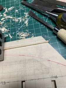

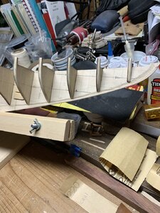

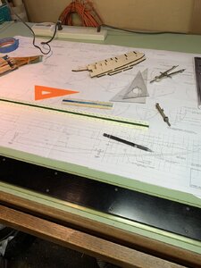

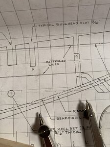

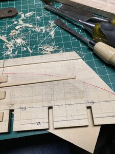

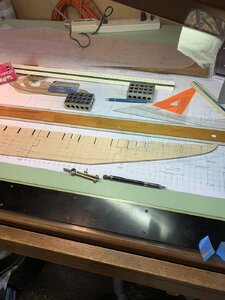

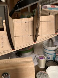

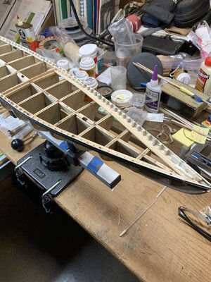

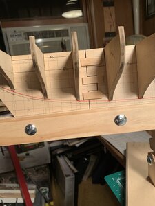

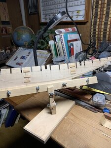

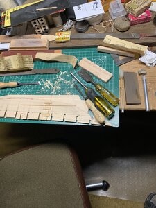

After some delays in putting up better lighting over my work area in the den I began slowly cutting out the starboard aft bearding to rabbit lines for the aft third part of the keel using an assortment of chisels, files, sandpaper with blocks, and sharpening stone and other sharpening touch-up items to keep the carving easier.

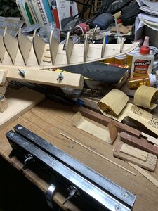

Stbd Aft Bearding 9.11 A.jpgStbd Aft Bearding Wale  9.11 B.jpgStbd Aft Bearding Check 9.11 A.jpgStbd Aft Beardikng Wale End  Check 9.11 B.jpgStbd Aft Bearding Check Higher Wale End 9.11 C.jpg

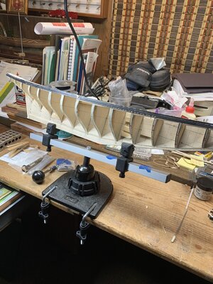

Sunday progress as much for my records and lookbacks as posting the progress which only approximates the accuracy and care of the experienced and well equipped shipwrights in SoS. Cut the rabbits and bearding lines as shown. Then plowed them out with a variety of chisels and a good old Exacto blade. Dryfitting the bulkheads and beginning of outboard fairing with checks using a 12 inch 1/16 inch thick batten. They go from the keel station to a vise for filing to form and back again over and over., Once I get these fore and aft I'll go back and trim off the bulkheads as stancheons angled the same as on the outboard face. Once everything is in order I'll begin the process of verifying for a last time the square and plumb of the bulkheads before setting them with TIghtbond to dry overnight. One major lesson learned from the first canoe build (my first with stripping/planking) is to dryfit and get to size before any gluing! This will be my mantra for the whole build. Thank you Gilles.

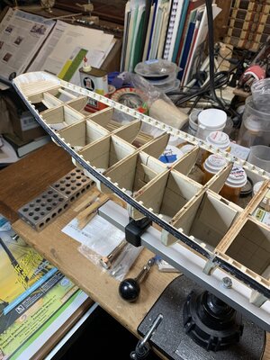

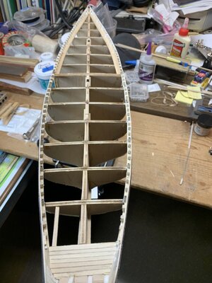

Well on the eve of my birthday it is past time to at least put up a few photos of the MS2130 Bluenose SLOWWWWW progress (delayed by my doing a new carriage and firing the small muzzle loading cannon).
Poor iPhone shots in an equally bad lighting and background of the long hull which after some paint touchup and scuttle holes reworking will begin planking which has been marked out. I'll go hull first and then the deck. I'll sand the cabin and hatches to the deck curve and glue them down.
Inboard bulwarks and stanchions to be touched up along with the waterways before setting the main railing which has been cut and dry fitted in five pieces per side.

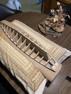

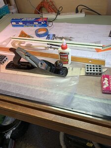

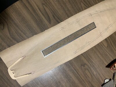

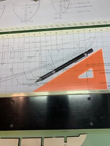

Here are a few of my procedure making a tracing of the outer inverted hull to draw the main railing and dividing it into manageable sections to cut and fit before securing them in place after the repainting and touch up are done beneath that rail. Then I may do the deck planking before hull for access from beneath as may be needed.Tracing the hull.jpg

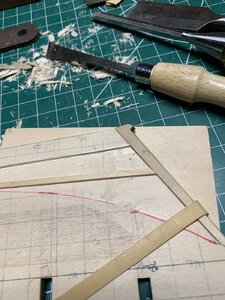

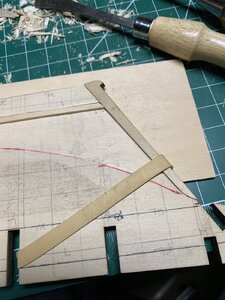

Next to draw the rail and separate sections to cut from the stock material providedHull Main Rail Parts drawn patterns.jpg

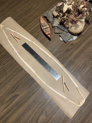

Then the rough cut sections laid out again for the pic after dry setting them on the stancheonsMain Rail parts rough cut.jpg
When placed on the stanchions for some unknown reason the forward most did not quite match with the laser cut bow rail (Y shape) but as those were too long I an cut and file them back to fit with the bow piece as needed for the hull itself. Those two will be the last ones set as I will work aft to fore. Some patching filler (sawdust and glue) will likely be needed for some small cracks between the complex joining ends when rotated into final alignment athwartships. The top will be painted out white anyway so that may be one of those covered issue. Rich (PT-2)
Here are a few of my procedure making a tracing of the outer inverted hull to draw the main railing and dividing it into manageable sections to cut and fit before securing them in place after the repainting and touch up are done beneath that rail. Then I may do the deck planking before hull for access from beneath as may be needed.View attachment 194379
Next to draw the rail and separate sections to cut from the stock material providedView attachment 194380
Then the rough cut sections laid out again for the pic after dry setting them on the stancheonsView attachment 194381
Good job Rich, as you know these kits never fit perfectly and there is always adjustments necessary. The only error, would be to assume it will go together perfectly without adjusting! ;)
