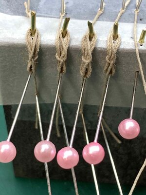

First i a line coils factory... the flora craft foam was used as a foundation because of its sharp edges, and well, spongy structure, not hard to push all those small pins... The baking paper was used to prevent glue from sticking on the foam. To create a line coil diameter as close to the original pins diameter, i cut a 2mm wire into 1cm long "pins" and push into the foam.. The distance from the edge was measured from the pin location on the ship and hanging part was also measured to provide a nice look at the end...
And started to run lines around it...
A drop of white glue was put in each line coil to keep the shape and they were left to dry overnight..
End the results were OK..
A drop of diluted white glue was also applied on the final product..

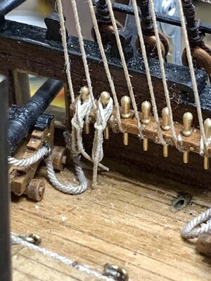

I have tried a slightly different approach now... wanted to try starting the work from the pin, first tightening the rope around the pin and work towards the yards.. this will give me a bit more workspace and it might ended up better and more realistic.. So lets see...
The rope was ran thru...
.. the knot was tight around the pin...
.. a bit of a CA was dropped to make sure the knot will stay in place.. Then the coil was attached, again with a help of a CA...
The rope looks a bit fuzzy on zoomed picture but it was dragged thru a beeswax and from the naked eye it does look OK.
So far it does look more realistic this way.. and easier to install... Then, the rope was running thru a block and attached to the sprit-sail yard..
Hmm, it does not look that bad after all... Will try few more times..
