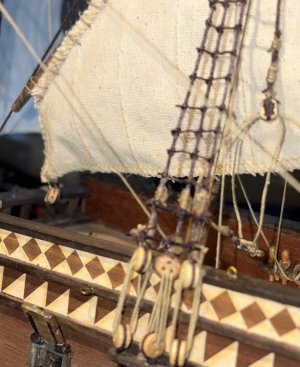

The futtock shrouds are supposed to connect the lower deadeyes to the staves and catharpins but on my kit, the deadeyes have already been connected to eyebolts attached to the top. To simulate the proper connection as best as possible, I tied a knot in a short piece of 0.5mm dark brown thread and feed it through the eyebolts using a needle threader, then routed the thread over the edge of the circular top, and down to the staves where it was tied off. Not perfect, but it looks nice.
I will have only one rat board (in addition to the sheer pole) at the bottom of each set of shrouds. They will be 3.7mm above the sheer poles. I will use 0.4mm x 0.4mm dark wood and tie them in place using 0.15mm dark brown thread.
Rat boards are used instead of rope ratlines because the shrouds spread widest near the deck, leaving too much unsupported space for a safe, comfortable foothold.

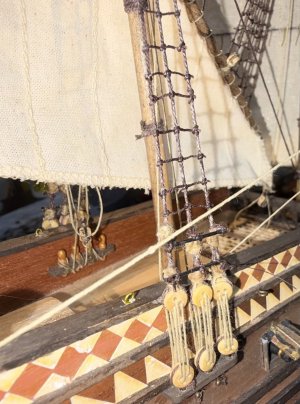

I am starting with the ratlines on the port side mizzenmast. It only has three shrouds per side. It will be a good first attempt.
I will be following a process a Rocky Mountain Shipwrights member detailed on Reddit a few months ago. He referenced a post on MSW, but it was posted by a “guest” several years ago, prior to MSW’s crash. I had unsuccessfully tried to reach out to the guest, so now I guess I will say it is from James Webster, and we've posted it on the club's YouTube channel.
The process starts with two pieces of stock that are longer than the widest set of shrouds, and whose width is that of the desired spacing of the ratlines. Thin strips of sandpaper (around 200 grit) are glued to the pieces of stock. The pieces are placed on either side of the shrouds and held in place with light clips. The idea is that the sandpaper holds the shrouds in place and the width of the stock gives you a straight line to run the ratlines at the desired spacing.
The ratlines spacing on my Molino is between 3.3mm and 3.8mm and with a bit of good luck the sanding sticks I have are 3.6mm… perfect width. I cut a 220-grit stick in half and held them in place directly above the rat board.
This is a task that takes me back to 2000 when I bought my first model (Model Shipways Bluenose). In those days, I thought rigging was so amazing, and I thought ratlines WERE the rigging. This step was huge for me.
I held the thread and shakily tied my first clove hitch, then my second, and then my third and final one. I had done it… my first ratline. I removed the two pieces of stock and admired my first ratline. Yes, it looked like my first one as neither looked particularly good. I almost immediately decided to remove it and start over.
I put the pieces of stock back in place and tried again. My second attempt looked a lot better and I kept it. I then moved the pieces of stock up to sit on top of the first row and tied my second one. My speed and quality improved until about two hours later, the tying of the port side mizzenmast ratlines were done.
I diluted some white glue with water and used a paint brush to apply it to each of the 54 knots.
Once the glue was dried, I trimmed the tails. My first ratlines were complete.
One area I can improve on is that of holding the thread in place while tying the first knot of the ratline. I struggled with it and ended us using a light clip to hold the thread in place to the pieces of stock. It worked well and I removed it as soon as the first knot was tied, but I should be able to do it without the clip.

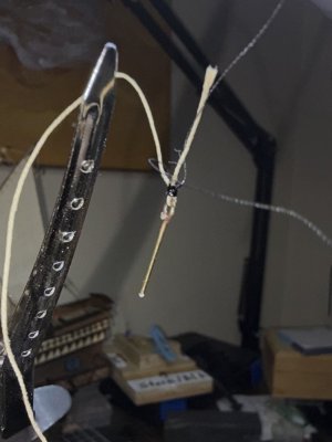

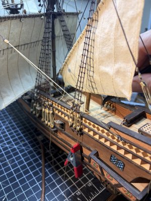

After this first stay and blocks, I decided to try something new. While I was back in Colorado, Ralph B showed me how to tie a figure eight strop using:
  • A vise holding a small clip
  • A very thin wire
  • A fly-tying bobbin (with thread)
  • A small loop of fishing line
The remaining tails of the figure-eight strop will be trimmed later, but the strop is complete.
A block can be added to one of the loops by putting a block into the loop and tighten up the loop. An empty loop can be inserted over a yard and tightened as well.
The foremast topmast stay is next and gets two of the pre-made stropped double blocks installed on it.
A single block is tied to the end of the stay, leaving it about two inches short of reaching the bowsprit. The stay does not attach directly to the bowsprit, but rather through a series of four single blocks called a fore-topmast stay tackle or fore-topmast stay purchase.
The line that runs through the stay tackle gets tied off to the forecastle deck railing. At first, I thought that tying this off to the rail was another item in the “beginner kit” inventory, but on this age of ship (a 17th century Spanish galleon), tying things to the railing was common.
Once the stay is tightened, move the double blocks to the appropriate position and tighten up the strop and place a drop of white glue on the stay and on the seize.

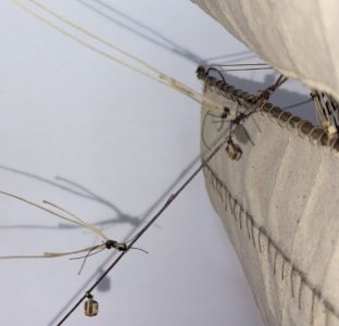

The backstays of the foremast and mainmast (two for each mast) are connected from the top of the topmast to deadeyes on either side of the ship.
The four lower deadeyes are already in place as they were installed when the other deadeyes were installed onto the chain plates.
I reeved these deadeyes in much the same manner as I had previously done with a couple of differences.
  • Instead of folding the tan seizing line in half, wrapping the tails around the shroud and tail, and then feeding the tails through the bight made when I folded the line in half (and doing this multiple times), I secured the tan seizing thread as close to the deadeye as possible with two half hitches. I then placed the looped fishing line (from making the figure-eight strops) over/parallel to the stay and tail and wrapped the line around the stay/tail and loop a few times. Then, much like the strops, I fed the seizing tail through the loop and gently pulled the loop down. A simple half hitch locked the seize.
  • This method gave me a lot smaller and tighter (I.E. better looking) seizes.
I created a second seize following the same process starting about 1/4” above the top of the first seize.
I do this for the back stays on the fore mast and the mainmast.

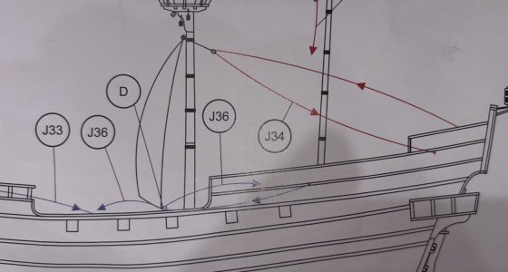

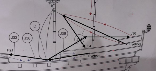

The back stays for the mizzenmast are supposed to go from the mizzenmast lower mast top to nails on either side of the ship, slightly behind the chainplates for the mizzenmast shrouds, J18 in the picture.
It just did not feel right to just run the back stays of the mizzenmast to a nail, so I used one of my remaining timeouts to do some research.
Next up, the back stays for the mizzenmast.

For a ship of this period (17th century Spanish galleon), the back stays for a mizzenmast with a lateen sail should be running back stays (also called flying or breast back stays), and to be period correct, they would be called burdas volantes (or simply burdas.)
The Molino should have burdas, but even with a fairly extensive online research, I have not found any good examples with pictures of what these would look like on a 17th century Spanish galleon, at least not of the lower connections near the deck.
Before I go further, a quick description of a flying backstay. Running backstays are temporary, adjustable backstays designed to support the mast against the forward pull of the sails. Unlike permanent standing backstays, they can be unhooked and swung out of the way to prevent the large boom or yards (or the Molino’s lateen sail) from running into them against them.
The only pictures I have found were for running backstays on either the foremast or mainmast. None for a mizzenmast.
I am sure I could find some diagrams in any number of books, but being in Mexico, my physical resources are reduced. Like many others, I write a lot of my build log after-the-fact. And as I was writing this portion, I thought of two more places for me to check.
The first place is that the Mexican Naval Museums is about a 10-minute walk from my condo and it has ton of scale models. And even easier, I took pictures of all of them - at least all of them - when I was there about 2 years ago.
A quick search through my pictures shows me that there are at least a few models that may have running backstays, but either the picture quality does not let me zoom in to see the details I am looking for, or the transom of the ship is just out of view. Looks like a trip to the museum is warranted.
I recently heard that the museum holds a special event on the last Saturday night of the month where there’s food and live music. Going this month will move up on my priority list, but it is about two weeks away.
The second place is the local public library. I know of one that is about 15 minutes away on a city bus. And like libraries in the states, anyone can come in and look. I have been wanting to investigate the library anyway, so this is another reason for me to finally go.
And then while do more research online, I was pointed towards the Suburban Ship Modeler and his build of Bluenose. I am familiar with the site, as my other build is the Bluenose, but given I have not begun its rigging, I had not gotten that far in the Suburban Ship Modeler’s build. The Bluenose does not have a mizzenmast, but it has flying backstays. They are on the mainmast, and not on a lateen sail, but it is the closest thing to what I really want to see.
I will run with modifying the Bluenose’s running backstays and put the museum and library on hold.
My thought is to replace the two backstays (J18) that are included in the kit to burdas. I am assuming the burdas would be somewhere near the blue line, and would have a couple of blocks, tackle, and hooks right near the transom on both sides.
I will need to seize a double block onto the ends of the burdas, approximately 3/4 of the distance from the connection point at the mizzenmast’s top to the rear corners of the deck near the transom.
This double block will essentially split the burdas into a “Y,” with one leg of the “Y” going to a single block (with a ring seized to the downward side of the block) and the other leg going to an eyebolt that will be mounted on the cap rail, about an inch in front of the transom (this is the adjustable portion of the burdas). I will leave this line extra-long until I mount the sails as the direction of the wind and sails will determine which burdas will be taunt and which will be left slack. At that point I will determine how much of this extra line is needed to slack the line and make sure I have that much extra on the taunt side as well. The extra will be coiled up and hung or left on the deck.
The ring of the single block will be connected to a seized eyebolt/ring (using an “S” hook) to a connection point on the deck right up against the transom.
Here is what I need to make (all using the seized figure-eight strop that my friend Ralph taught me how to make):
  • 2 - single blocks with a ring seized to one end
  • 2 - double blocks
  • 2 - 1 1/4” line with an eyebolt on one end and an “S” hook on the other end.

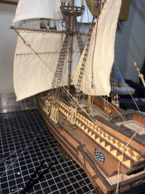

I have decided to have my sails fully bellowed at starboard brace (wind coming from the starboard).
Each yard and sail may have its own unique differences (like the spritsail should have water-holes or that the fore and main sails will have reef points), but once each yard and sail has been attached, I will be mixing in the running rigging list in the instructions.
Yowers, that is a lot of stuff that I have never done before, with my first attempt being the spritsail - not the biggest sail BUT the one sail that is up front and center… potentially the first sail to be looked at. A bit intimidating.
After taking a little time thinking about what I am undertaking, I decided to do the foremast topsail first, giving me a little practice before I go after the spritsail.
The yard is pinned.
The sails are temporarily held in place.
I decided to use Olha Batchvarov’s historical half-hitch spiral loops. They do not take much more time and look a lot better.
On a piece of wax paper, I use a big soft brush to drench the sail in a 50/50 mix of white glue and water.
Put the wet sail “square” on the container, face up (this will put the hole for the pin “down” against the container; and hold the wet sail in place using your thumbs and middle fingers and use your index fingers to gently push/pull the center (top to bottom) of the yard towards the left (port).
Pinch the lower corners gently to give them a look like they are under stress (from the rigging).
Gently remove the sail from the wrapped container.
I really like the way it turned out and am excited about how the Molino will look.
When attaching the sail to the yard, I noticed that a couple of the blocks that I attached several months ago were attached in the wrong place. No idea how I did that, but I did. It was an easy fix, but required a fix nevertheless. I also removed the line near the center of the yard that was going to be used to hold the yard to the mast. Since I’m adding parrels, it will no longer be needed. That line will be removed from all of the yards.
At this point my practice is done. I still have to glue the pin in place, attach the yard to the mast, make, and install the parrel (and begin it is running rigging), but I will now go back to my planned sail order - the spritsail.

And then I did something new… reef band and reef points. There are several methods to make these, but I am going with a simple one; draw the band and then glue and snip. There is only one line of reef points on a 17th century Spanish galleon. To create the reef band, I measure down 1/3rd of the height of the sail (122mm) and draw a light line with a pencil on both sides of the sail.
The reef points are made with the same 0.1mm tan thread I have been using to lash the sail to the yards. They should be between 6mm and 9mm in length and spaced 6mm apart from each other.
After about 30 minutes, I trim the reef points at about 7mm, leaving a very nice-looking row of 25 of them. For some reason, I didn't take a picture... Once fully dry, I repeat the process on the other side of the sail.
I soak the back side of the sail with 50/50 mix and then using my paintbrush, I pull the reef points slightly to the port side which when the yard is hung would indicate wind coming from the starboard side - simulating my starboard brace.
The sail goes onto the circular container with the frontside facing up. I give it a coat of the 50/50 mixture and again use the brush to pull the reef points slightly towards the port.
I use my fingers to hold the sail corners in place and push/pull the middle of the sail to the left. I then pinch the lower corners and set it aside to dry for 24 hours.

This block of 13 hours marked the completion of the lower yards on both the foremast and the mainmast for El Molino. It turned out to be a period of troubleshooting, material optimization, and auditing old rigging choices I made months ago.
Here is the condensed breakdown:
The Foremast Lower Yard & Custom Parrels
This yard introduced me to my first double-row parrel ladder—a system using alternating rows of vertical wooden ribs and rolling trucks. The ribs were built using leftover walnut veneer planking and the trucks were made using locally sourced beads.
The Veneer Shield: To stop my 0.2mm x 5mm planking veneer from splitting, I coated both sides in white glue and let it dry before drilling two 0.7mm holes. I then ran a needle file through the interiors to smooth out any thread-snagging burrs.
The Parrel Setup: I cut the veneer into 3.5mm x 5.0mm micro-ribs, chamfered the corners at 45 degrees, and strung them into a tight R-BB-R-BB-R-BB-R-BB-R-BB-R sequence using 6 ribs (R) and 10 nested beads (B).
Making the ribs:
  1. Coat both sides of the 0.2mm x 5mm veneer with white glue and let it dry.
  2. This will strengthen the veneer and reduce splitting.
  3. Sand
  4. Drill two 0.7mm holes along the 5mm side.
  5. Lightly sand the holes with a thin pencil file.
  6. Sand the entire board.
  7. Lightly sand the holes again with a thin pencil file.
  8. Cut the veneer in a hobby miter box saw making each piece about 3.5mm x 5mm.
  9. Cut two of the corners off using a hobby knife.
  10. Sand.
The Mount: The yard pin was seated, lines pulled taut, and the parrel threads were routed back over the yard to tie off with a square knot and a drop of CA behind the mast. The halyard was roved down to the fife rail post.
Proactive Rigging Discoveries
I realized that trying to feed a needle threader between a mounted block and its tight rope strop after the yard is mounted is incredibly frustrating. The blocks to this point had been installed at various points in my build, probably going back to October 2025.
The "El Molino" Fix: I established a new workflow: For existing blocks that have already been installed/mounted, instead of waiting until the yard has been mounted (and in the way), I will now add the running rigging line before the yard is attached. This little step makes it a lot easier to thread the needle threader between the block and its strop.
To test the theory, I pre-strung the foremast topsail lines under the cross trees while the space was wide open. It was infinitely easier.
Future Upgrade: On all future builds, I will be moving entirely to figure-8 strops for blocks instead of tying simple loops around the block. It looks cleaner and allows the blocks to rotate freely when routing lines. When building the figure-8 strops, I will also add the rigging line between the block and the strop. After I finished this section, I found out that the connection point of the rigging line to the block is at a “becket,” or at least I believe that is what it is called. Ralph B from the Rocky Mountain Shipwrights showed me a pretty slick way of using a figure eight strop along with a bead to simulate the becket. It is probably too late for El Molino, but I’ll including them in future builds as well.
The Main Lower Yard
As the biggest sail on the ship, this was prepped flat on the bench: laced with Olga Batchvarov’s half-hitch loops, marked with a single 2B pencil reef band, and 7mm long reef points at a 6mm spacing. These were anchored to the front and back of the sail with white glue.
The Circular Mold: The sail was drenched with a 50/50 PVA/water mix that was “painted” on. The reef points were pulled to the port and the sail was swept to port on my circular container. The container was barely big enough for this main sheet - a good reminder that I will need larger forms if/when I work on larger models!
Making the Billow:
  1. Drill a 0.6mm hole in the yard for the pin.
  2. Temporarily attached the sheet to the yard.
  3. Lashed the sail to the yard with Olha Batchvarov’s historical half-hitch spiral loops.
  4. Used a pencil to draw in the reef band (again only one).
  5. Using white glue, glue lines of at least 7mm at 6mm spacing along the reef band.
  6. Once the glue has dried, trim the lines at 7mm, creating the reef points.
  7. Cover the back side of the sail with a 50/50 white glue and water mixture.
  8. Pull the reef points so they are angled towards the port side with a paintbrush.
  9. Position the sheet front face up on the covered circular container.
  10. Cover the front side with the 50/50 mixture.
  11. Pull the reef points so they are angled towards the port side.
  12. Hold the sheet square to the container using your thumbs and middle fingers but push/pull the center towards the port side using your index fingers.
  13. Pinch the lower corners of the sheet.
  14. Let dry for 24 hours.
After a 24-hour cure, the yard was pinned into its 20-degree Starboard Brace hole, clamped with its 2-row parrel, and the halyard was belayed down to the fife rail.
The Great Double-Block Audit (The "Argh!" Moments)
While preparing the main braces, I realized I had accidentally installed double blocks at the yard arms instead of singles. Looking over at the foremast to compare... I found I had done it there too! Argh!
The Correction: I pulled all four off and swapped them out for single blocks wrapped in clean figure-8 strops. This had a great secondary benefit: it recovered 4 much-needed double blocks for my spare parts inventory (solving why I had run out of them earlier!).
This required me to un-belay the foremast lower braces, but it was a choice I can live with.
The Second Discovery: While re-reeving the main braces, I found another set of mistaken double blocks sitting underneath the circular top on the mast. I had done all of these wrong block back in November! At this point I made the decision to grab a beer and head to the pool. The next day I swapped them out the while waiting for my Spanish class to start.
Current Status: All block corrections are complete. The halyards and all braces are successfully roved and tied off to the fife rail pins.
Another re-christening
The ship is the OcCre’s Buccaneer, which I re-christened the Molino ages ago. The kit is not based on a specific ship, but rather a generic pirate ship. Given it is not a real ship, I feel free to make any changes I desire to the ship (unlike my other model the Bluenose which I will only make changes if they are true to the actual ship).
The latest change comes courtesy of Gemini. During one of my discussions with Gemini, the ship, which is a 17th century Spanish galleon, was called by Gemini “El Molino.” I liked the Spanish feeling and the name change stuck.

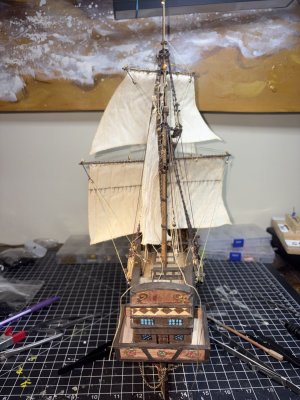

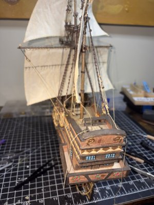

In this session, I advanced El Molino’s upper rig by installing both topsails, replacing simplified crosstree blocks with more realistic custom assemblies, and completing the associated halyards and braces in an 11-hour session.
  • Session Start: September 9, 2026
  • Session End: September 13, 2026
  • Session Time: 11 Hours
  • Total Build Time: 395.5 Hours
One additional AI change. I did everything as I did previously, but the fed the build log into Copilot and looked at its recommendations.
Main Topsail Canvas Prep: Stitched the premade canvas to its yard using Olha Batchvarov’s half-hitch spiral loops at 6mm spacing. The yard was pre-drilled for its mounting pin, and the back side of the canvas was drenched with a brush-applied 50/50 white glue and water mixture. The assembly was positioned front-face up on a covered circular container mold. The front face was then coated with the mixture. To match the port-side sweep of the wind, the center of the canvas was pushed and pulled toward the port side while the lower corners were pinched to mimic wind tension before curing for 24 hours.
Crosstree Block Modification:
Rigging-diagram review showed that the kit’s crosstree double blocks were a beginner-friendly simplification: one sheave served the braces and the other the buntlines. To improve realism and keep the two systems visually distinct, I replaced all four double blocks with custom dual-single-block assemblies, a refinement that may be subtle to most builders but materially improves the rigging detail.
Single-Double Block Production: Eight individual single blocks were prepped by sanding, filing corner grooves, drilling out holes, and staining. Using 5-inch lengths of tan line, four custom figure-eight loop strops were created. Single blocks were nestled into the loops on each side. Four separate mounting loops were formed using tan line with contrasting black seizing. These seized loops were slid over the blocks and tightened securely around the central waist of the figure-eights. The assemblies were locked with CA glue and the tails were trimmed.
Stepping & Integrated Rigging:
The four completed double-single blocks were lashed securely to the eyebolts under the mast crosstrees where the kit had specified double blocks. These were then locked with CA glue. Moving away from a piece-by-piece assembly, the yards were attached in more of a simultaneous mounting sequence:
  • The first end of the parrel line was fed from the back of the sail under the yard to the front face.
  • The halyard blocks were roved using a needle threader, leaving plenty of extra slack line.
  • While tightening the halyard line, the parrel necklace was wrapped around the back of the mast, and the remaining end of the parrel was fed under the yard to the front face.
  • Both parrel ends were pulled over the top of the yard and fed back to the rear of the mast.
  • While tightening the halyard line even more, the yard mounting pin was aligned and seated directly into the mast timber.
  • The parrel lines were tensioned and secured with a square knot.
  • Final tension was pulled through the halyard block tackle.
Parrel Fabrication: The double-row parrel necklaces were scaled down to account for the narrower topmasts. Each necklace was configured with 4 sets of double beads (8 total) separated by 5 vertical ribs.
RUNNING RIGGING & FALLS
The Halyards: I’m still struggling during block reeving, as I repeatedly had the line exiting on the incorrect side of the sheaves, necessitating multiple re-reeves. Once properly oriented, the halyard lines were routed cleanly down through an opening in the flooring of the circular tops and belayed to the quarterdeck fife rail.
The Braces:
The installation of the braces proved exceptionally straightforward, a direct benefit of upgrading to the custom double-single block configuration. The lines were roved through the new blocks and belayed cleanly to the quarterdeck railing. Rather than utilizing simple knots, the four brace lines were anchored to their eyebolts above the crosstrees and dressed up with black thread seizes, locked with CA glue.
Fore Topsail Execution:
Following the successful installation of the main topsail, the entire sequence was repeated on the fore topsail. The pre-billowed canvas was brought to the foremast, its custom 8-bead parrel was laced, and both the halyard and braces were fully roved, tensioned, and belayed. All excess rigging tails across both masts were cleanly trimmed.
All upper sails are officially flying proud, fully balanced, and locked into the starboard-brace alignment.
The Braces:
Next up:
After a one-week break in Guadalajara and Ajijic, I’ll return to rig the topsail sheets to the lower yards, followed by the clewlines and buntlines across the upper canvas.

The brace lines are tan as they are running rigging and as I have done in the past, I seize them with black thread. Yes, tan would be more accurate, but I have been going with black, so they are more noticeable. Additionally, I make each seize a double seize.
I will continue making the seizes as I have done previously.
  • Loop the tan line around the stay.
  • Wrap a thin black line around the bight and tie a half-hitch.
  • Hold the black tail along with the tan tail (pointing away from the stay.)
  • Lay the fishing line tippet along the brace line.
  • Wrap the black line around the brace line and the tippet at least 4 times.
  • Fold the black tail across the loops (so it is now pointing towards the stay.)
  • Wrap the black line around the brace line, the black tail, and the tippet at least 4 times.
  • Feed the end of the black line through the loop of the tippet.
  • Pull the tippet away from the stay, pulling the black line under and through the seize wraps.
  • Gently pull both black tails in opposite directions, while straightening the tan line and tightening the seize.
  • Slide and tighten the seize into position.
  • The first seize should be tight up against the stay.
  • The second seize should be about 1/4" away from the first.
  • Trim the black tails to about 1/2".
All the tails will be trimmed and the seizes will be glued once they are all complete, but for now, they are all left in place.
After the four foremast braces are complete, I follow the same seizing process for the two (port and starboard) braces for the bowsprit/spritsail, again all attached to the stays. Two (port and starboard) of the mainmast braces are tied off at the top of the mizzenmast while the other two (port and starboard) are tied off to the side of the ship.
Shipwright's Note: Tying ten double seizes at this point of the build took roughly 6.5 hours. Working around existing shrouds, stays, and standing rigging turned simple knot-work into a delicate, painstaking exercise. Note for future builds: Always seize lines or attach blocks to stays before installing the stays on the model.
Reeving the Mainmast Braces & The OcCre Diagram Puzzle
My reeving strategy followed an aft-to-forward, bottom-to-top sequence. Lines were reeved through their respective blocks and left slack toward their belaying points so the double-seized loops could be oriented to point directly toward their blocks prior to final gluing and tail trimming.
I began on the mainmast lower yard braces and immediately hit a wall with OcCre's documentation.
  • Comparing OcCre's "Line Diagram" (diagram H) against their "Pin/Eyebolt Attachment Diagram" (diagram N) revealed a direct conflict:
  • Line Diagram H: Showed line J34 (main lower yard brace) starting at an eyebolt on the hull near the poop deck, running forward/up to the lower yard blocks, and returning all the way back to the poop deck.
Pin/Eyebolt Diagram (diagram N): Placed J34's belaying point on the fife rail near the base of the mizzenmast.
  • Cross-reference (J36 Main Sheet): The diagrams swapped logic again. J36 showed starting near the mizzen fife rail, running to the sail corner block, and belaying at the fife rail… yet I cross-checked with my AI copilots and queried OcCre directly. Before receiving a response from OcCre, I re-watched their official assembly video (MAST 52 - How to make the halyards and topping lifts BUCCANEER). While the video skips these lines, the finished rig is visible in the final 10 seconds of the clip:
  • The Verdict: The Pin/Eyebolt diagram (N) is correct; the Line diagram (H) is misleading.
It will be interesting to see how OcCre responds.
With that confusion behind me, I moved to the main topsail braces. I realized I had somehow missed replacing the double block at the crosstree when upgrading the rest of the mast blocks earlier in the build. I removed the double block, retrofitted a pair of single-blocks to simulate a double-single arrangement, reeved the lines through the topsail yard blocks, and led them down toward the mizzen fife rail.
To set equal tension on the yards without pulling the mast off-center, I used the Clamp and Cast-Off Method. This method mimics a 17th-century crew hauling on the ropes simultaneously.
  • Port Side (Weight/Hold): Pulled the port brace until the yard matched the starboard-braced layout angle, then attached a small spring clamp to the line beneath the fife rail. Releasing the line allowed gravity and the clamp to hold tension.
  • Starboard Side (Lock): Manually tensioned the starboard line against the port load until balanced. Secured the line to its fife rail pin using a figure-eight hitch (assisted by tweezers and a dental pick) and locked it with a drop of thin CA.
  • Port Side (Final Lock): Removed the spring clamp from the port line (now held in place by the locked starboard side) and executed the final belaying hitch and CA drop on the port pin.
The clamp acts as my "crew member" to hold one side of the rope, while I adjust the tension and then tie off the line.
This was repeated for the main top braces, completing all mainmast brace work.
Mizzenmast Modifications & Lateen Settee Tackle
Turning my attention to the mizzenmast, research into historical lateen setups for this hull revealed that El Molino carries a lateen settee sail (quadrilateral with a short front luff) rather than a pure triangular lateen.
Unlike a standard lateen spar anchored directly to the deck, a settee sail anchors the tack of the sail itself via a three-point bridle tackle between two deck eyebolts and a single block stropped to the forward foot of the sail.
I start by stropping a block with tan thread with extra-long tails (about 3" or 4") and then poke a hole in the front lower corner of the sail with a sewing needle. I thread one tail into a needle and thread it through the hole, and then do the same to the other tail, but from the other side. I tighten up the tails until the block is right below the sail. With the block in this location, I pull the tails straight down and then loop a thin black thread around the tails and the previous seize. I then tie two half hitches and lock the knot with a drop of CA glue.
Shipwright's Note: Tying sail-corner blocks after the canvas is already mounted to the yard is extremely awkward due to spatial constraints. Always attach sail blocks on the flat bench prior to mounting canvas to the yard.
I pull the two existing eyebolts out of the deck and feed a length of tan thread through one of them and seize it with thin black thread. I only seize it once as I know I will need to seize the other side, and a double will be exceedingly difficult given its location and everything around it.
The bridle tackle is reeved through the block on the lower front corner of the lateen-settee sail as both eyebolts are put back in place but not glued.
To wrap up this session, I drill a hole in the outer rail of the ship right behind each mizzenmast shrouds/ratlines and add DIY eyebolts. The starboard side eyebolt is for show while the port side eyebolt will be used to hold the flying backstay since the ship will be starboard braced.
The flying backstays and the bridle tackle will be left loose until the mizzenmast is angled and locked down.

I did get a reply from OcCre and they said I was correct there was an error and they sent me the “corrected” diagrams.
