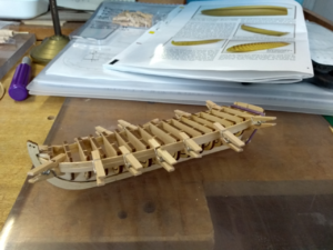

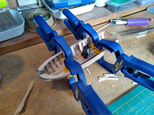

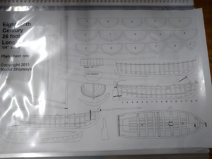

As promised on my HMS Medea scratch build log, here are the plans I will be working to for the longboat.

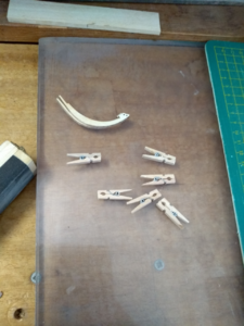

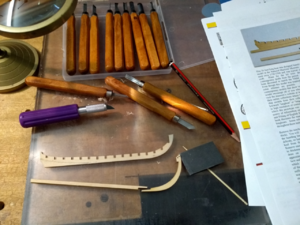

End of day one I've sorted out the pieces, cut out the keel, false keel and stem and shaved the edge of the false keel to simulate the rabbet. Tomorrow I will begin gluing.
What this has taught me already is that I need to go slowly and carefully. The basswood in the kit is so much more fragile than the Silver Ash I am using in my Medea build.

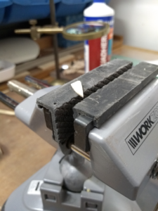

The tiny clothes pegs I bought a long time ago for clamping small pieces needed modification to sit flat so I have trimmed off their leading edge with my razor saw.
Day one done and not yet dusted.

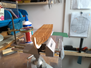

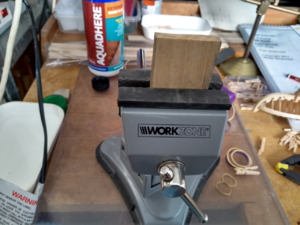

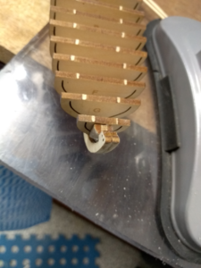

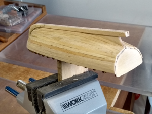

A little more progress. Have started the planking and will hopefully complete that tomorrow or so. My first attempt at planking and I find it challenging at this scale, but a great learning exercise to prepare me for the larger model Medea build.
I found a block of wood in the vise ideal to hold the inverted model while measuring an fitting planks.

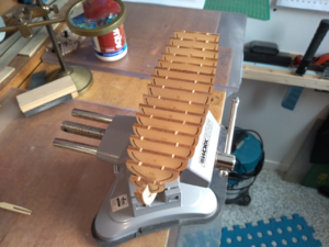

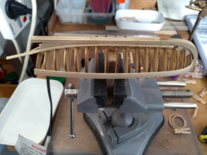

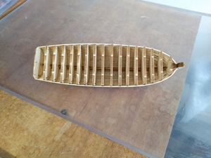

Planking (such as it is) complete.
The learning curve was good for me and I won't taper so many planks next time. The main thing I learned was that I should have beveled the edges of the planks. Of course the plans explained that but I somehow missed it and it caused gaps which had to be filled with thin strips.
Now to cut out the bulkheads.

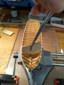

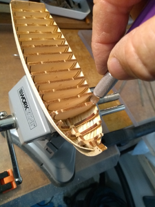

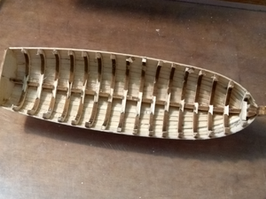

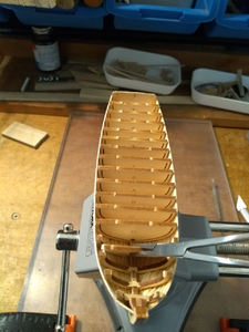

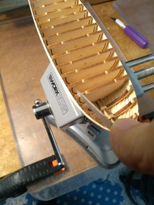

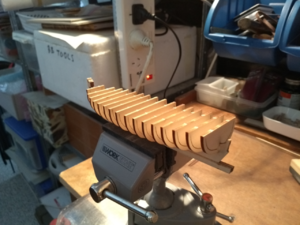

As there has been some discussion lately about how to remove the laser cut bulkheads, here's how I went about it.
First I used a fine file to cut down as far as comfortable.
Then I finished the cut with a sharp blade.
Using surgical pliers the waste was prised out.
Due more to clumsiness than the method, I managed to damage the tops of a couple of frames but nothing that can't be fixed.
Now there will be a lot of sanding to prepare for the next step.IMG_20200521_162056400.png

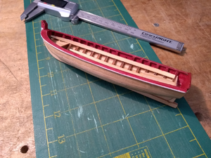

Quite a bit to update since my last post.

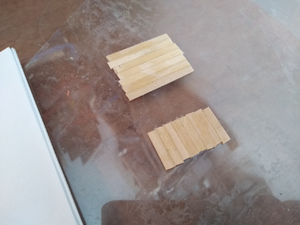

Gluing in the floor. Caprail already fitted. The little man is 5' 8'' tall on the scale 1:48.
1/32" thick planks glued on edge to form platforms. The sheet of acetate was brilliant for this.
Platforms fitted, front of locker fitted, caprail painted, staunchions fitted and all timber surfaces painted with 50/50 linseed oil and turpentine.
I decided not to fit the paper decorations supplied with the kit, or to paint below the waterline with white stuff. For my diorama this boat is supposed to represent a longboat repaired many times after damage by cannon fire and wear and tear during 3 years at war. I think it will look more like a working boat if it is painted with oil as it probably was in reality.
I used acrylic paint for the red and white but won't do that again. It is too hard to get it smooth and I will sand some of it back to re-do.

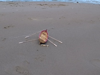

That's awesome!!! This pic says it all. The letter is a great touch. Are you going to take some sand and simulate water in a diorama? Nice work Ian, enjoyed this short build log. :)
Nov 6, 2019
163
133
Sunshine Coast Queensland Australia
Thanks Chris. I have a diorama in mind but keeping it under wraps for the moment. It will involve simulated water but not sand. The image above was taken on a sandbar just inside the mouth of the Noosa River, Queensland. I accessed it in my fishing kayak while on holiday recently.
