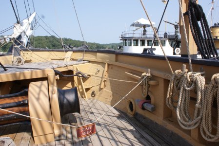

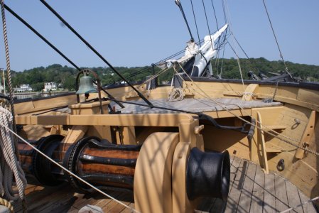

Hello Quint,
Thank you so much for the pictures. They will be very helpful for my construction. They show way more detail than the plans or other pictures I’ve seen.
Bill

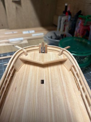

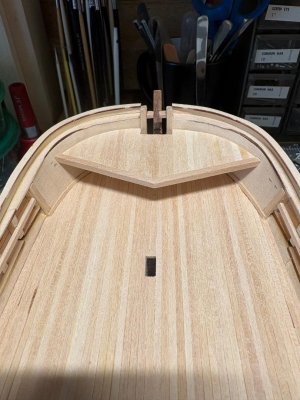

After looking at the picture of the bow I posted above, I realized that the knightheads were too short. I
Kudos for doing the extra work to get it right. Not an easy decision to tear out finished work after realizing it is not to your satisfaction.

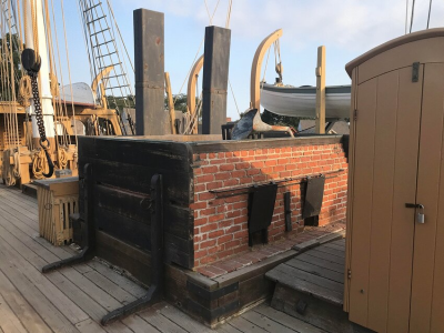

Allan: I don't think anyone will look close enough to see that the knightheads are wrong, but every time I would look my own work, to me, they would stick out like a sore thumb. Also, thanks for the pictures they help out a lot. The first picture shows the bow area with the anchor deck removed. It gives a good view of the breasthook and how the cathead is configured. The second picture shows a great view of the tryworks.

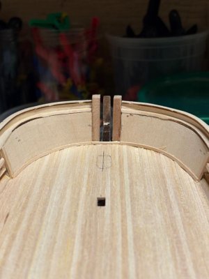

Hello everyone,
I've been working to get the catheads built and installed. Most of the catheads are hidden under the anchor deck, but I want them to be correct as possible. I still need to cut the first one to final length. The catheads were built from 4 separate pieces of wood. The color of the wood does not match well with each other, but they will be painted to match the hull.
Bill
